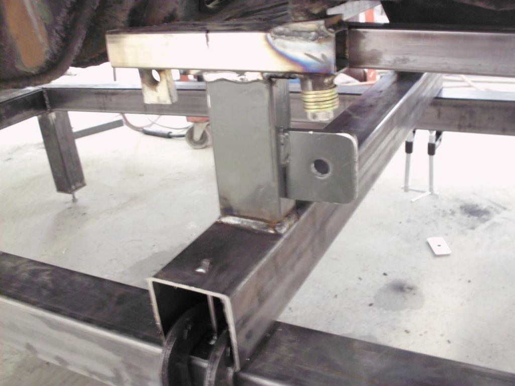

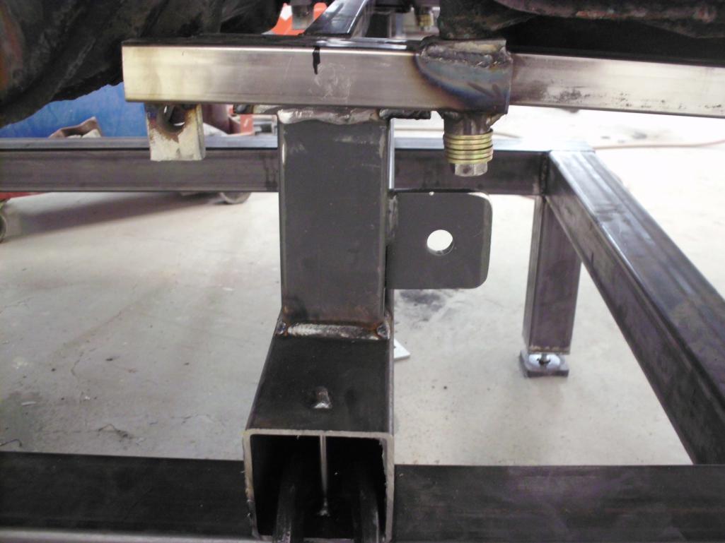

914350   Progress on the fixture.   Nov 28 2014, 10:29 PM
914350   More pics.   Nov 28 2014, 10:32 PM
914350   More pics.   Nov 28 2014, 10:36 PM
914350   This fixture will be removable from the table so t...   Nov 28 2014, 10:46 PM
914350   Rear mounting points.   Nov 30 2014, 08:04 AM
914350   More pics.   Nov 30 2014, 08:06 AM
914350   I intalled an alignment dowl to relocate the front...   Nov 30 2014, 08:12 AM

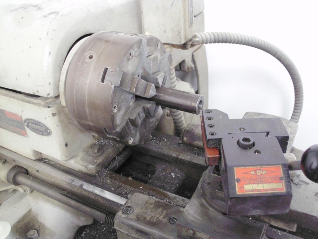

Socalandy   My Dad's Lathe hard at work :) getting clos...   Nov 30 2014, 02:21 PM

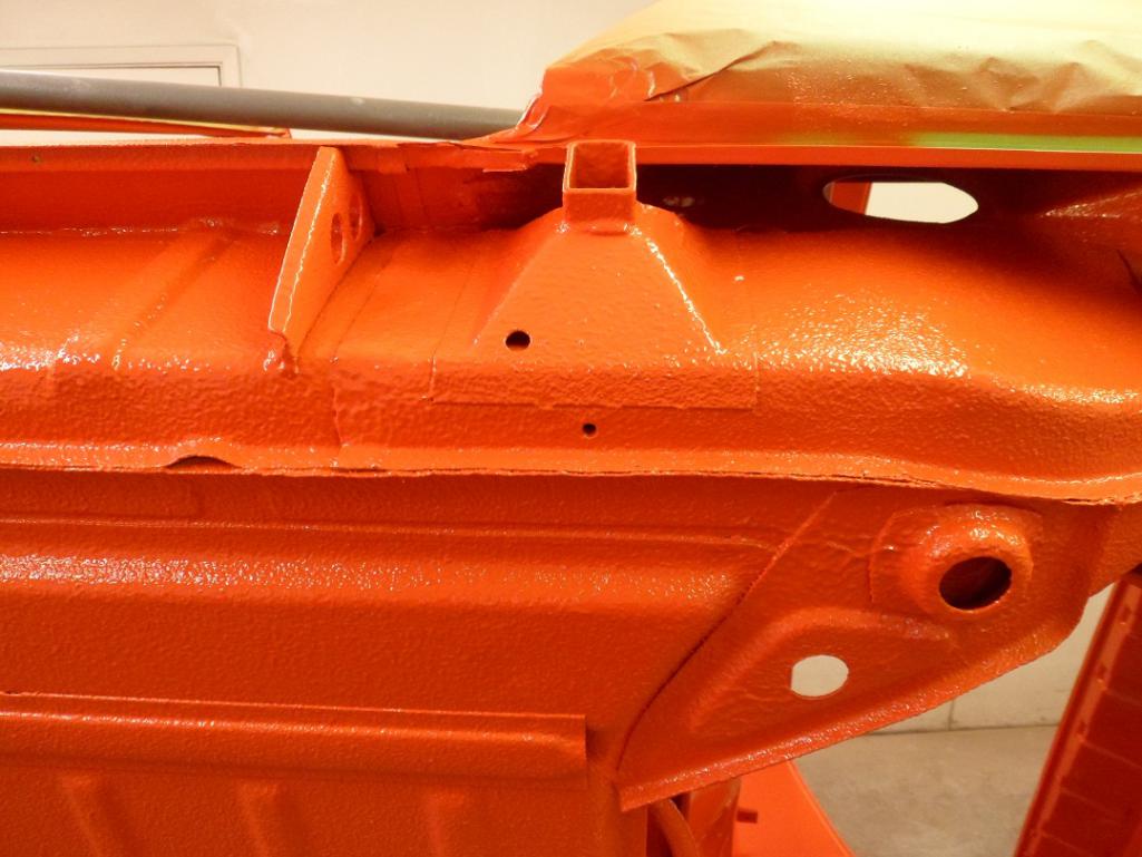

914350   Got the Donor car all cut up and off the fixture, ...   Jan 2 2015, 10:14 PM
914350   More.   Jan 2 2015, 10:15 PM
914350   More.   Jan 2 2015, 10:17 PM
914350   I used the rotissorie to lift the car onto the fix...   Jan 2 2015, 10:23 PM
914350   More.   Jan 2 2015, 10:25 PM
914350   more.   Jan 2 2015, 10:27 PM
914350   More.   Jan 2 2015, 10:27 PM
914350   As expected, the car is bent but no worries there ...   Jan 2 2015, 10:38 PM
