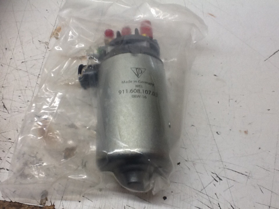

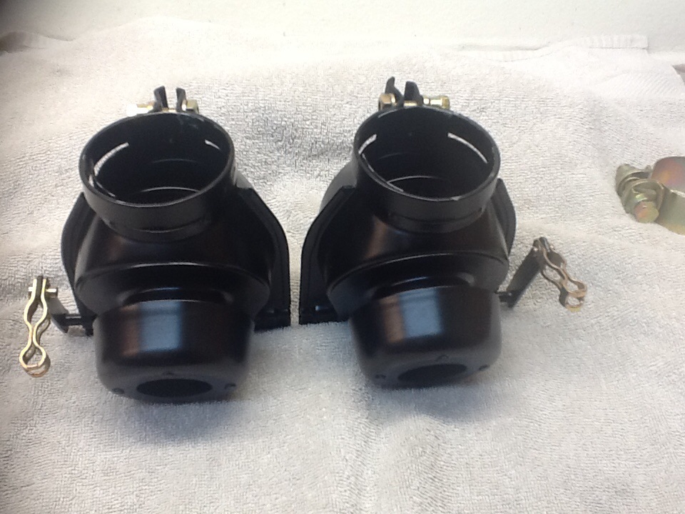

Started messing around with the flapper boxes today. It makes me feel like I'm making progress, and I am. I just get a little impatient. I tend to want things yesterday. It drives my wife crazy, but what does she know? I also just received my fuel pump. You know when it has a Porsche symbol on the box, you had better put your knee pads on, because you're going to be driven around the room. I thought about having my existing pumps rebuilt, but I figure you can't go wrong with new. By the way, if someone rebuilds them I have three. Jim.

Wow rare flapper boxes with correct holes !

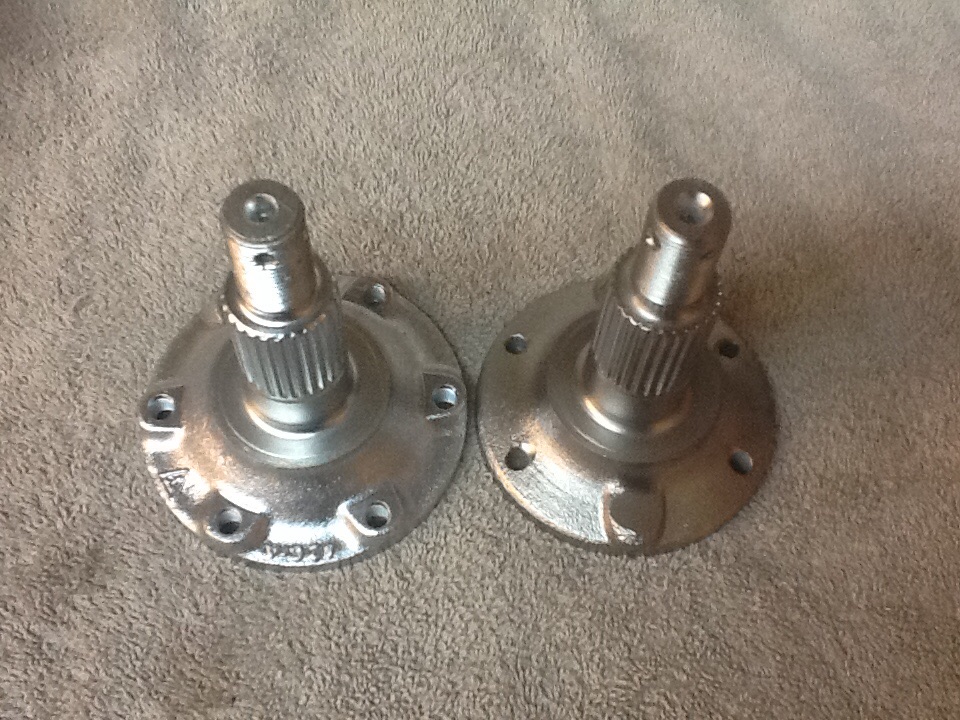

Here is today's installment of expensive lesson learned. On the left you will see a freshly plated 914/4 stub axle. On the right is a freshly plated 914/6 stub axle. If you are putting a six together, don't confuse the four stub axle with the six. The difference is virtually nothing in value for the four stubs and about 4 to 600 for the six stubs. Provided you can find a set. Notice the serial number on the four stub axle and none on the six stubs. The spline count is also different. I'm sure there are members here who would say that the difference is pretty evident, and it is now. But when I sold the freshly plated six stub axles for almost nothing I didn't know that. Another expensive lesson learned. Tune in regularly and I will point out other expensive lessons. Jim.

I mixed up my pictures. The one on the left is for a 911. I thought it would work on a six, but they are not interchangeable. The one on the right is definitely for a six. Carry on.

There are 911 stubs that fit. You just have to find the correct ones. 914-6 stubs have there own part number but there is a 911 stub that's identical with a 911 part number.

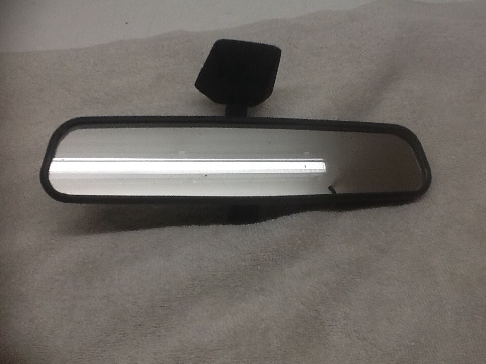

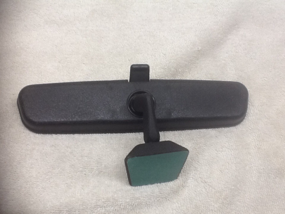

This is my latest post of overpriced NOS parts for a 914. This mirror is not specific to a 914/6 but it is correct for an early 914. Notice how narrow it is. It obviously will fit all years though. Another one of those parts that you have to re-finance your house to get. Or in my case, re-finance my trailer. As some of you can relate, as you progress through your restoration you reach a point that you don't care about the cost anymore you just want the car finished.

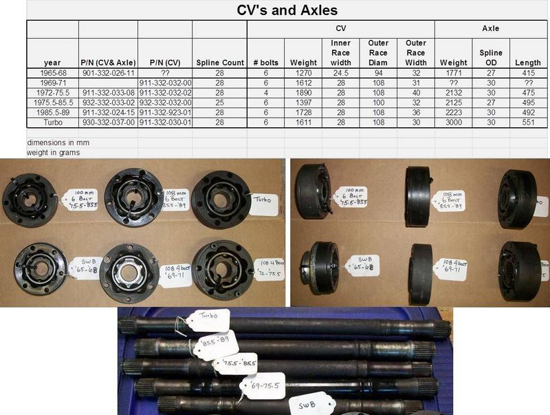

Jim sorry for the hijack and probably a dopy question. So out of that table which are the ones that would work with a six? I'm assuming the early stuff, but hey like Jim driveshafts and stubs have always been a bit of a mystery
post Jun 24 2017, 06:38 AM
Post #432
914-6 GT in waiting
Posts: 20,036
Joined: 19-September 09
Member No.: 10,825
QUOTE(SixerJ @ Jun 24 2017, 02:52 AM) *
QUOTE(mepstein @ Jun 22 2017, 05:16 PM) *
I think its the 69-71.
I think its the 69-71. Maybe 72-75 with longer bolts.
I have a stub chart somewhere but not finding it.
Eric Shea would know for sure.

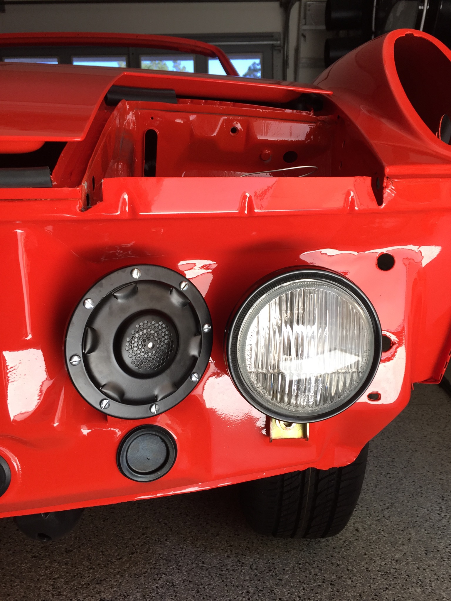

Here is a picture of the correct early horn and the correct TN/1 driving light lense. Thanks to Blue6. The horn is the same for a Volkswagen. Notice the slotted screws as opposed to the later riveted cover.
defianty
post Jun 29 2017, 01:57 AM
Post #440
Posts: 659
Joined: 9-August 06
From: Essex, UK
Member No.: 6,621
Looking fantastic. I think those rubber plugs are installed back to front.
