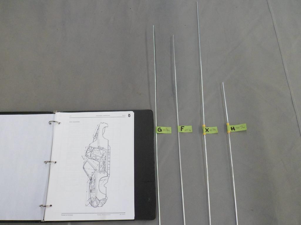

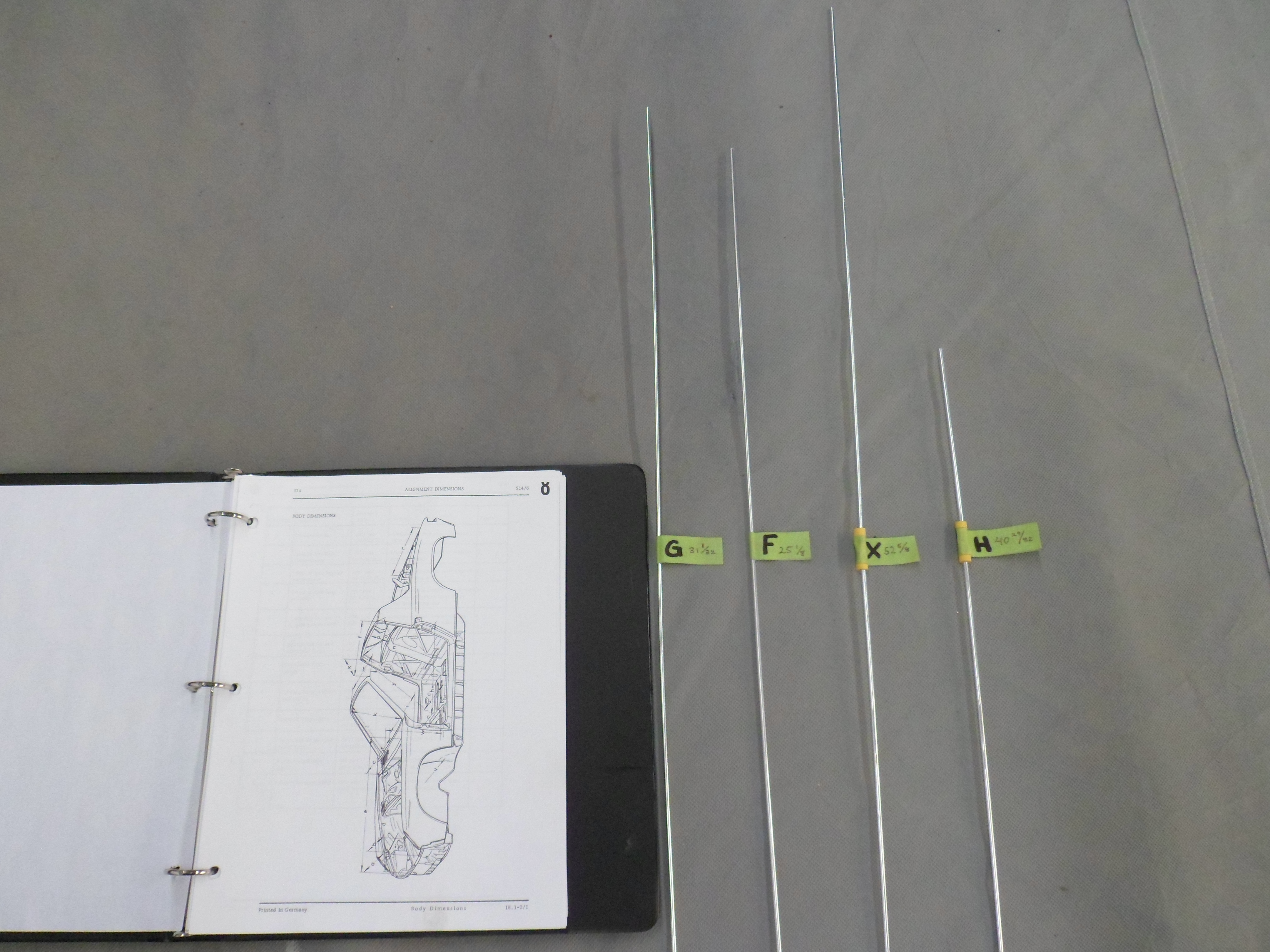

I cut and labled some aluminum welding rods to the exact lengths of measurment for the different openings on the car. this makes it easy to quickly measure as I work on the car.

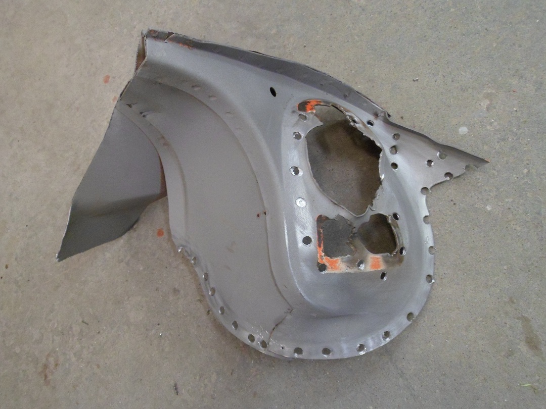

We had a good day cutting up the donor and getting the -6 on the fixture. It needs a lot more attention but its in the right place to be fixed.

you forgot this one, the last of the donor car on the fixture. (IMG:style_emoticons/default/sawzall-smiley.gif)

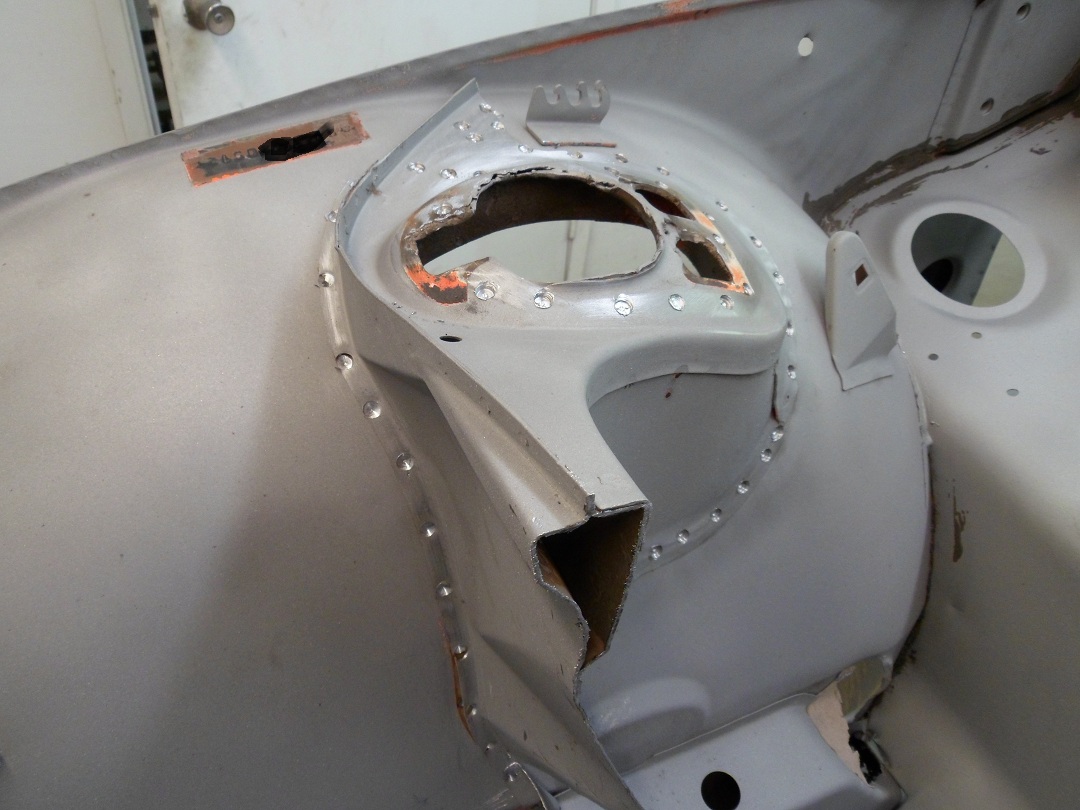

More work this week.
914350
post Jan 12 2015, 11:44 AM
Post #95
Posts: 548
Joined: 21-April 14
From: Torrance Ca.
Member No.: 17,275
Trimming edges.
914350
post Jan 12 2015, 11:48 AM
Post #96
Posts: 548
Joined: 21-April 14
From: Torrance Ca.
Member No.: 17,275
Jim, I promise I will stop cutting before there is no car left.
914350
post Jan 12 2015, 11:51 AM
Post #97
Posts: 548
Joined: 21-April 14
From: Torrance Ca.
Member No.: 17,275
Yikes!
914350
post Jan 12 2015, 12:01 PM
Post #98
Posts: 548
Joined: 21-April 14
From: Torrance Ca.
Member No.: 17,275
Andy and Jim located a NOS drivers side long.
