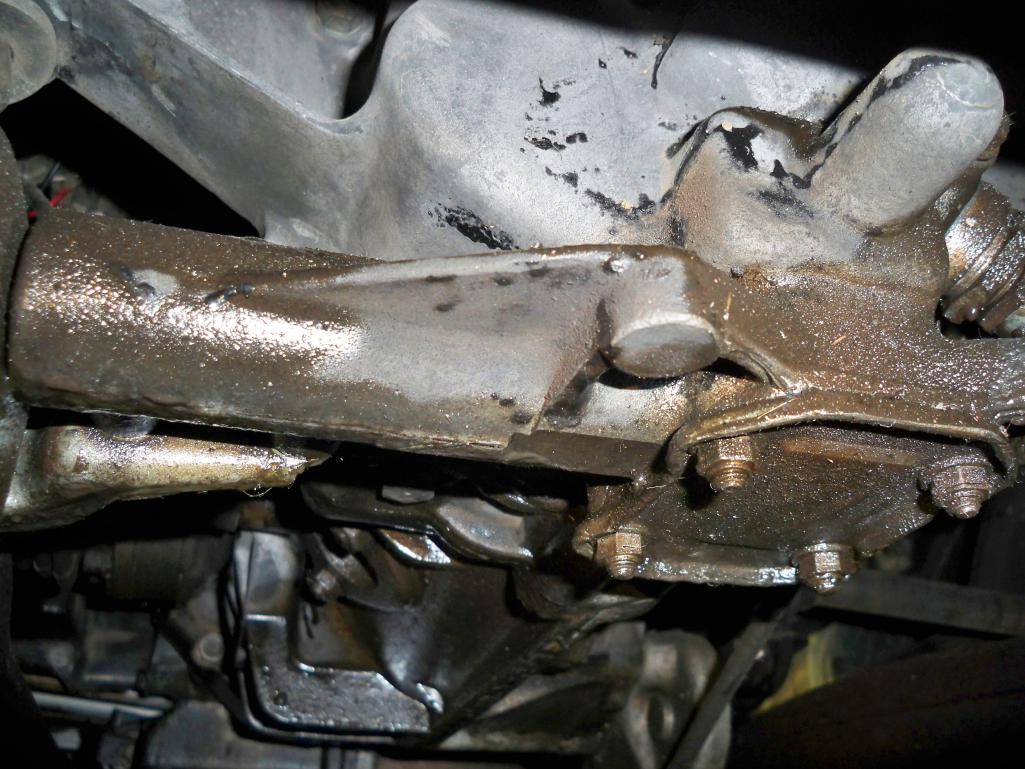

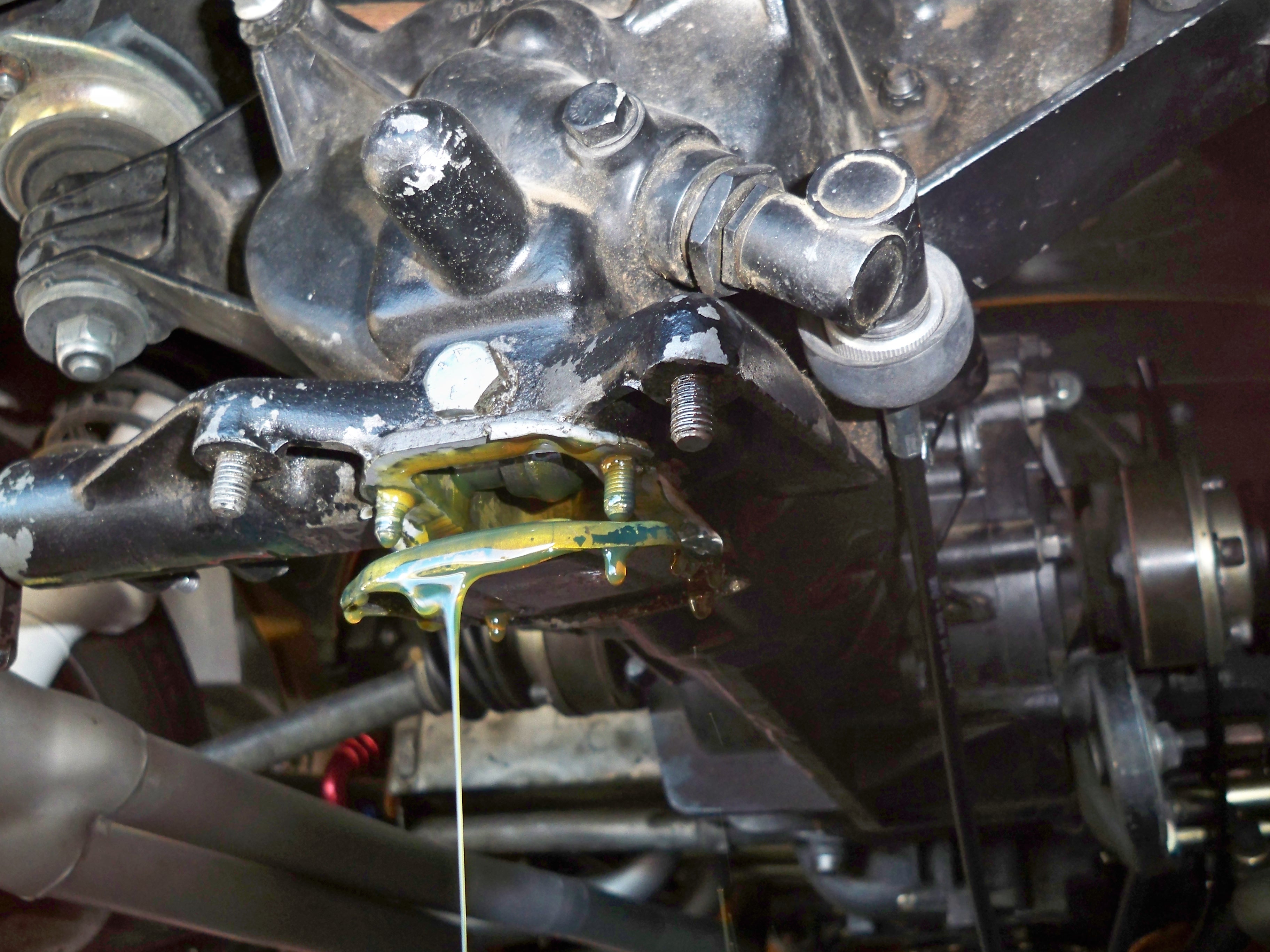

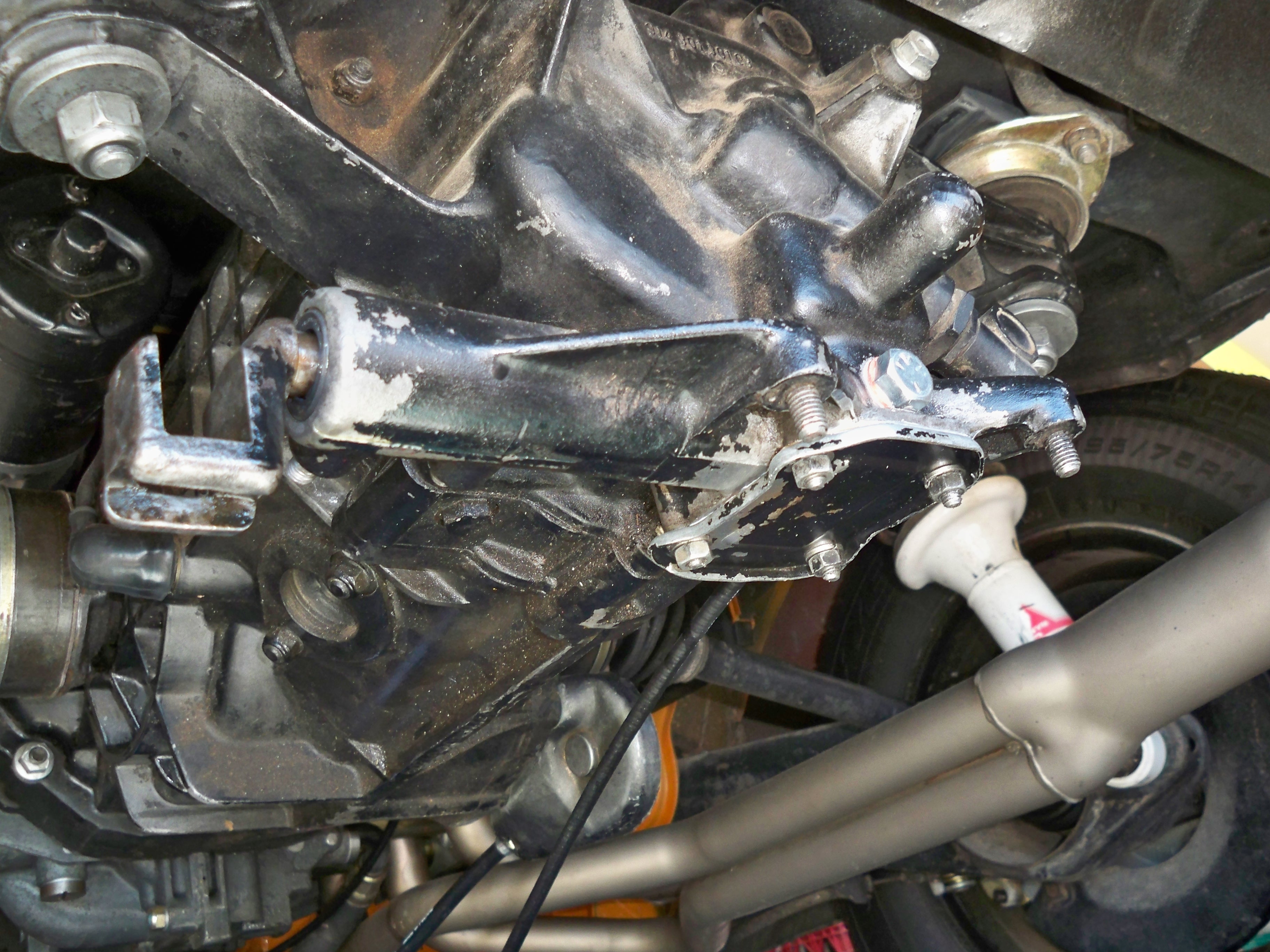

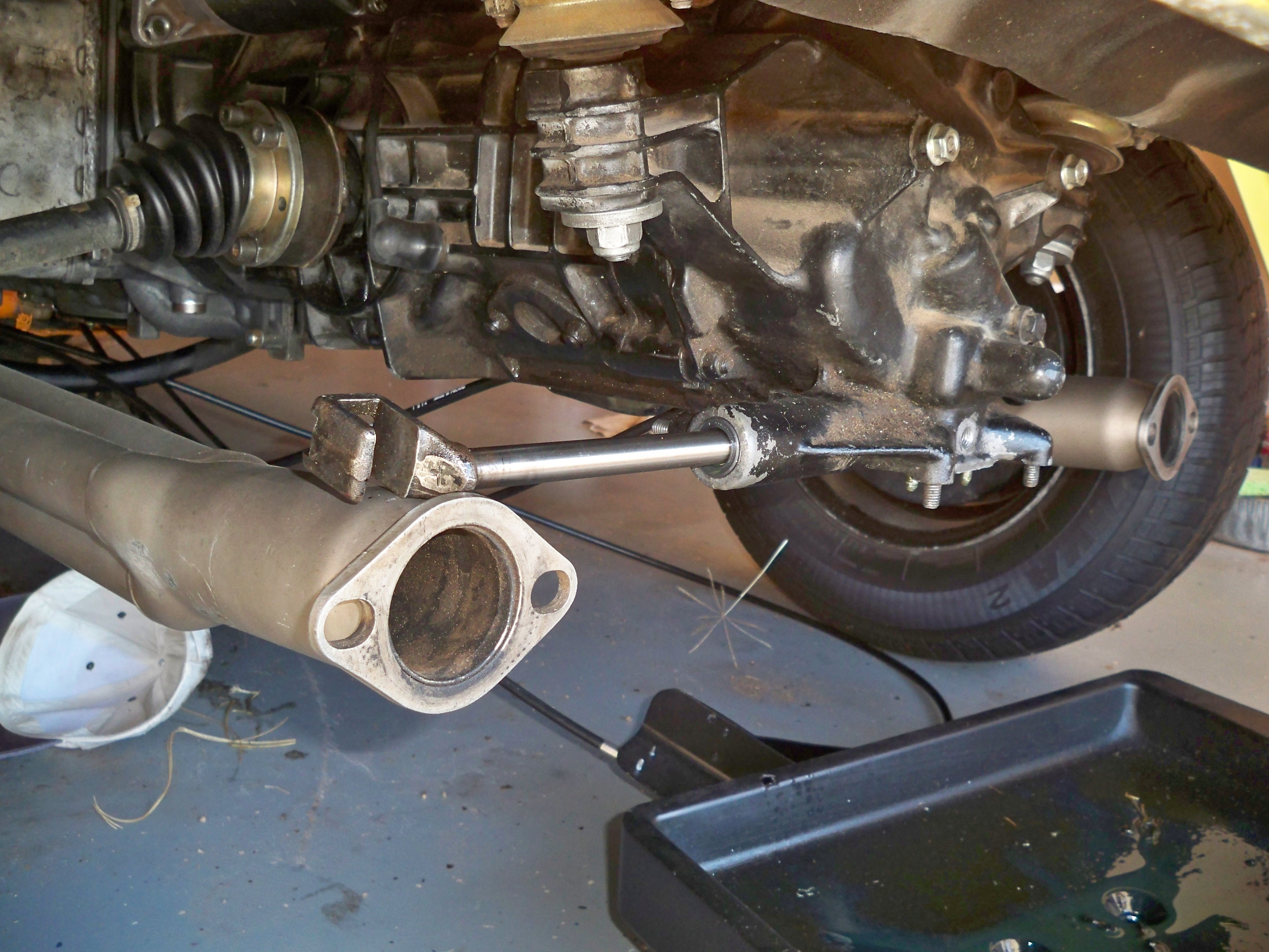

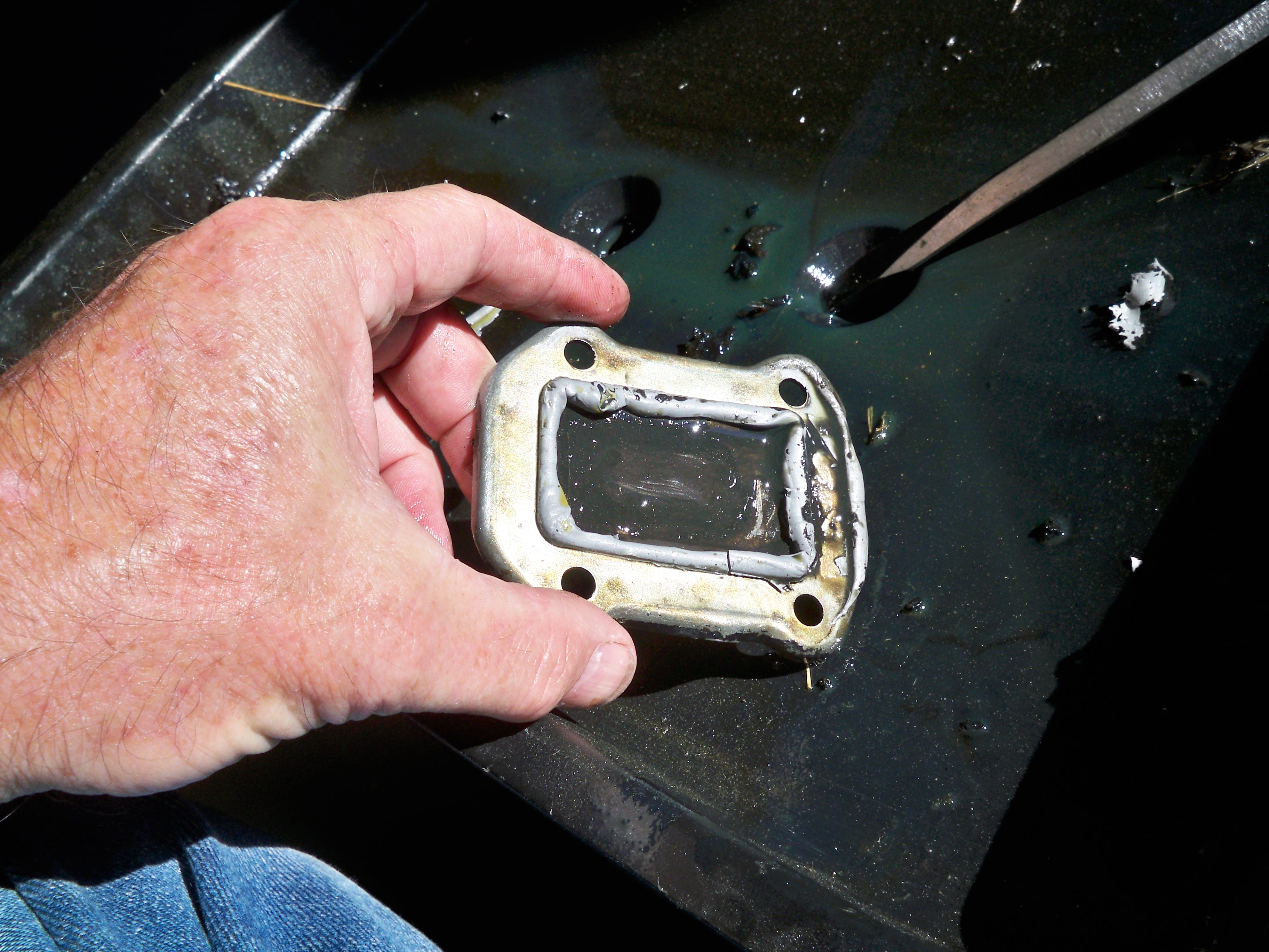

I bought this -6 conversion project on Ebay too many years ago. It finally got off jackstands and I filled the transmission with GL-5. The next morning I found a good sized puddle under the shift rod. It wasn't the first "au krappe" moment for this project.

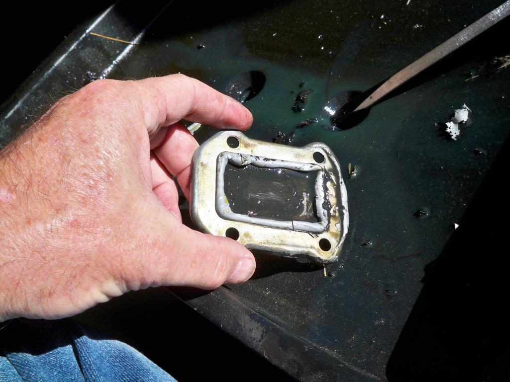

So I drained the oil. I would like to have saved it but it was getting too complicated... |
eyesright Tail shifter leak Oct 29 2014, 06:22 PM

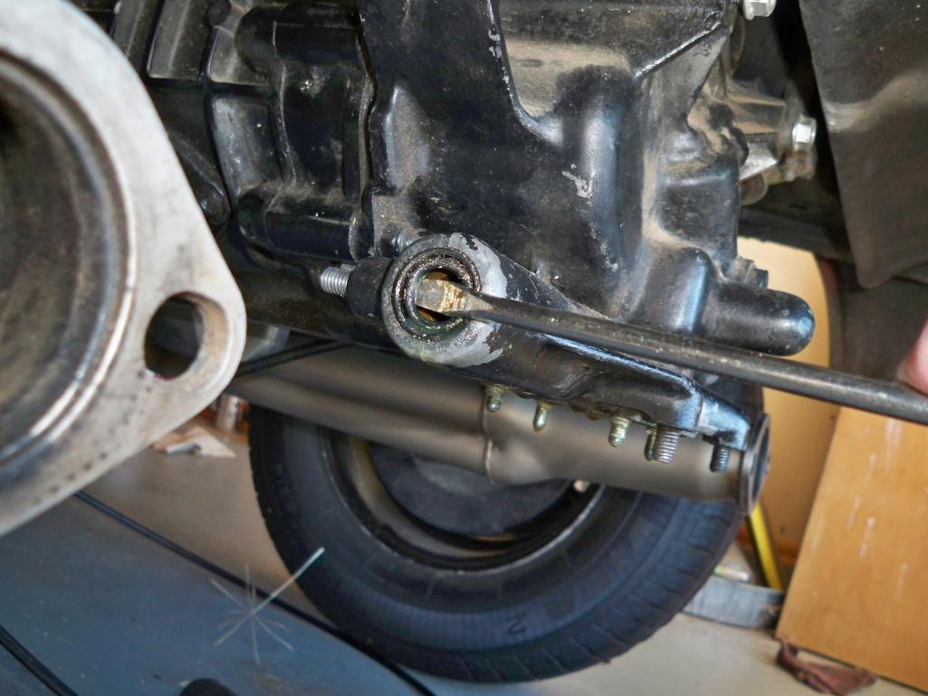

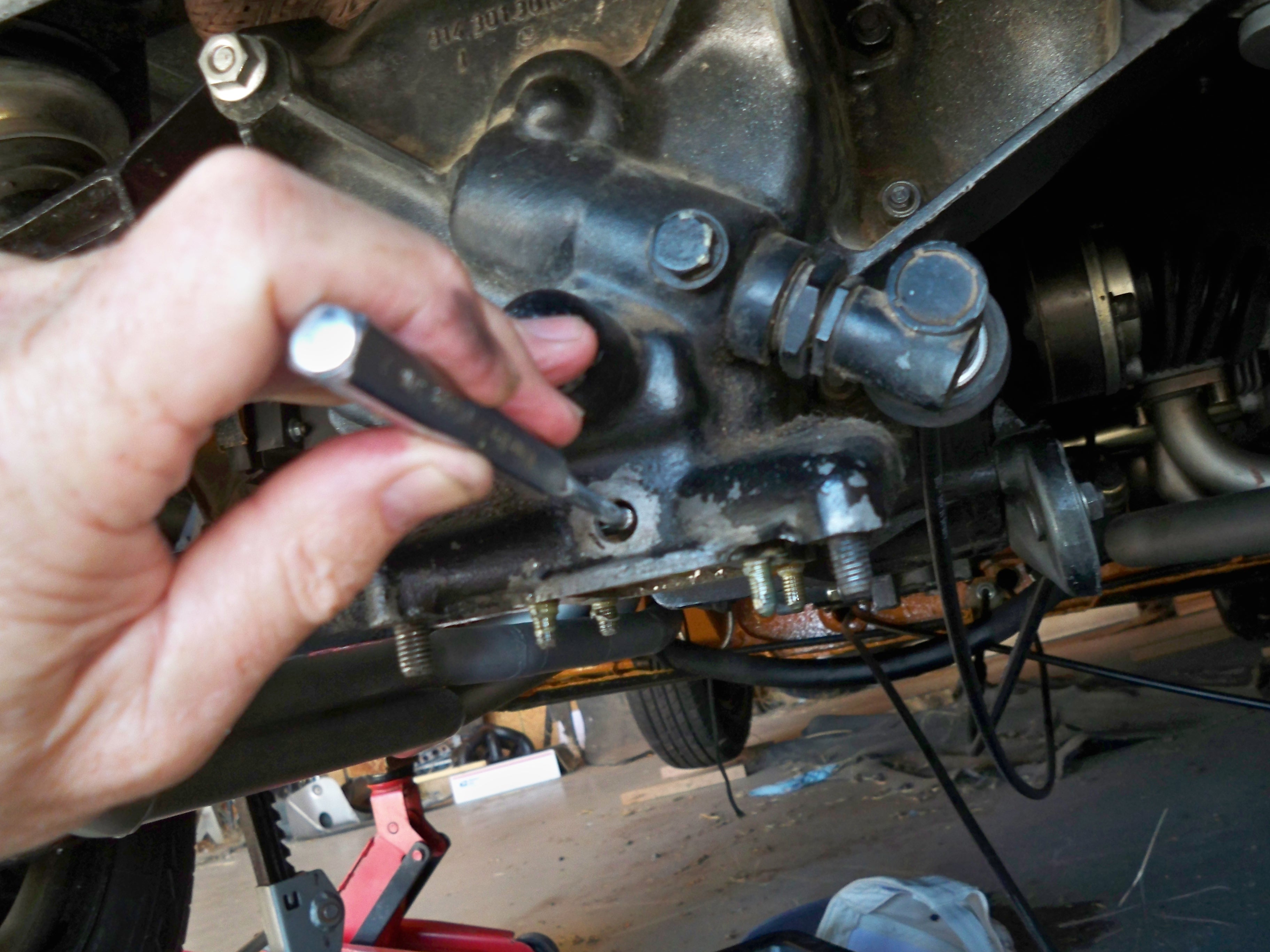

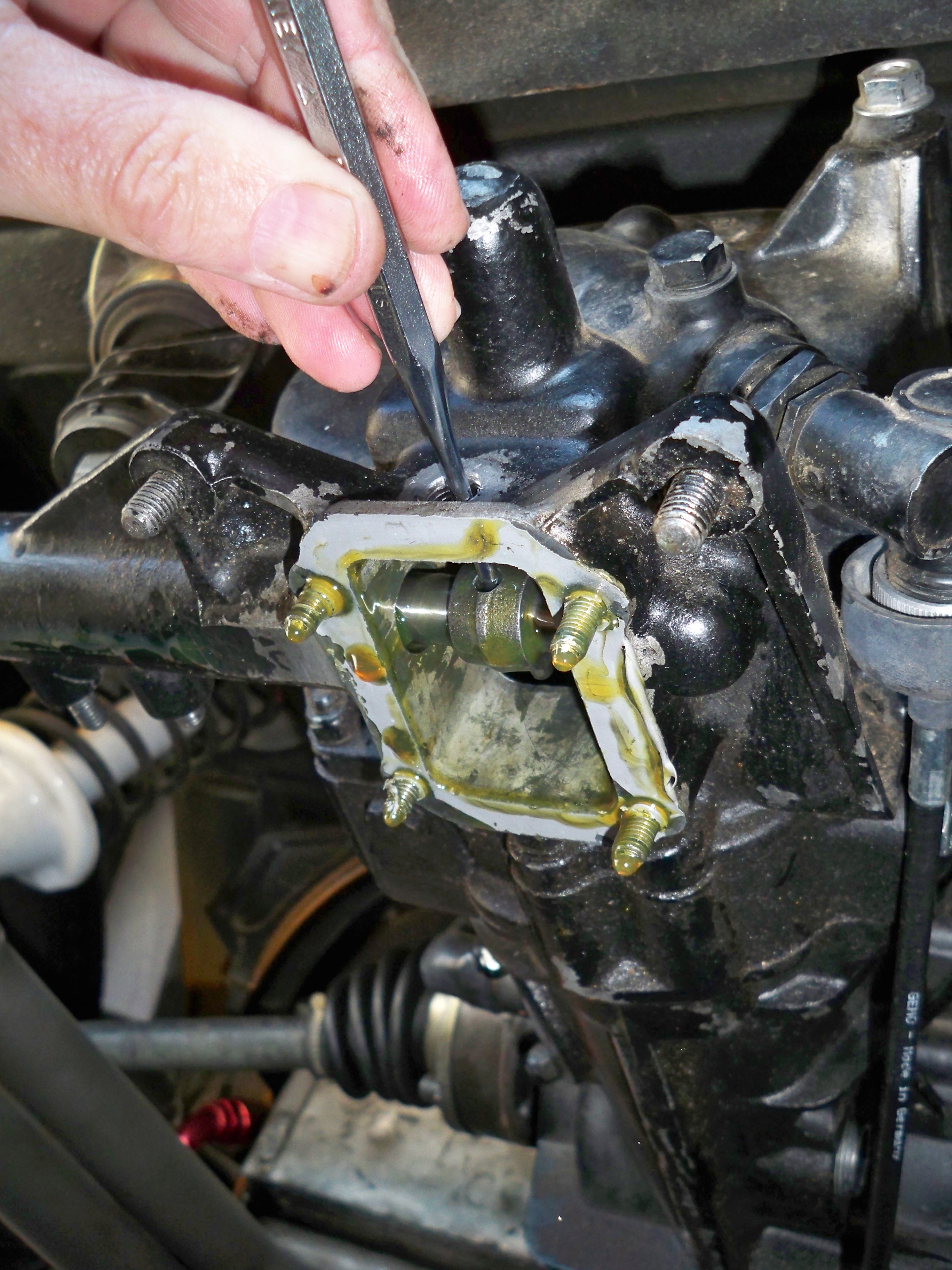

eyesright Pull the bolt and tap the roll pin with a punch.
... Oct 29 2014, 06:26 PM

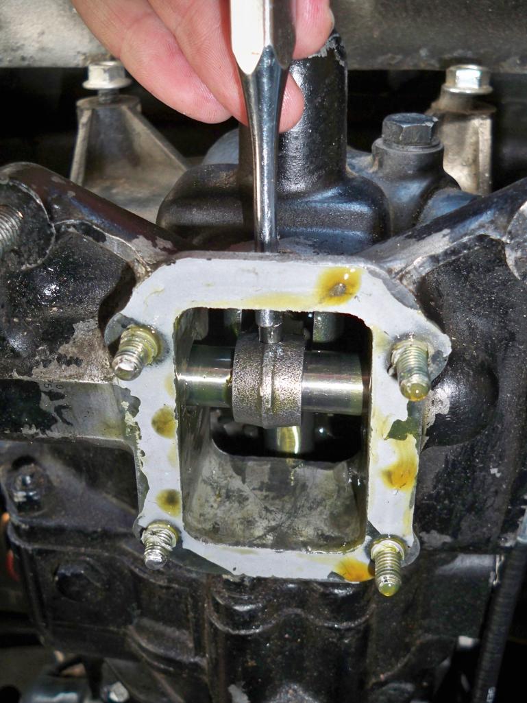

eyesright So I can either lower the transmission or loosen t... Oct 29 2014, 06:32 PM

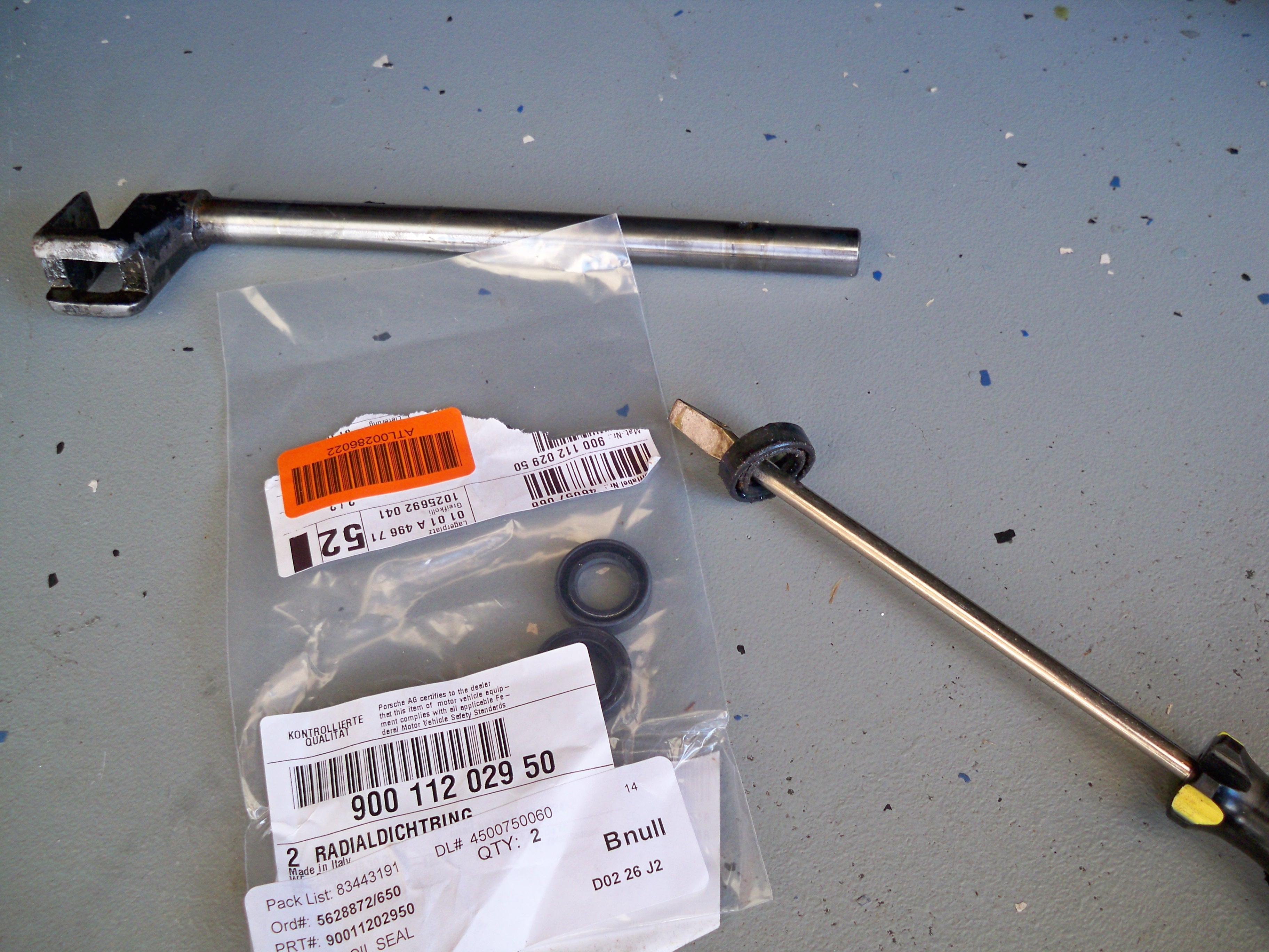

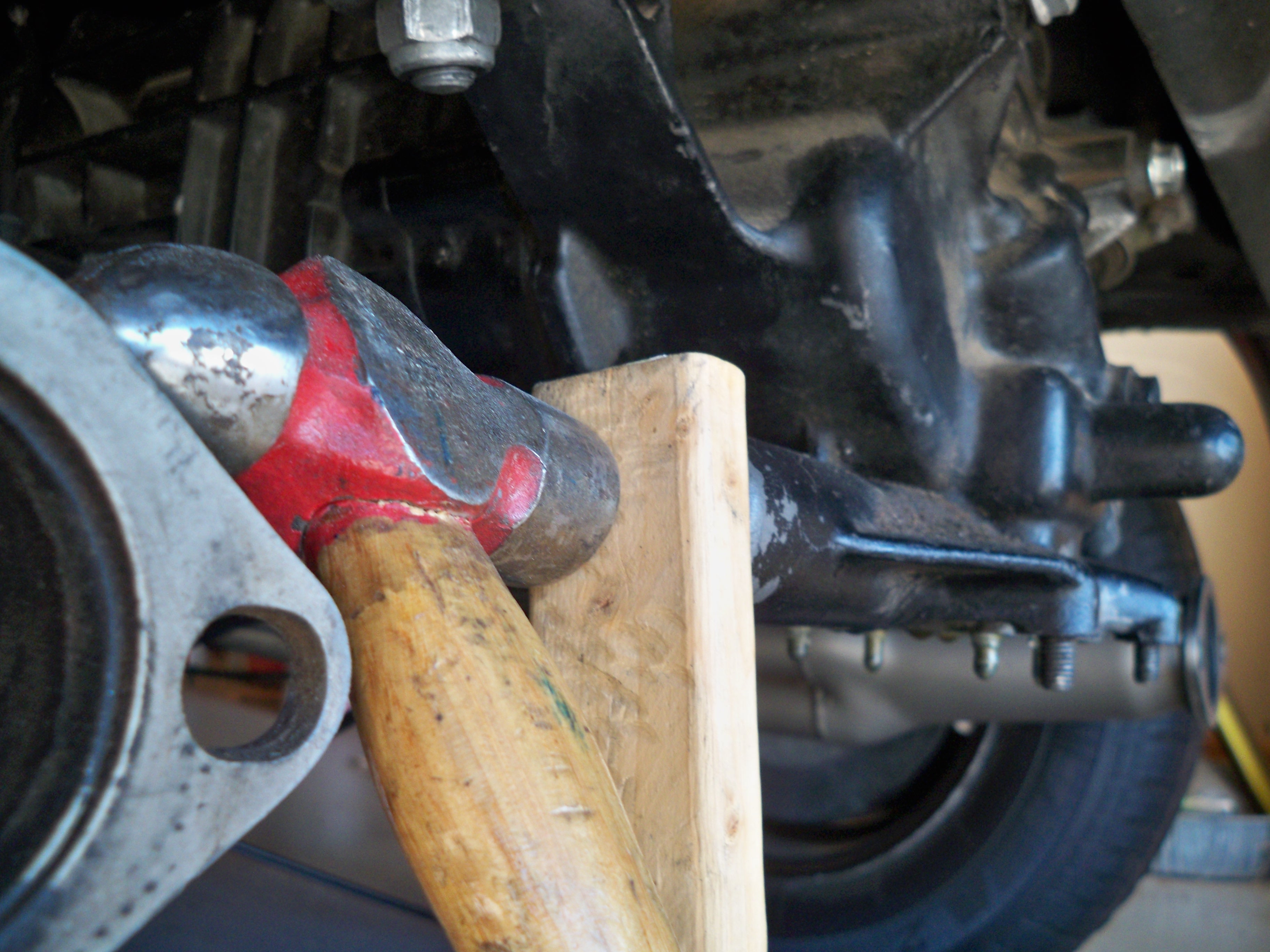

eyesright Tap in the seal...
Slide the rod back in...
Oct 29 2014, 06:45 PM
eyesright Tap the roll pin back in...

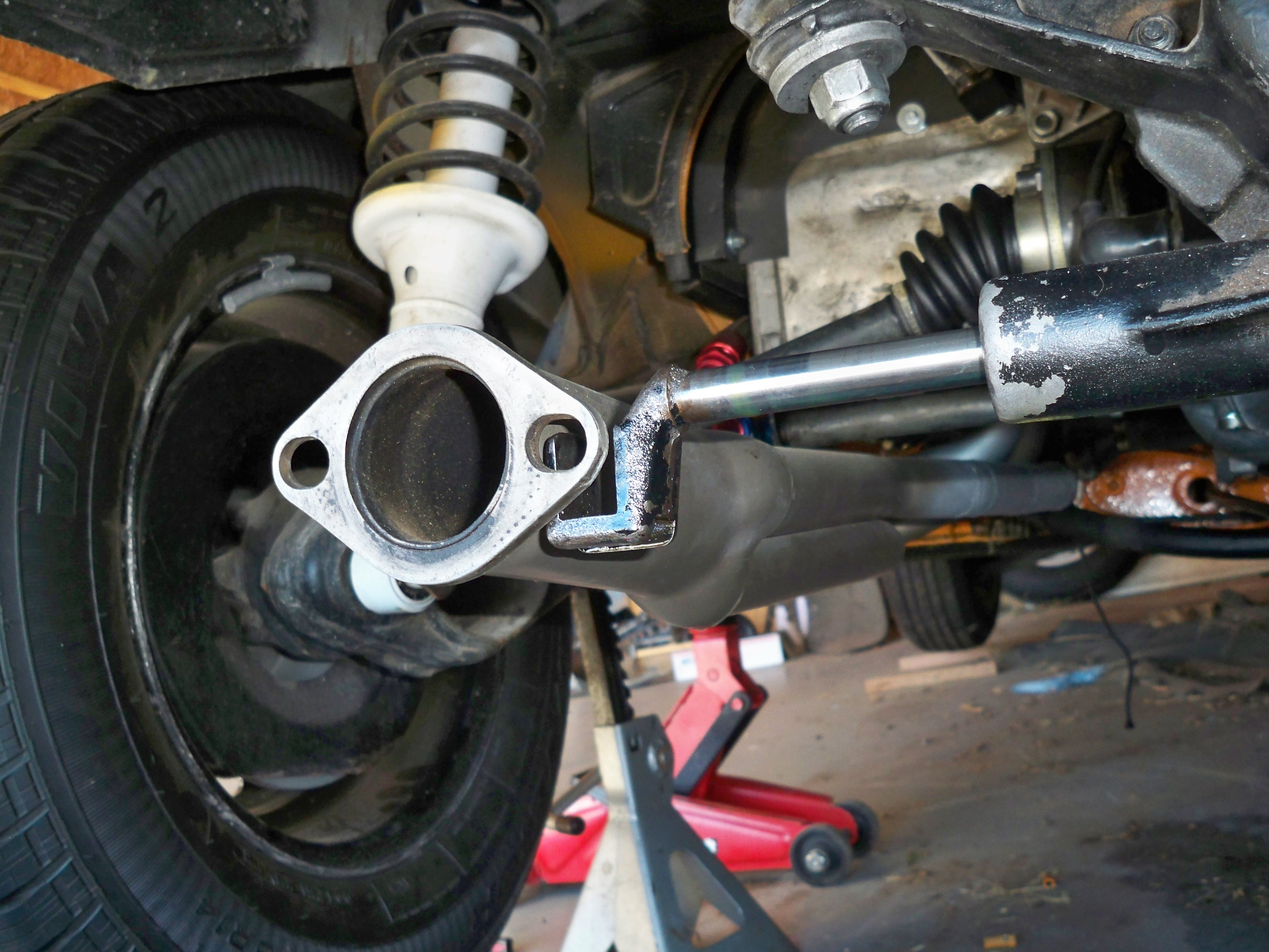

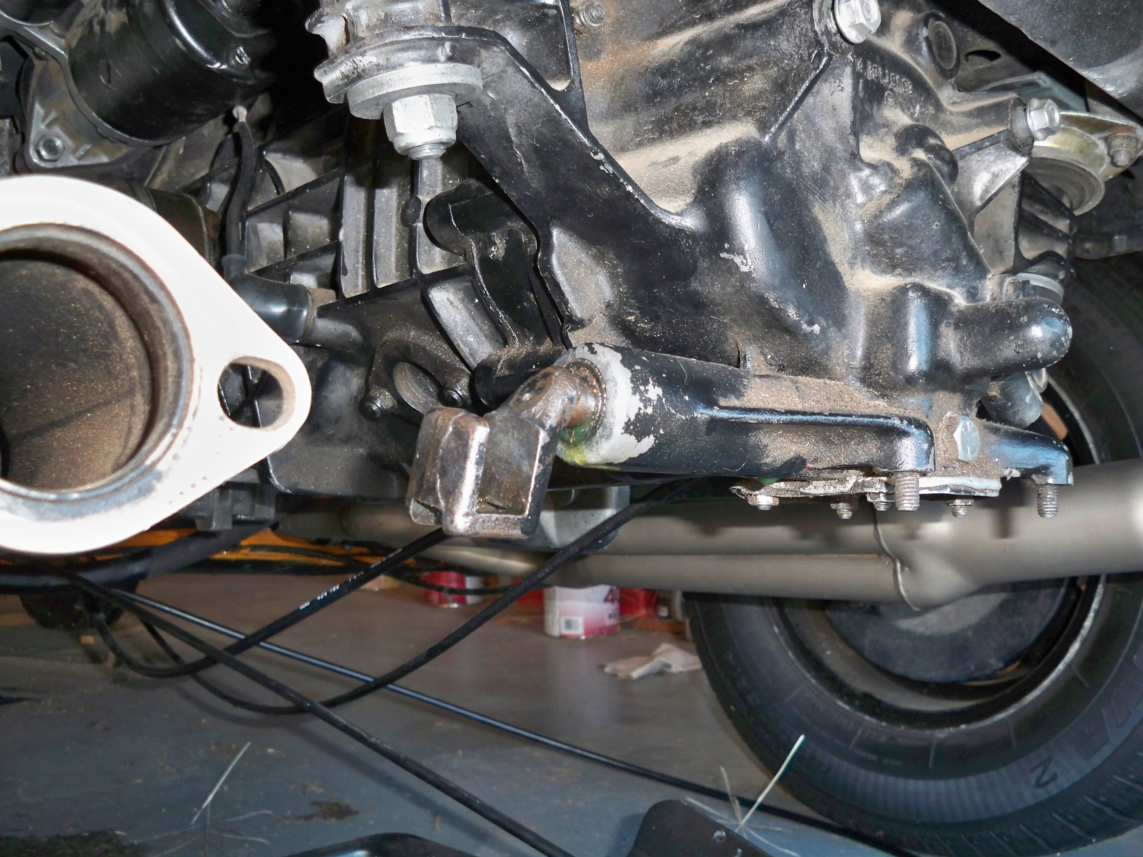

The view from below... Oct 29 2014, 06:48 PM

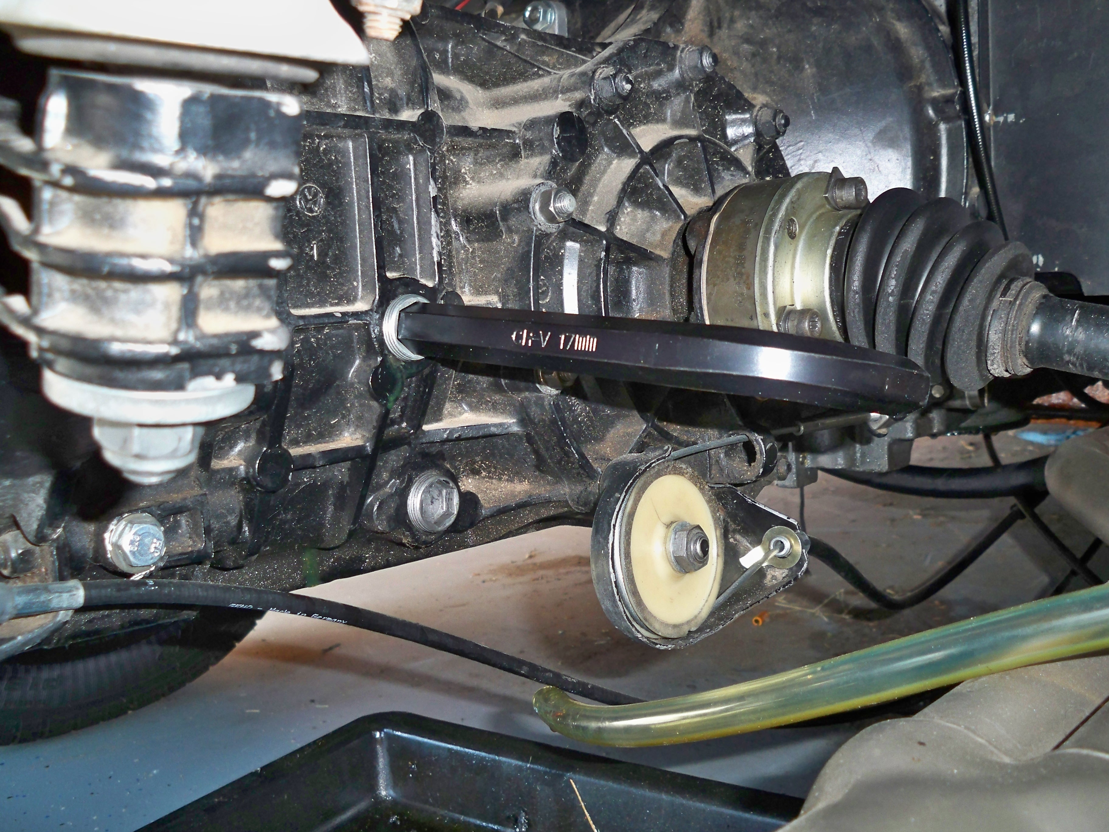

eyesright A DAPO is one who can't use a paper gasket but... Oct 29 2014, 06:55 PM
eyesright I tightened up the header and added fresh GL-5. Re... Oct 29 2014, 07:01 PM
