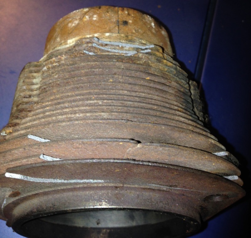

Here's a pic of one of the cylinders, showing the broken fins. I'm thinking this shouldn't be reused, but want to get other opinions.
VWTortuga336
post Nov 14 2014, 09:02 AM
Posts: 285
Joined: 5-October 14
From: Kansas City, Missouri
Member No.: 17,979
Anyone have any opinions on these fins? Also, is the extra 85cc worth the price of new P&C? I know those questions may be a bit subjective, but I am just looking for opinions.

OK, Here's my opinion...........Don't use those......Get new.
If that's not enough check with a good shop that uses a torque plate when boring and honing the cylinders..........compare that price to new cylinders, you will see that new is the way to go.

I kept my original P&C's, & have them in a box. Chose to order new from European Motor Works. Lots of opinions, and the most common is to have originals bored to 96MM. Conventional wisdom says they are of a higher quality Iron. I have no experience or reason other than new felt right, and my source was highly recommended as having high quality stuff. Plus a quality clean, bore and hone was PRICEY........ Just diddnt seem worth it.
No decision if I will sell the originals yet, they are in great shape.
