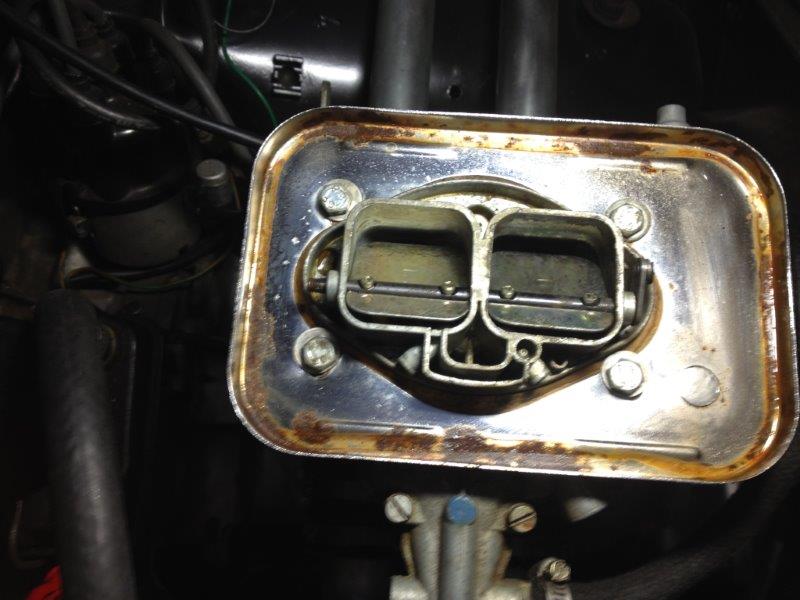

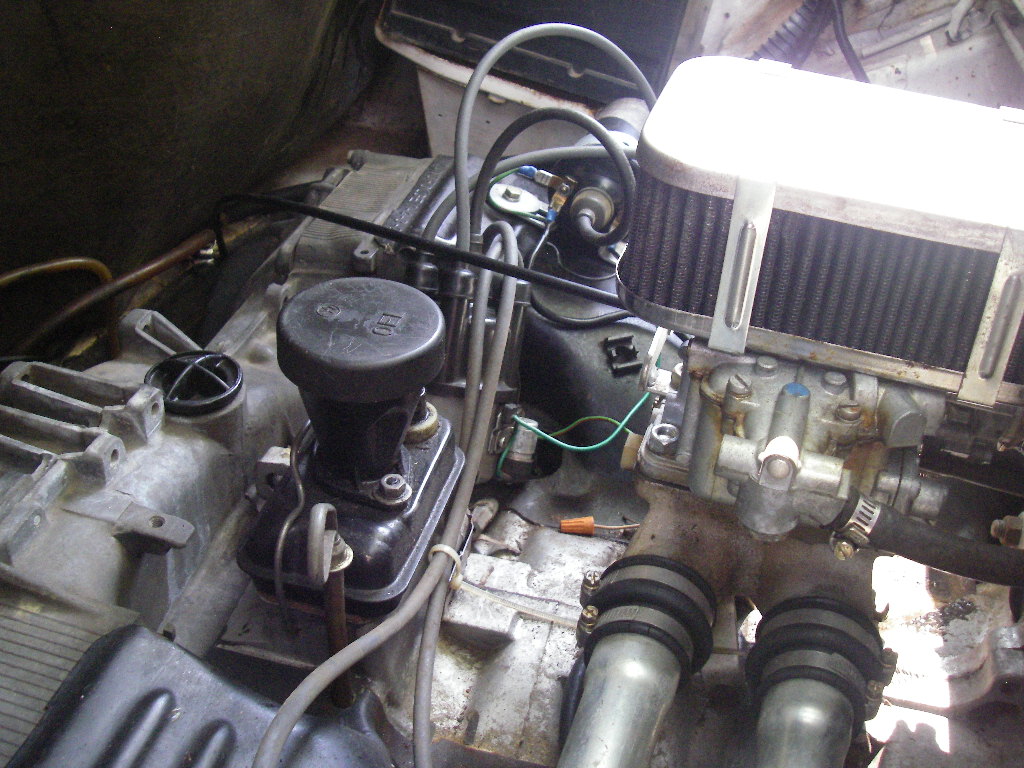

Photo of carb.

The very first thing you should do is determine the ststus of the throttle plate. If it's not closing all the way, there's the fundamental issue. Disconnect the throttle cable at the throttle arm of the carburetor and see if that fixes it. If not, remove the air cleaner and take a look down the throttle bore. Something stuck in there? Choke stuck on? If removing the cable solves the problem, look at the pedal, the rod, the bell crank in the pedal cluster, and the front end of the cable. Disconnect it there and see if it moves freely. Report back.

Are you not missing a hose from the oil fill/PVC valve? Chech for vacuum leaks all around.
Clutches can take a good deal of abuse so unless you were extreme in riding the clutch it may be ok.
But overall if it is the carb, don't go back single.

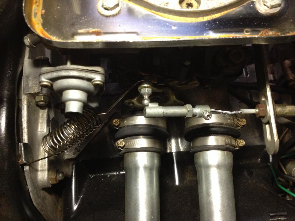

Guys, thanks for all your posts... a wealth of wisdom. So I had some time this weekend and disconnected the cable from the carb via the bell housing and discovered the problem (see the photo below). The cable was "too short" to allow the throttle plate to close, thus the 4000 rpm. So I think maybe the recent cold weather shrunk the cable (so I thought). I adjusted threaded bell housing to extend the reach, reconnected it and viola, the throttle plate closed. Took it out for a test drive, within a few miles....4000 rpm again. Back to the garage, pull off the cable, same thing again too short...Hmmm am I in the Twilight zone, maybe I didn't extend it enough? No more threads left on the bell housing, so I fed some of the cable of the out bell housing so there was even a little slack, then re-attached. Drive to work this AM...... 4000 rpm again!
Oh yeah... I realized I don't even have pedal stop !
So, using the collective wisdom of the previous posts, this is probably not a carb issue, but a bent bell housing at the pedal end. Do I inspect this area by taking off the pedal board and is the bell housing at the pedal end the same as the one at the carb?
Can this be re-straightened or do I need to buy a new cable (PS - I know that my cable is frayed at the carb end).
Thanks in advance for your help.
-Don

Is it sliding in and out of the sheath easily? Likely binding up/splitting. That fray is a problem, too. It can catch on stuff and keep it from letting the cable release.

at some point soon you should consider replacing those boots that connect your plenum to the runners. They all looked pretty cracked. That will make a big vacuum leak and certainly not help the situation. Naturally this is after you fix your frayed throttle cable.

Yes, the cable pulls freely in the sheath, when I disconnected it from the carb, I had my son press the accelerator and I was able to gently pull it back at the carb end.
What has me baffled is the "return point" of the cable seems to be changing. Everytime I adjust the cable so the throttle plate is closed, then drive it, the darn throttle plate end up "open" again to the same point that causes the 4000 rpm. That is why I wondered if I bent something each time I depressed the accelerator pedal (since I don't have a pedal stop).

Yes, I used carb cleaner and sprayed the carb while running. As soon as I disconnect the cable from the carb, it returns to normal idle.
Now when the engine is off and I push down on the throttle plates manually, they do not return fully to closed position (see photo below), but as soon as I turn the throttle on the carb, the return to fully closed position. I just assumed I created a "choked" position with the carb when I manually pushed them down, but maybe this is a problem too?

I'm no expert on the Pinto carb but I'm pretty sure that's the choke not the throttle plates you pushed open and it's not relevant to your issue.
Sorry if this has already been answered but when it is doing the high idle, can you bring it down by pulling up on the pedal?
And, please get a new cable. The stock cable works fine with most carb linkages for duals.
