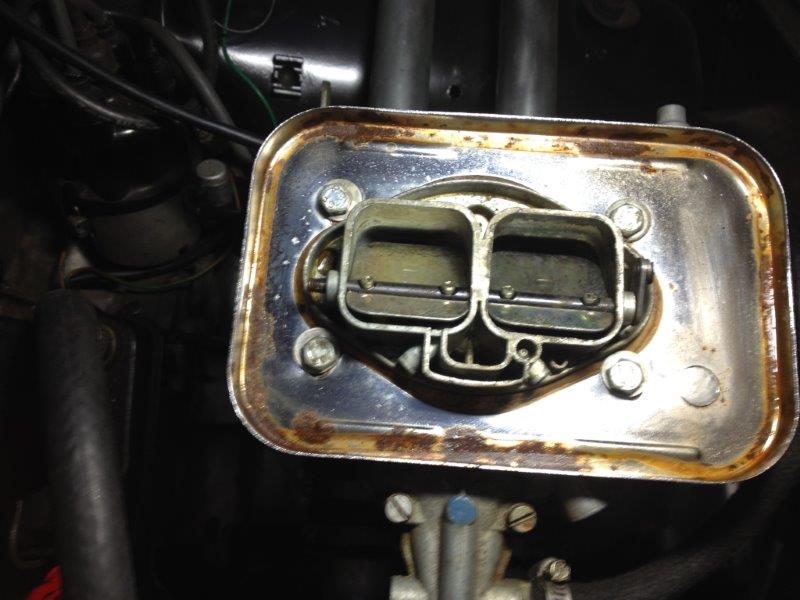

So I'm driving my 914 home in Charlotte 5:00pm rush hour traffic (down Independence Blvd for you locals) and my rpms go up to 3000. I have had this happen before but was able to lift the accelerator pedal to unstick a cable to return to normal...not so this time. I stop in a parking lot because I'm convinced the cable is stuck and holding the carb open..... not so, the cable is fully retracted. Get back in the car, then the rpms go up to 4000, then 4500 and I'm having to drive the car by braking and feathering the clutch all the way home, about 15 miles. By the time I got home, a little smoke and I could smell the clutch. I have not started it since. FYI- I have a 1.7 L with a single carb (been told its a Weber) that I have had for about a year and I have no history on the car or carb.
Two questions:
1. Is it time for a carb. rebuild? How much does a kit run? Or time for a new carb.... or switch to new carb(s).?
2. Does this mean my clutch is spent?
Photo of carb.

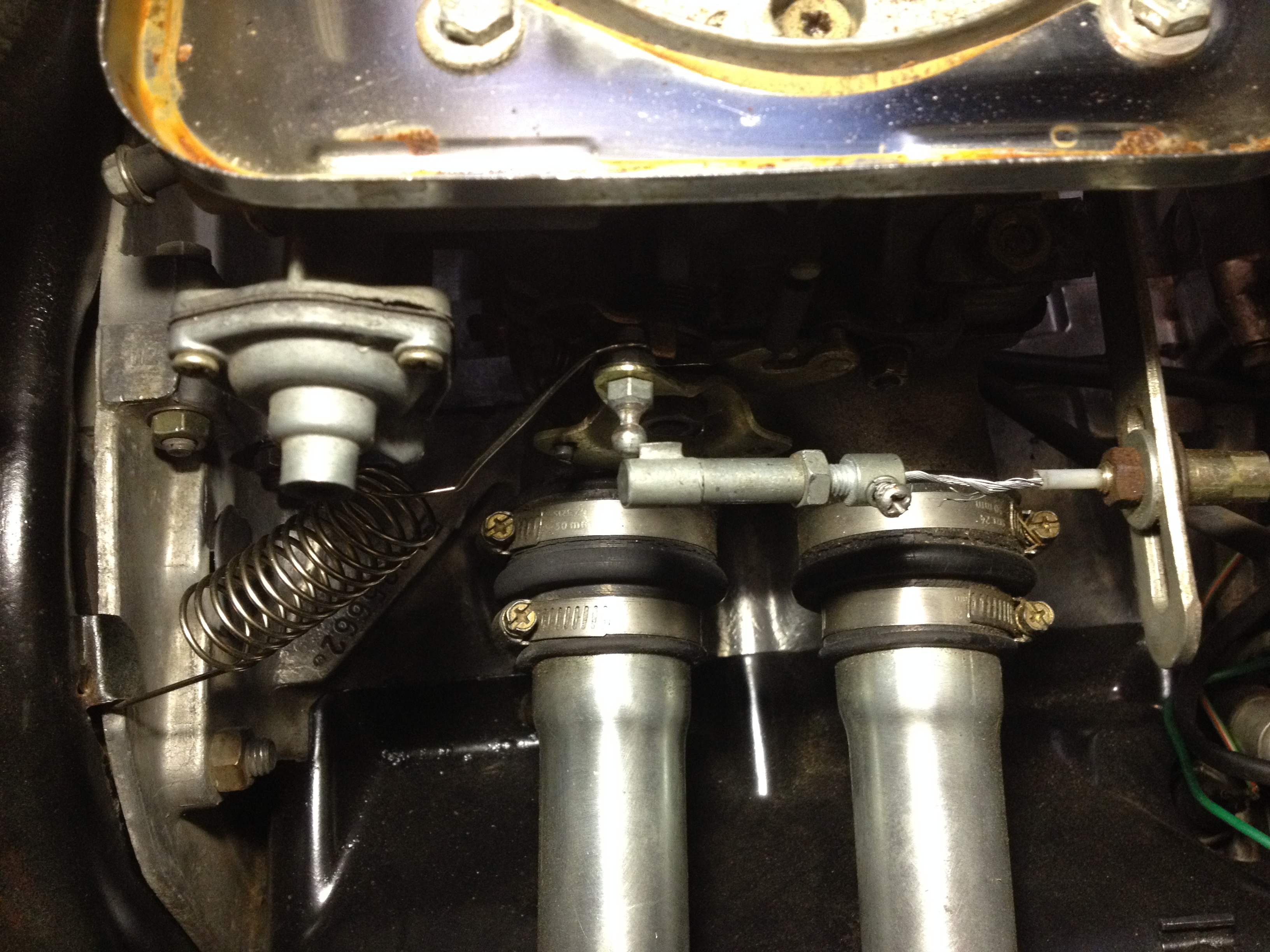

Guys, thanks for all your posts... a wealth of wisdom. So I had some time this weekend and disconnected the cable from the carb via the bell housing and discovered the problem (see the photo below). The cable was "too short" to allow the throttle plate to close, thus the 4000 rpm. So I think maybe the recent cold weather shrunk the cable (so I thought). I adjusted threaded bell housing to extend the reach, reconnected it and viola, the throttle plate closed. Took it out for a test drive, within a few miles....4000 rpm again. Back to the garage, pull off the cable, same thing again too short...Hmmm am I in the Twilight zone, maybe I didn't extend it enough? No more threads left on the bell housing, so I fed some of the cable of the out bell housing so there was even a little slack, then re-attached. Drive to work this AM...... 4000 rpm again!
Oh yeah... I realized I don't even have pedal stop !
So, using the collective wisdom of the previous posts, this is probably not a carb issue, but a bent bell housing at the pedal end. Do I inspect this area by taking off the pedal board and is the bell housing at the pedal end the same as the one at the carb?
Can this be re-straightened or do I need to buy a new cable (PS - I know that my cable is frayed at the carb end).
Thanks in advance for your help.
-Don

Yes, the cable pulls freely in the sheath, when I disconnected it from the carb, I had my son press the accelerator and I was able to gently pull it back at the carb end.
What has me baffled is the "return point" of the cable seems to be changing. Everytime I adjust the cable so the throttle plate is closed, then drive it, the darn throttle plate end up "open" again to the same point that causes the 4000 rpm. That is why I wondered if I bent something each time I depressed the accelerator pedal (since I don't have a pedal stop).

Does the throttle plate return smoothly without the cable attached? You could have some carbon buildup around the shaft that needs to be worked out with some carb cleaner and elbow grease. Make sure there's no stiction at all in that assembly.
dcecc1968
Yes, I used carb cleaner and sprayed the carb while running. As soon as I disconnect the cable from the carb, it returns to normal idle.
