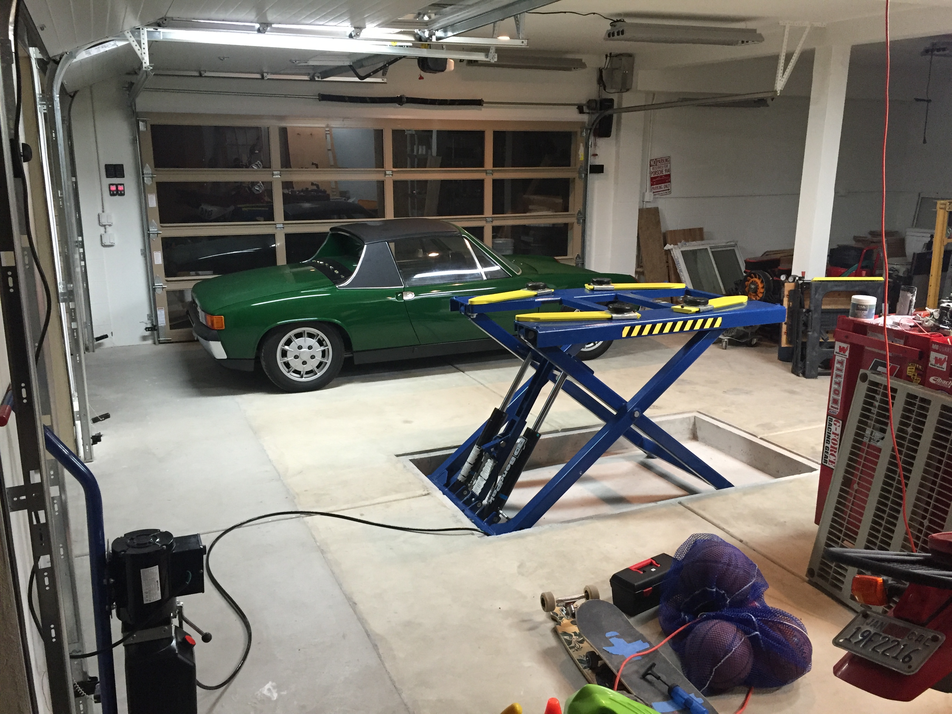

Most people simply put down 2x10 and then build a small ramp. The best way is to cut out your concrete and recess the lift into the concrete. I believe that Elliot did his this way

Cutting a hole in the concrete is not possible... So ramps it is... Do I need one 2X10 or two stacked together...?

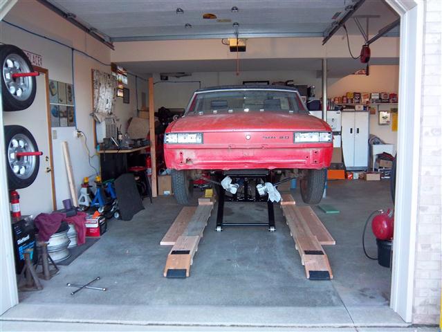

I made ramps with a removable center so I could swing the lift arms in place. Clearance wasn't an issue with stock ride height 914, but with my lowered 70 I needed the ramps.

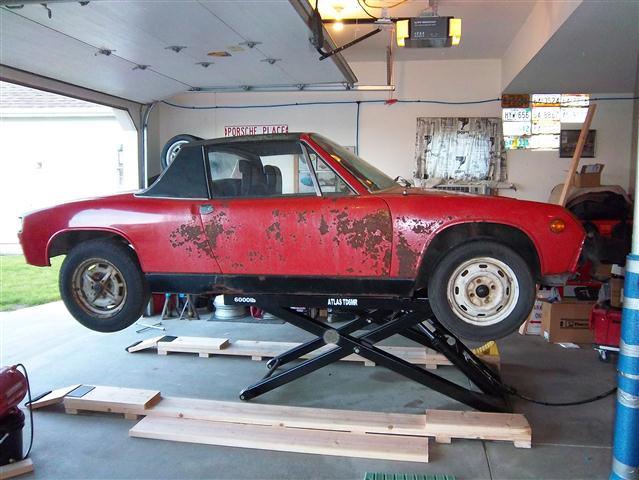

I had to use 2-2x10s 12ft long and stagger the top by a foot so that I could drive up onto the top board nail the two boards so that they don"t move when driving up onto them, after the the rear tires pass the top board I would stop before rolling out at the front. John

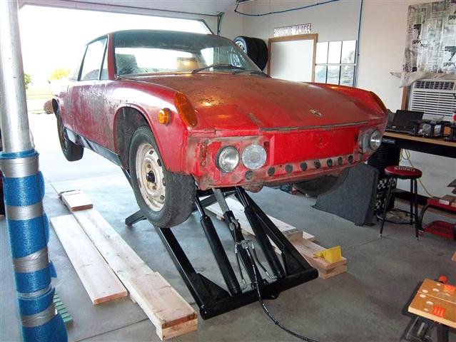

Ok, got the lift home and setup in the garage. Stock height 914 barely clears height wise.... And I cant move the lift arms into position with the car over the lift...
So now its off to the lumber yard for 2X12's for material for ramps...
All good... I was expecting this.. Ill post some photos once I get the ramps built.... Probably be a weekend project.

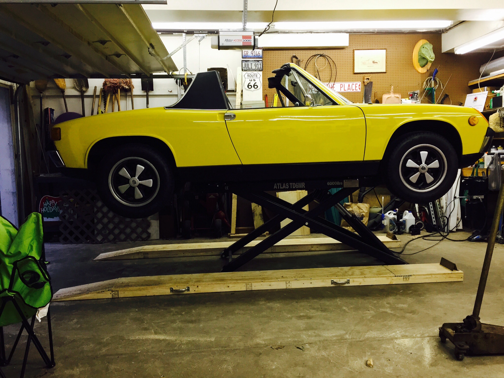

I used some 2x3 studs covered with 3/4" plywood to make my ramps. That made them lighter than solid wood ramps but still plenty strong, and the attached handles allow me to move them out of the way if desired.
The idea of using the plastic sheeting under the wheels is a great idea as well.
