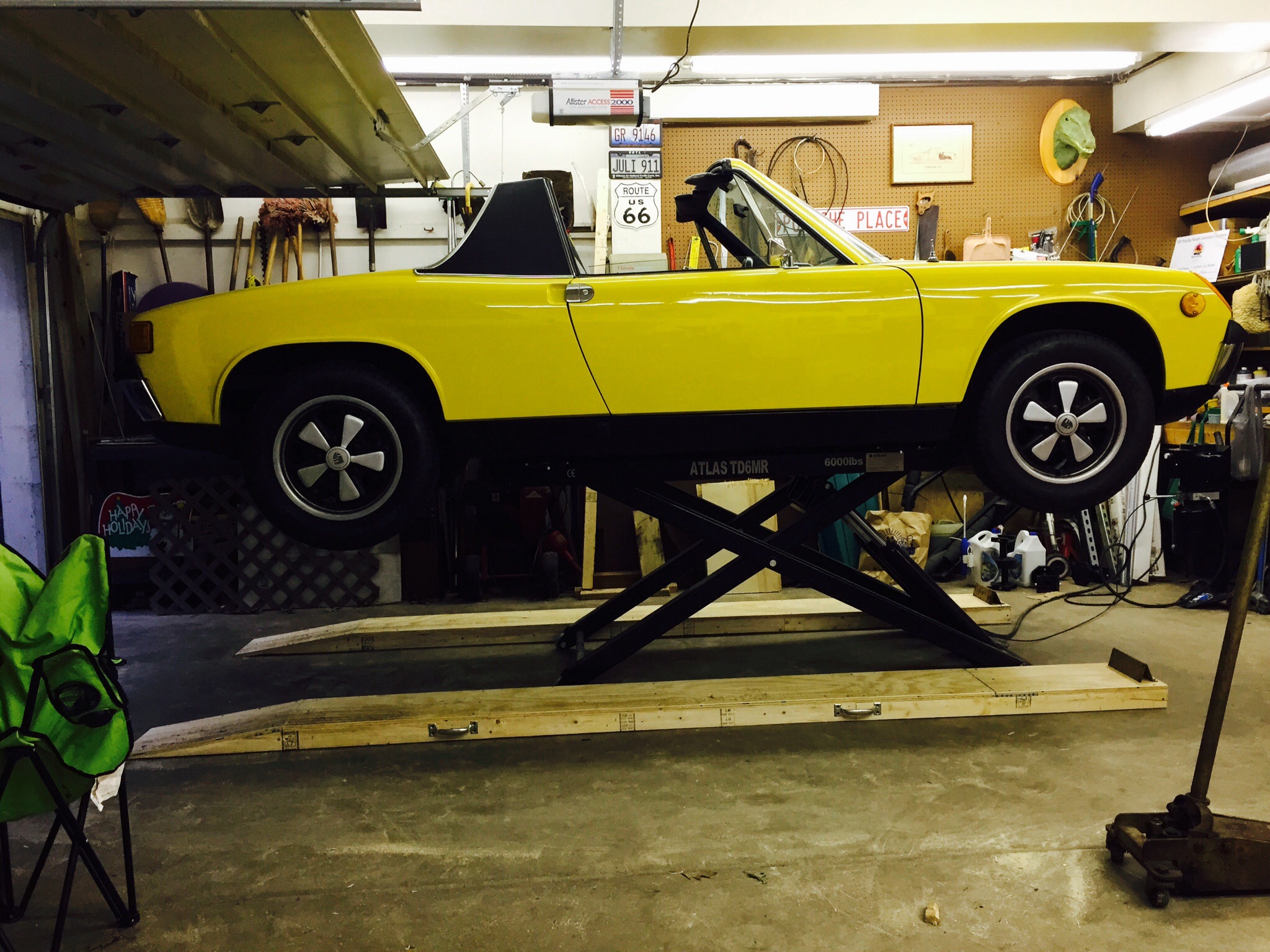

Click to view attachmentThis is my setup. Stock car with Harbor Freight mid rise lift. I used 2X10's at first, but I had trouble driving on them on a regular basis. These boards are cheap and 16" wide from Home Depot.
I do remove the rubber pads though, otherwise they may hit part of the front suspension depending on how centered one parks.
