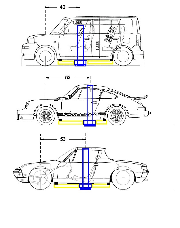

Phoenix-MN
post Nov 12 2014, 11:18 AM
Posts: 927
Joined: 23-January 04
From: ST. Bonifacius,MN
Member No.: 1,590
I spaced mine at 125" works for my 914, 911, and Scion Xb, I also have a Grand Cherokee and Dakota Quad Cab but have not used it with those two
Here's how I position the cars
