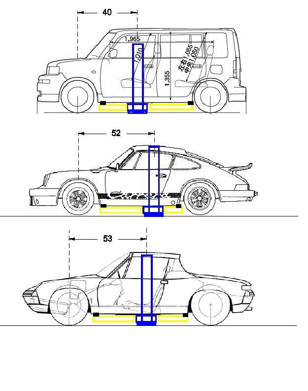

Phoenix-MN
I spaced mine at 125" works for my 914, 911, and Scion Xb, I also have a Grand Cherokee and Dakota Quad Cab but have not used it with those two
Here's how I position the cars
