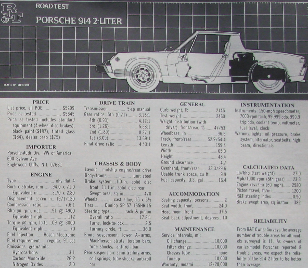

Dunlop SP57 165 HR65

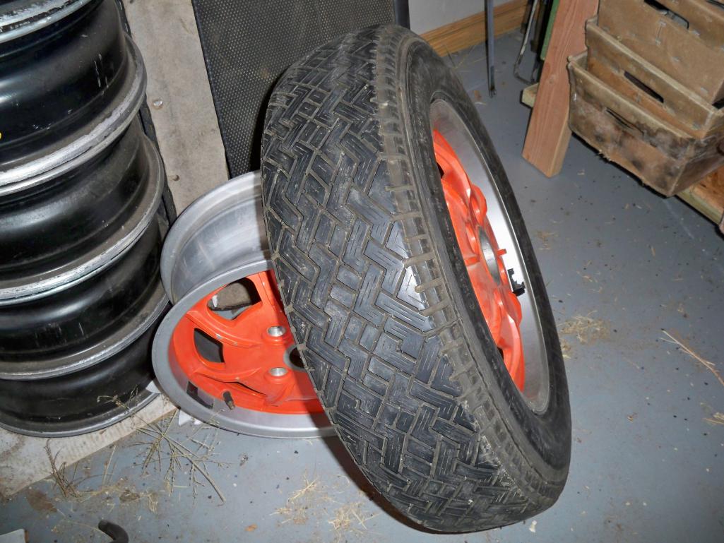

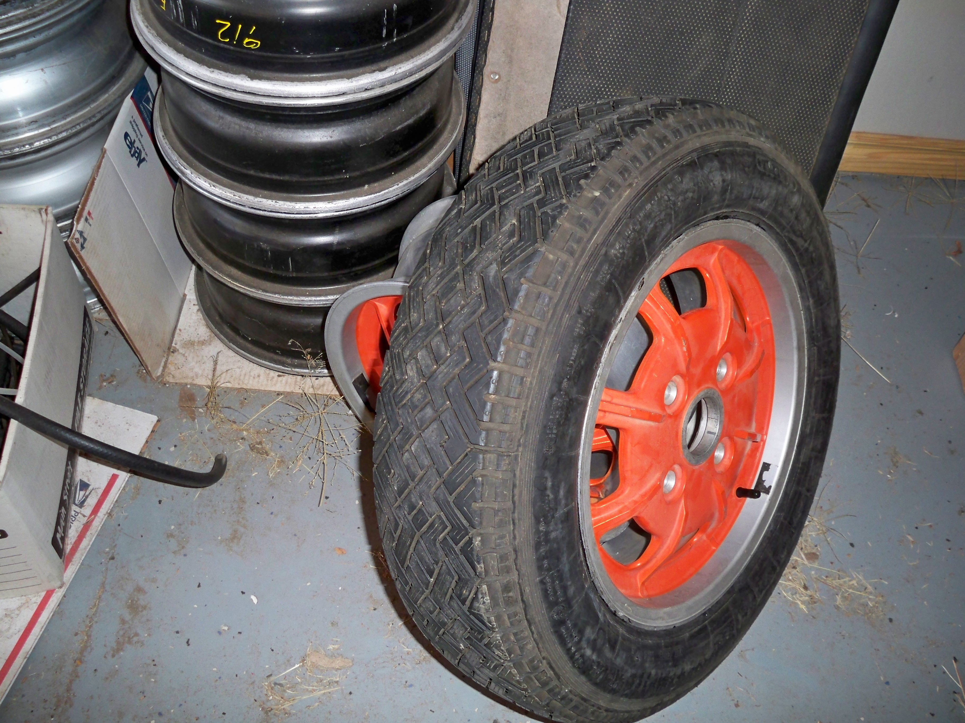

I remember seeing these (Continental) on 914's tho I can't tell you which year.
I got the wheel from a junk yard. I don't remember where I got the tire but it looks brand new so I had to mount it. They were the coolest looking tread and I sure wish they were still around.

Yeah, Dan has that correct - at least their initial US market ones & all of the magazine test cars for their then "new" 1973 914-2.0 models came with their best performing Dunlop SP57 165HR15 Tubeless tires - very sticky but not great miles out of them!
They also shipped later on in 73> with the Michi & Continental & even Semperits in Europe - you can read more at that O&H Forum Tires & Wheels thread linked above.
