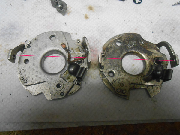

Check out your trigger points in the base of the distributor, maybe swap them out with another set; also make sure the connector is secure and not vibrating loose when the engine is running.
Check the condition of the points plate ground wire in the distributor.

QUOTE(Java2570 @ Nov 27 2014, 07:56 AM) *
This points plate ground wire that you speak of. Is it a small braided wire type of deal?

QUOTE(Nate @ Nov 28 2014, 02:18 AM) *
Yes, the small braided copper wire is connected to both plates.

post Nov 28 2014, 04:18 PM
Posts: 47
Joined: 21-August 14
From: Southern California
Member No.: 17,807
Okay guys. So, I resoldered the points plate ground wire since that had come off of the top plate. I also verified that the fuel pressure was at approximately 30psi. Still no dice. I'm going to pull the head temp sensor and test that. I'm kind of worried as to what I do if it's bad though since they are so hard to get ahold of for the 1973 2.0L. I guess mine requires the 0 280 130 017 Bosch part number which are near impossible to obtain.
