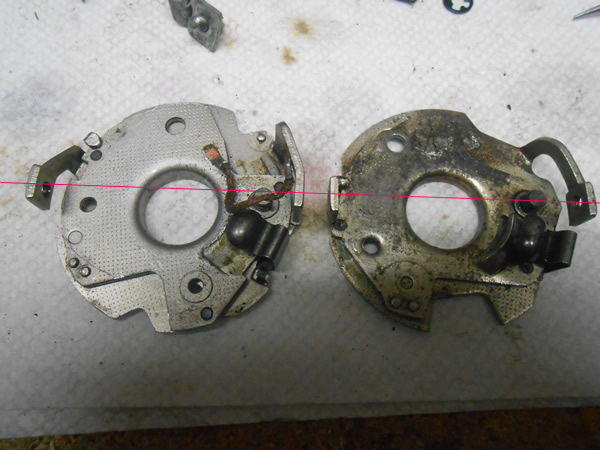

Check out your trigger points in the base of the distributor, maybe swap them out with another set; also make sure the connector is secure and not vibrating loose when the engine is running.
Check the condition of the points plate ground wire in the distributor.

QUOTE(Java2570 @ Nov 27 2014, 07:56 AM) *
This points plate ground wire that you speak of. Is it a small braided wire type of deal?

QUOTE(Nate @ Nov 28 2014, 02:18 AM) *
Yes, the small braided copper wire is connected to both plates.

Okay guys. So, I resoldered the points plate ground wire since that had come off of the top plate. I also verified that the fuel pressure was at approximately 30psi. Still no dice. I'm going to pull the head temp sensor and test that. I'm kind of worried as to what I do if it's bad though since they are so hard to get ahold of for the 1973 2.0L. I guess mine requires the 0 280 130 017 Bosch part number which are near impossible to obtain.

Trigger points are associated with injectors not spark plugs. One set of points work with one bank. The other set works with the other bank. How did you test the injectors? Did you test them in the car or did you do something else?
Nate
I tested the injectors on the car.
Just wanted to let you guys know that I found the problem. Apparently, at some point, one of the bolts holding on the rocker assembly for cylinder 4 stripped right off the stud. I checked compression yesterday and was getting 30 psi on cylinder 4. So I popped the valve cover off and the issue was staring me right in the face. So I'm happy that I found the issue but also a bit confused as to how this occurred. Valves were all adjusted to spec during the rebuild. I guess it's possible that I cross threaded the bolt onto the stud but I was very careful during the process. Both the stud and the bolt threads were stripped.
