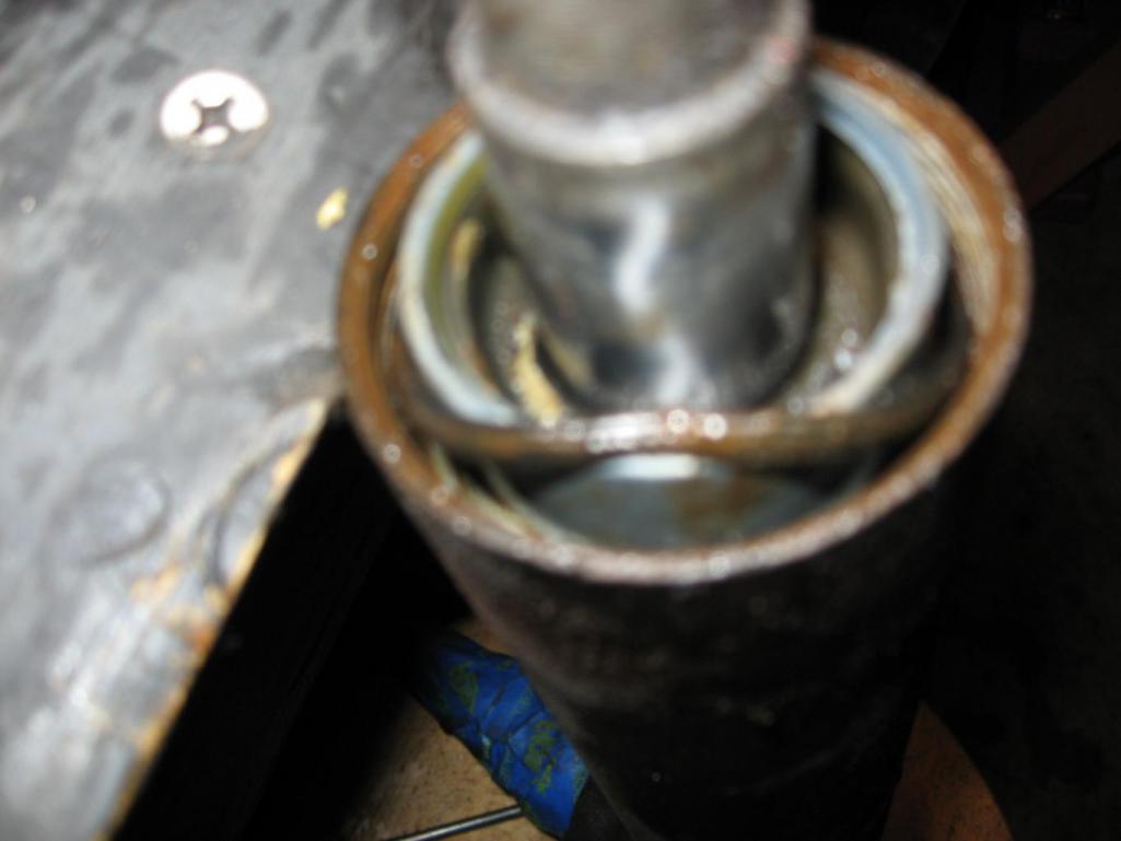

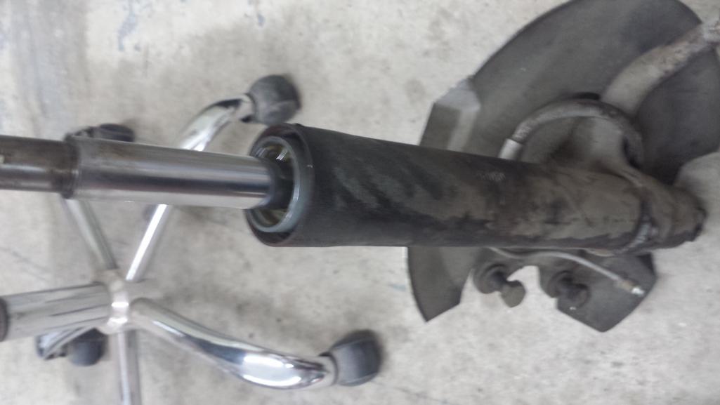

I know I should have used a spanner wrench but I used an air hammer and cracked the jamb nut. But how do you pull the shock out of the spindle ? Attached Image
malcolm2
post Dec 8 2014, 10:33 PM
Posts: 2,747
Joined: 31-May 11
From: Nashville
Member No.: 13,139
It has been too long since I did it, but is that a set screw at the btm?
I really thought mine just slid out.

It should just slide out, if it doesnt try bolting a spanner to the top thread and pound on the spanner with a rubber mallet while keeping a foot on the hub assy or gently clamping the strut body in a vice.

Turn it upside down and drain the fluid first....or you will wear it and smell like hypoid gear oil for days. Grab the rod and jerk it like pulling carrots.

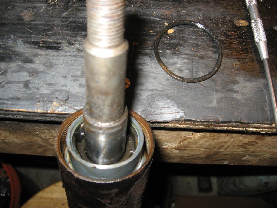

If it is the original Boge/Sachs strut, there is an O ring keeping everything in the tube. Pull the o ring out with a small pic and the insert will slide up.
See pics.

Sit on the ground...put the bottom between your feet...pull like hell. (After you drain it.)

I have had several stick badly in the strut. I clamp the top of the strut rod in a vice and tap on the frame part of the spindle assembly with a hammer.

One other comment. Check to see if the strut is dented at the weld tab. Easily dented "in" in the area. Ask me how I know.

Turn upside down, over you head and pull it out while holding it there.
Leave the fluid in to help you remove the strut......nothing bad will happen.

Note that some 911 struts have inserts that are held in with roll pins. Those need to be tapped out before you can remove the insert from the strut.
It doesn't look like you have one of those, but just in case...
