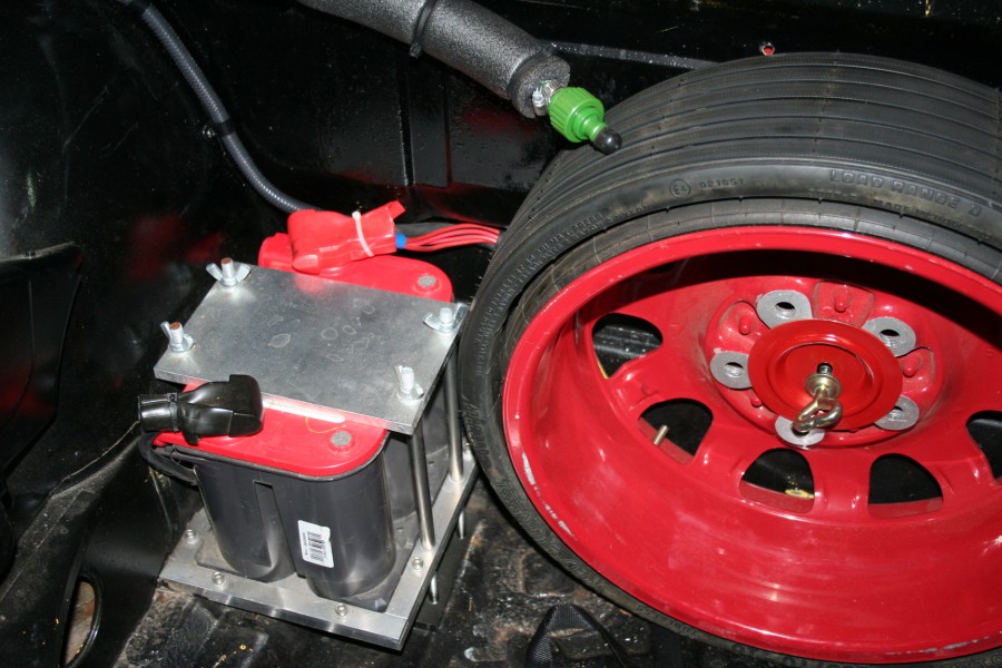

You can leave it inflated and not have to carry a compressor. I may still have a 924 space saver with a good tire.

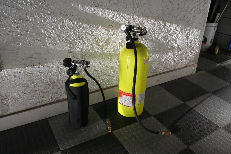

This works for pumping up a spare. First stage of a SCUBA regulator drops pressure to about 120 psi. It will inflate the spare a lot faster than a 12 volt pump. Only problem is, at most places they want to see a SCUBA Cert. card before they will fill the bottle for you.
