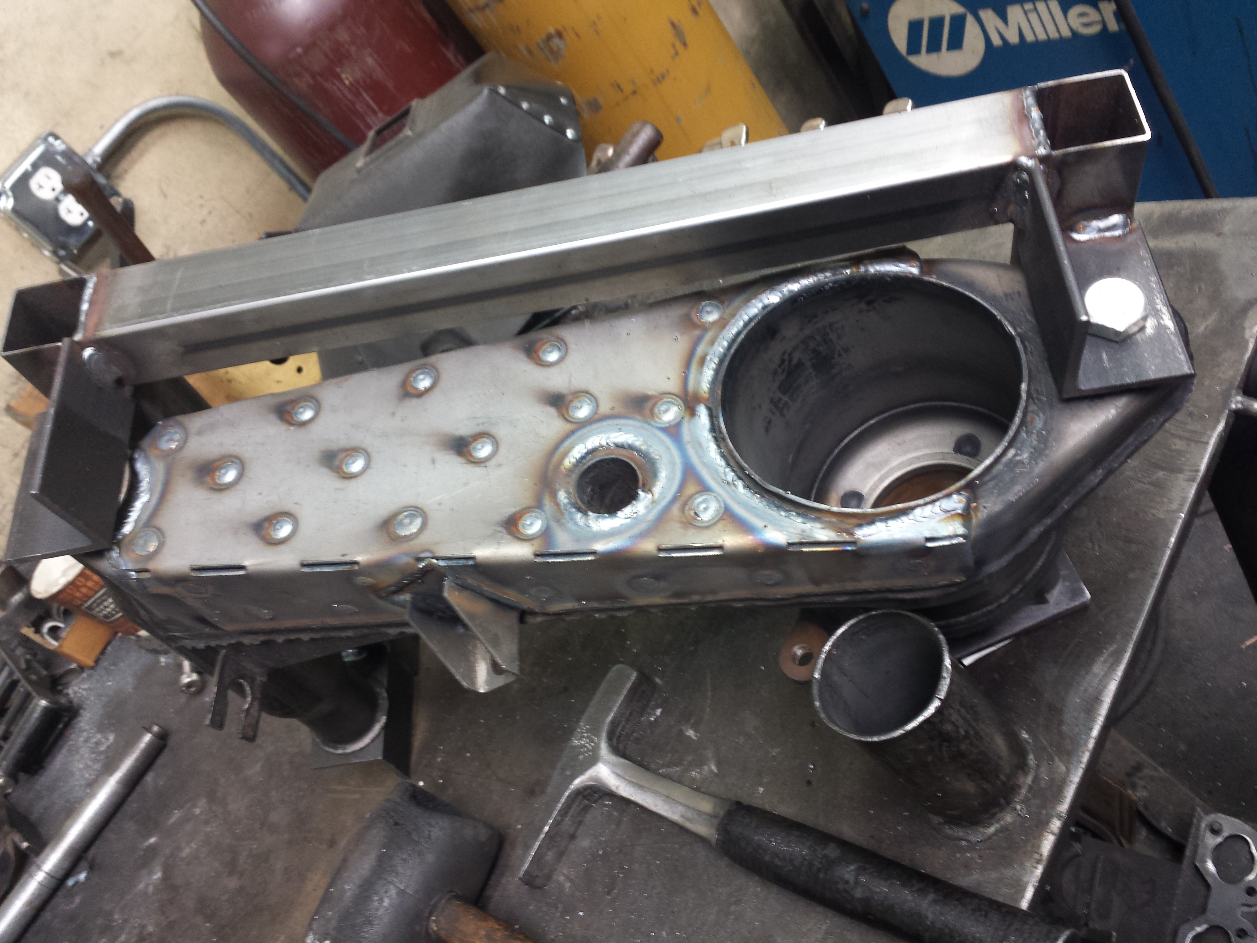

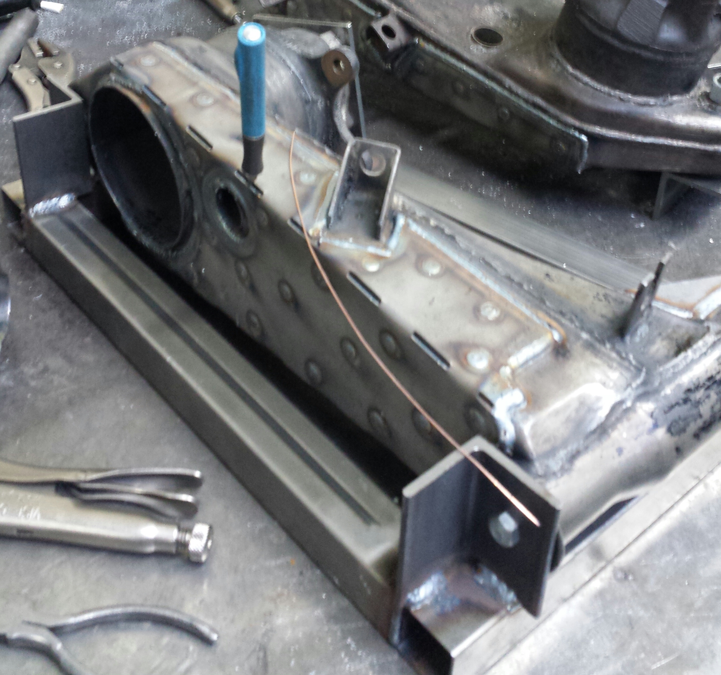

Chime in if you've experienced the welding/ non welding of these laser-cut slots in the stiffening kits. Looks like these are just for break-bends, but the torch is hot now (IMG:style_emoticons/default/welder.gif)
Thanks ! |

GeorgeRud Seems like there's quite a gap between the rei... Dec 12 2014, 01:38 PM
ThePaintedMan Nice jig and really pretty rosette welds! Dec 12 2014, 01:43 PM
Elliot Cannon Is there any concern about moisture inside the slo... Dec 12 2014, 02:06 PM
Maltese Falcon I can just get this xacto blade into the slot, an ... Dec 12 2014, 09:30 PM
Jeff Hail Marty
Weld up the slots and make them look nice. ... Dec 12 2014, 09:42 PM
Maltese Falcon
Marty
Weld up the slots and make them look nice.... Dec 12 2014, 10:09 PM
r_towle I would agree on all counts.
Weld it up
1000 HP is... Dec 12 2014, 11:16 PM
euro911 If for no other good reason, I'd think that we... Dec 13 2014, 12:36 AM![]() ![]() |
