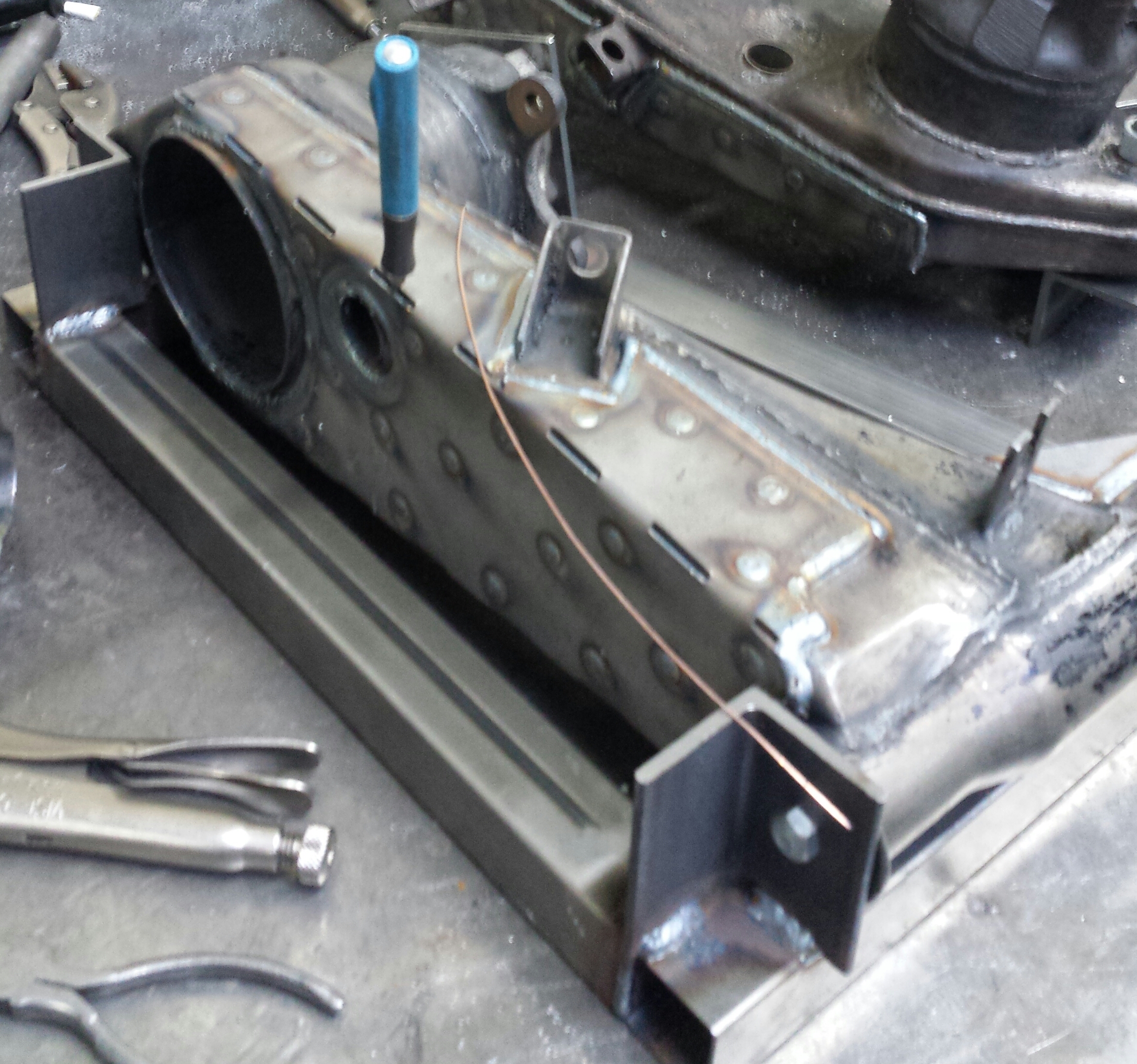

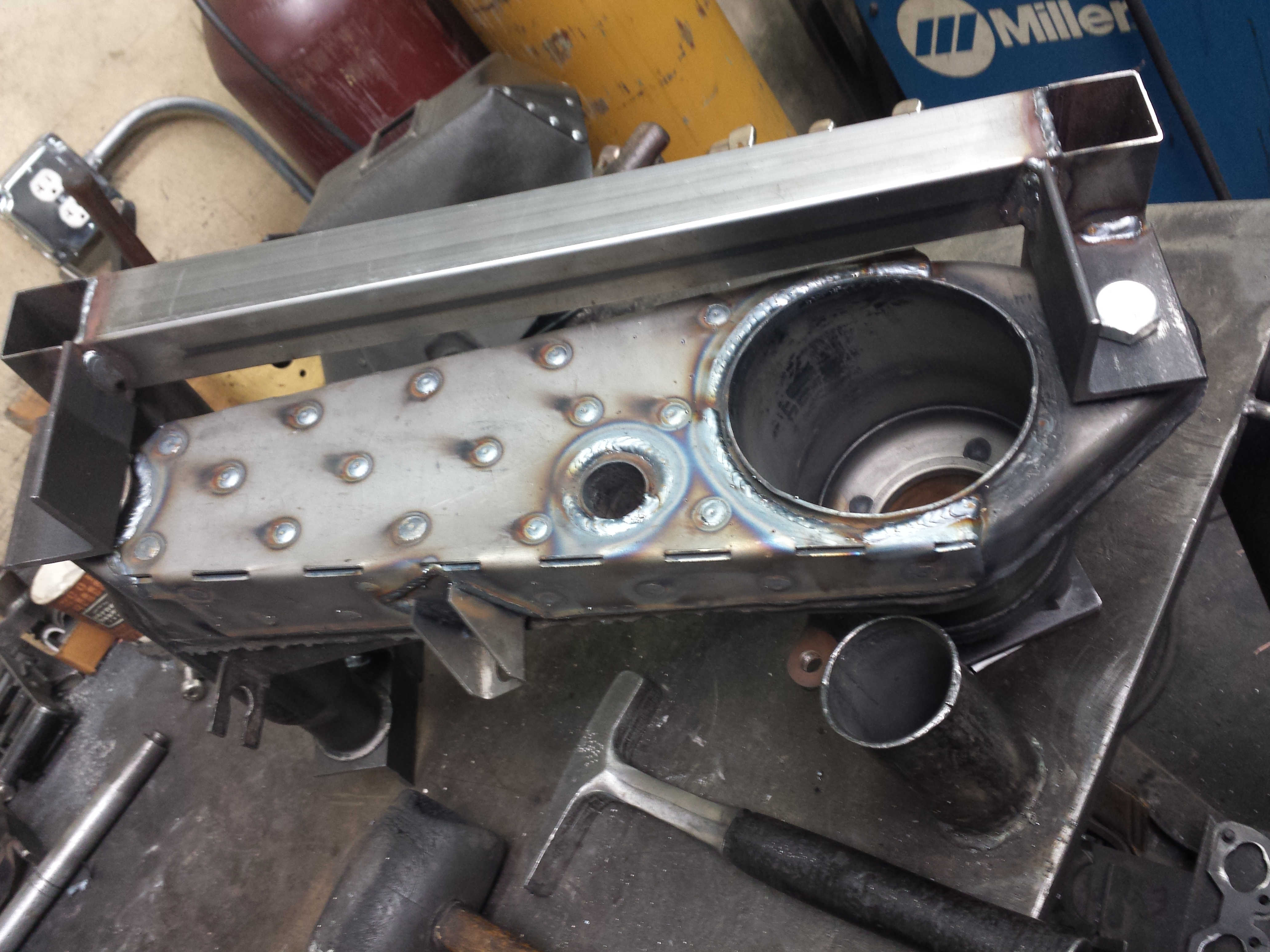

Chime in if you've experienced the welding/ non welding of these laser-cut slots in the stiffening kits. Looks like these are just for break-bends, but the torch is hot now welder.gif
Thanks !
GeorgeRud
Seems like there's quite a gap between the reinforcement panel and the trailing arm due to the differences in radius. You could certainly run a bead to close them up at least and that should strengthen the trailing arm. JMHO!

Nice jig and really pretty rosette welds!

Is there any concern about moisture inside the slots? Also, if you make the trailing arms super strong and hit a curb or berm etc., that instead of the trailing arm bending (that is easily replaced) you will damage the chassis where the trailing arm is mounted? Just curious. Also, how does and old guy like you make such nice welds? I've about given up with my TIG machine because my hand ain't as steady as it once was. av-943.gif

I can just get this xacto blade into the slot, an .035 weld wire will never fully get into this area and penetrate the base metal ( .035 mig wire is next is the knife). I'll have the arms powder coated and all the laser- slots will get sealed up. The back half of this racer is getting a complete going over with extra steel, strengthening, welding. If I'm unlucky enough to bend or break something...I'll make it even stronger blowtorch.gif

Weld up the slots and make them look nice. With a 1000 hp the arms need to be strong. With a 1000 hp the stock suspension mounting is well going to break anyways so order Foleys pick up kit and do a "while your in there"

If for no other good reason, I'd think that welding them shut would keep moisture from getting in there.
