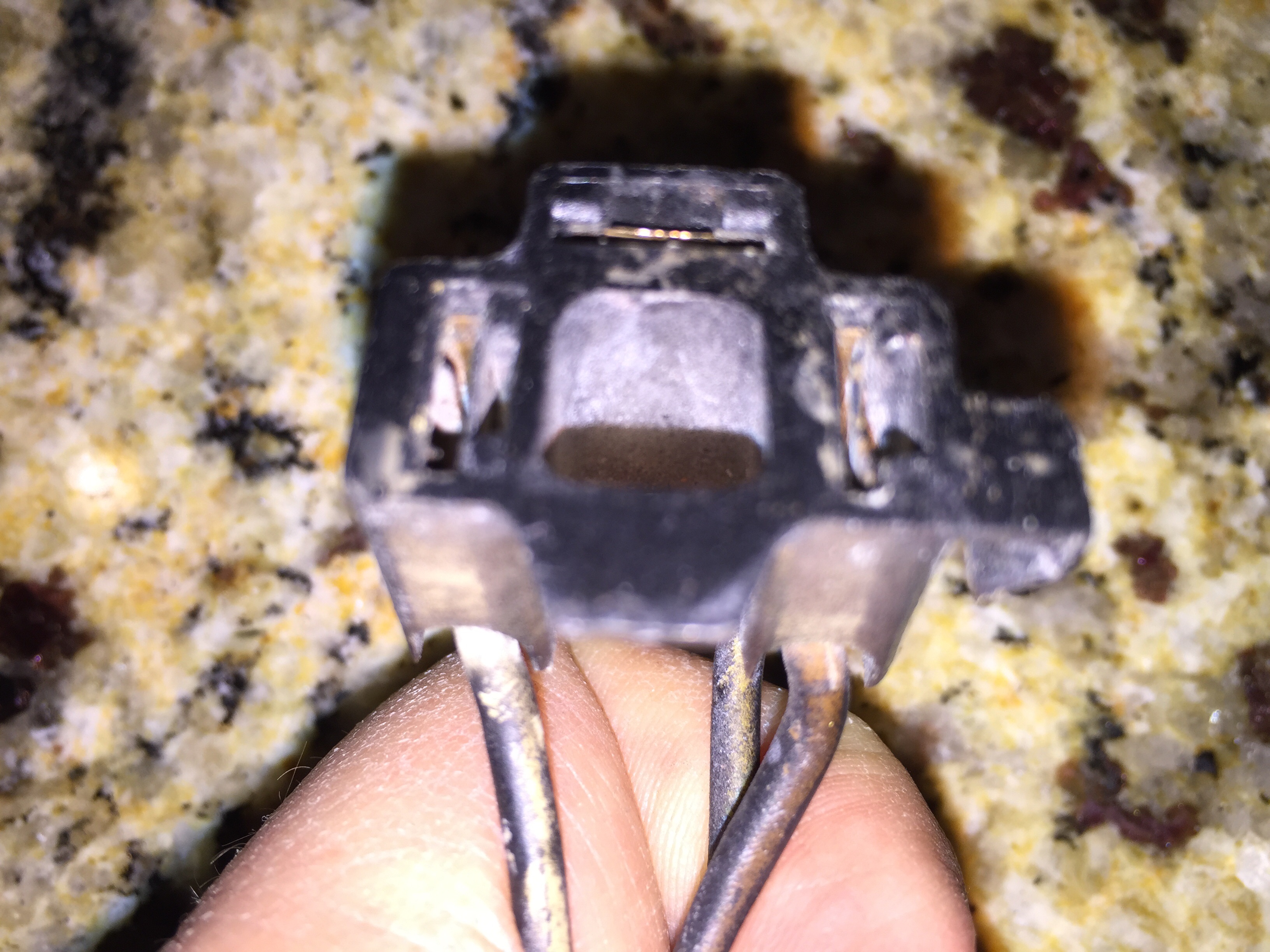

> How do I seperate the terminals from the plug
Harpo
post Dec 13 2014, 02:17 PM
Posts: 1,304
Joined: 21-August 11
From: Motor City aka Detroit
Member No.: 13,469
The terminals are loose in the housing but they will not come out. There has to be some kind of tool that will reach in to that special place

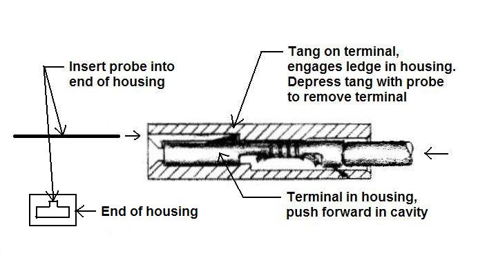

JeffBowlsby
post Dec 13 2014, 02:29 PM
Posts: 9,378
Joined: 7-January 03
From: San Ramon CA
Member No.: 104
Not all wire terminals have tangs, but for those that do:

Nice pic Jeff. Kinda says it all.
