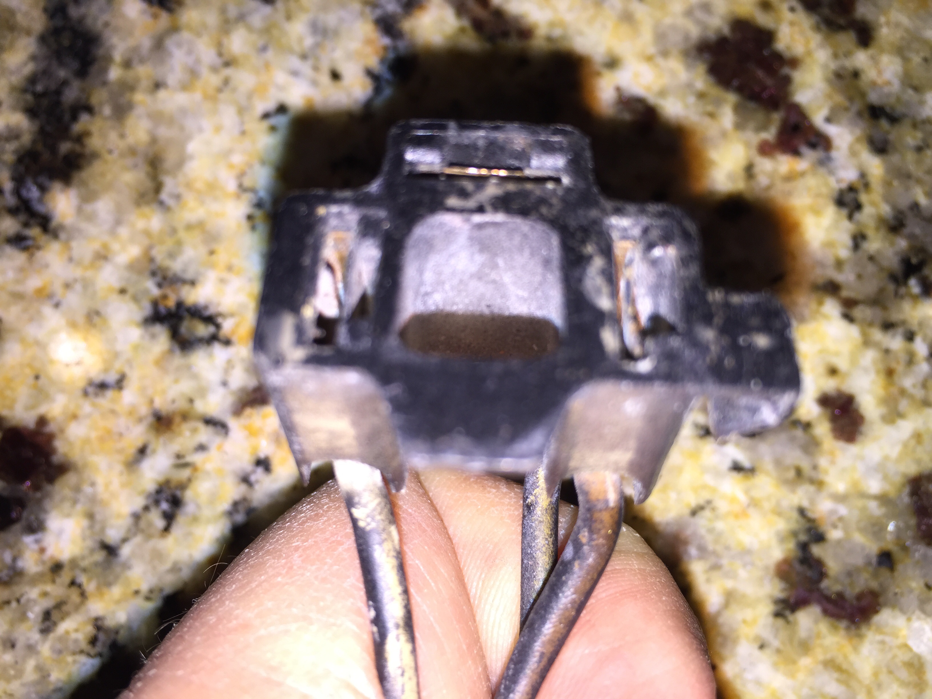

The terminals are loose in the housing but they will not come out. There has to be some kind of tool that will reach in to that special place
dlee6204
There is a small tab on the terminal that holds the terminals in place. I usually use a small screw driver or pick to push the tab in and free the terminal. You would have to stick it in from the front of the connector IIRC.
JeffBowlsby
Not all wire terminals have tangs, but for those that do:
toolguy
There is a little tab that bends up on the side of the copper connector. . It catches the lip inside the plastic housing. . There is a 'correct tool' to release them but a tiny jewelers screwdriver will work. .
Look inside and see where it is, insert the screwdriver and depress the tab until it passes the lip in the housing. . and pull out the copper connector. . If you have to force it, you don't have the tab depressed enough. . they come out easily.
bdstone914
On the flat side of the connector there is a tab that has to be depress to remove the terminals. I use a small paddle shaped dental tool to remove them.
You can make a tool by flattening a piece of thin stiff wire.

Nice pic Jeff. Kinda says it all.
