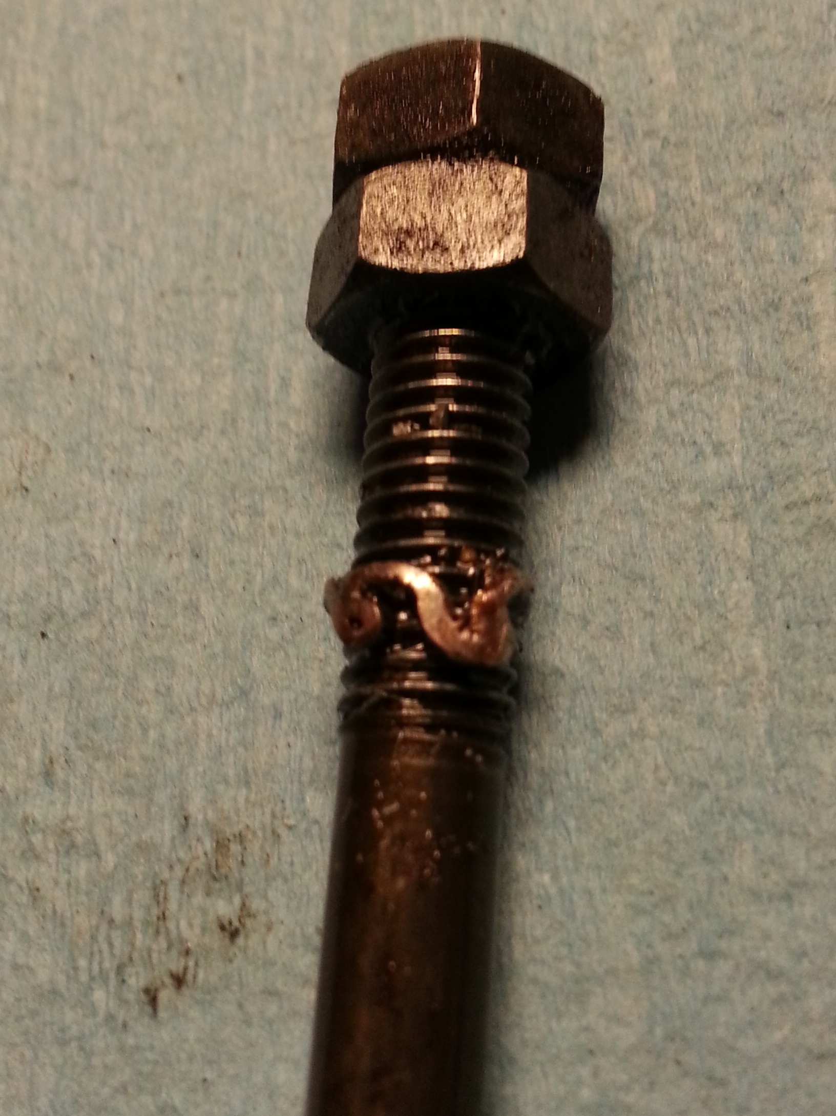

I finally got the case split tonight. I had to remove the stud I suspected was bent and the case opened up with no further issues (IMG:style_emoticons/default/piratenanner.gif)
But, the stud wasn't bent, it had something on it that prevented it from going through the hole in the case half. Anyone have any guesses at to what it could be. It's sort of copper in color and is stuck to the stud big time. It goes about 75% around the stud
(IMG:style_emoticons/default/WTF.gif)
r_towle
post Jan 13 2015, 09:44 PM
Custom Member
Posts: 24,705
Joined: 9-January 03
From: Taxachusetts
Member No.: 124
RTV copper form a gasket maybe.
veekry9
post Jan 14 2015, 12:15 AM
OldMember
Group: Retired Members
Posts: 3,068
Joined: 17-June 13
From: TO
Member No.: 16,025
copper wire,14-12 ga.
VWTortuga336
post Jan 17 2015, 10:46 AM
Posts: 285
Joined: 5-October 14
From: Kansas City, Missouri
Member No.: 17,979
I'm still wondering WHY this would be on the stud. Any theories? (IMG:style_emoticons/default/confused24.gif)
injunmort
post Jan 17 2015, 10:50 AM
Posts: 1,024
Joined: 12-April 10
From: sugarloaf ny
Member No.: 11,604
i have seen people use strands of copper wire as a homemade heli- coil of sorts when there is minor thread damage. not something I would, though.
