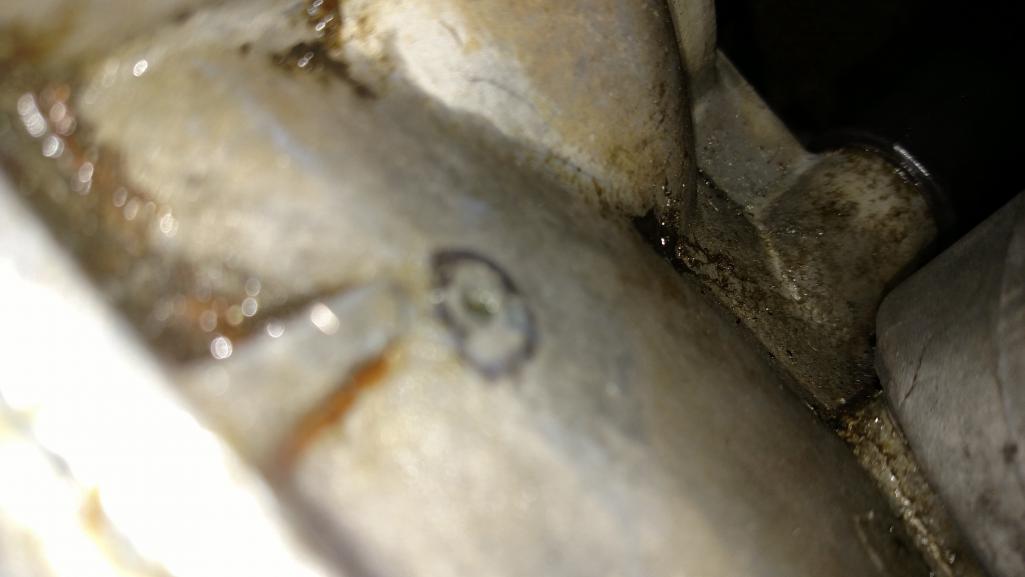

I have a tranny case leak that needs a repair. Here is a pic of the leak, which when warmed up is about one large drop a second.
I figure that I should do a real weld for the permanent fix, but would like to do a temp fix so I can drive over to my welder brother-in law about a 100 miles away.
So, what is the best liquid weld goop for this type of a hole (about 1-2 mm in diameter)?

Hank914   Here is a somewhat in focus close up of the hole. ...   Jan 11 2015, 11:53 AM

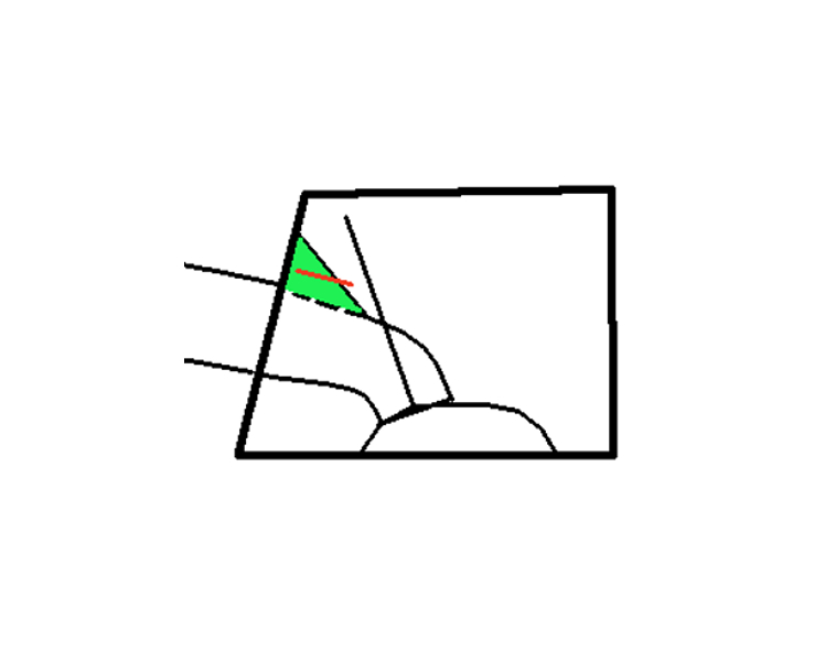

Dr Evil   A little back story... This is the replacement tr...   Jan 12 2015, 11:41 AM

Cap'n Krusty   Every one of these solutions, except maybe drillin...   Jan 12 2015, 11:45 AM
Dr Evil   I can verify, but a 1/8" or slightly bigger p...   Jan 12 2015, 11:56 AM
a few loose screws   You can patch a leaking case without getting it pe...   Jan 12 2015, 12:17 PM
CatDaddy60   I have a Case that ran afoul of a wayward axle sha...   Jan 13 2015, 06:27 PM
Dr Evil   For a small spot like Hank's, no prob to just ...   Jan 13 2015, 07:49 PM

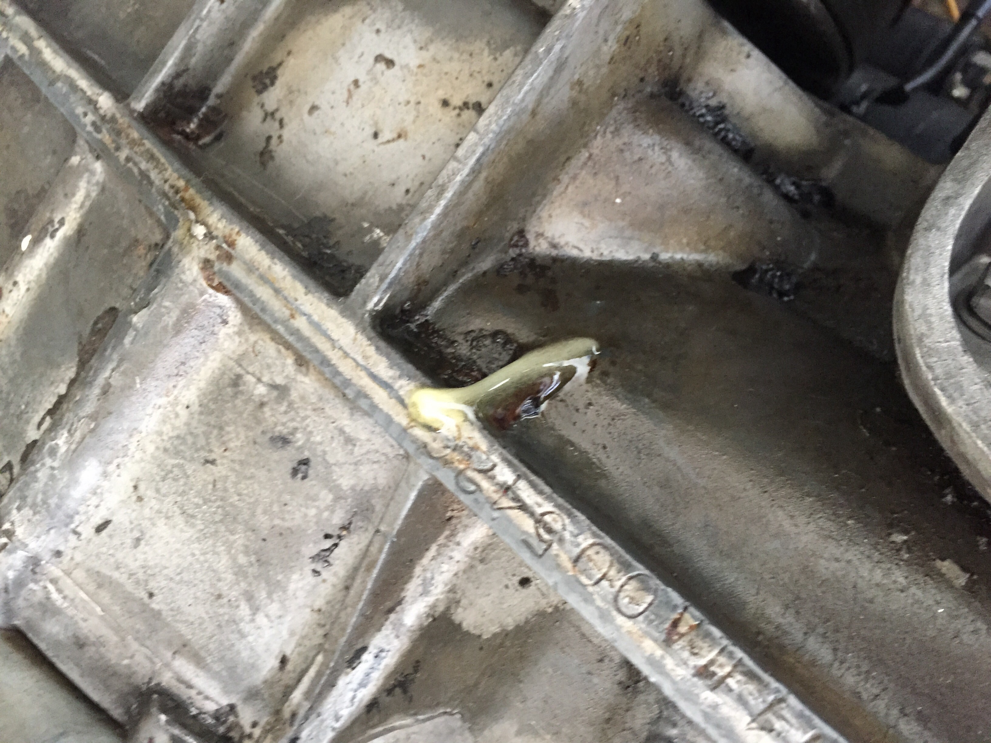

Hank914   Thanks everybody for the comments and advice. I w...   Jan 18 2015, 08:18 PM
Dr Evil   Looks great ;)   Jan 18 2015, 08:21 PM
Hank914   Pic after my repair job. I screwed in a metal scr...   Jan 18 2015, 08:22 PM
Dr Evil   Did it work? If it gives you issues, change to NPT...   Jan 18 2015, 08:28 PM
Hank914   And then I had to go have a few :beer3: while i...   Jan 18 2015, 08:29 PM
Hank914   So yes, there is some yellow, which is oil. But m...   Jan 18 2015, 08:30 PM
Dr Evil   Ya, that is why they use pipe tread on the plugs, ...   Jan 18 2015, 09:53 PM
