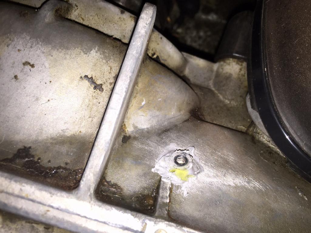

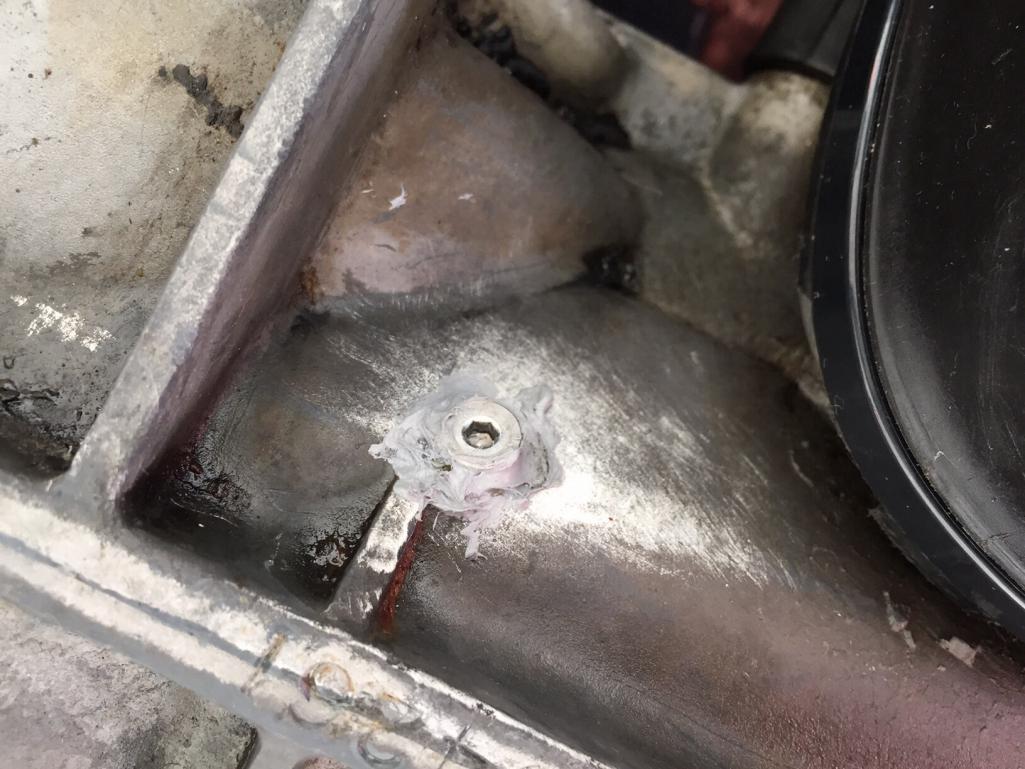

Hank914   Thanks everybody for the comments and advice. I w...   Jan 18 2015, 08:18 PM

Hank914   Pic after my repair job. I screwed in a metal scr...   Jan 18 2015, 08:22 PM
Dr Evil   Did it work? If it gives you issues, change to NPT...   Jan 18 2015, 08:28 PM
Hank914   And then I had to go have a few :beer3: while i...   Jan 18 2015, 08:29 PM
Hank914   So yes, there is some yellow, which is oil. But m...   Jan 18 2015, 08:30 PM
Dr Evil   Ya, that is why they use pipe tread on the plugs, ...   Jan 18 2015, 09:53 PM
