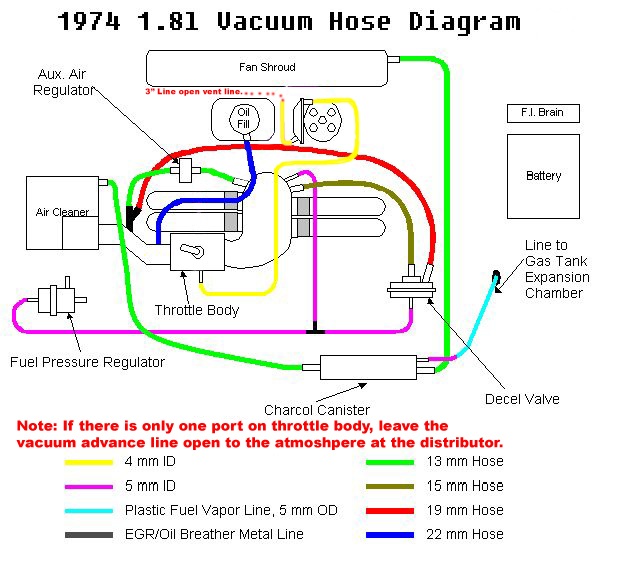

Does anyone have a list or can you point me to one for the vacuum hoses on a 1974 1.8?
As easy as they are to replace there are several different diameters (and lengths) needed and I'd like to buy them all with one purchase.
Thanks

Jeff lists the diagram on his site http://bowlsby.net/914/WiringHarnesses/

On Jeff Bowlsby's site: 1.8L Vacuum Hose Layout
Also below for ease
