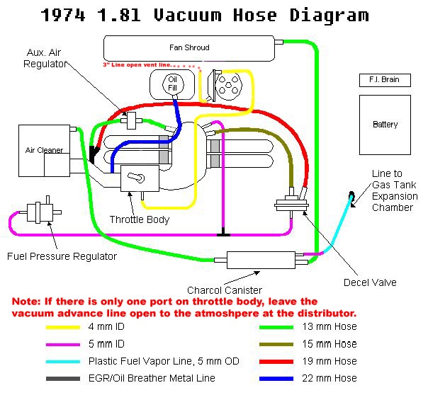

Does anyone have a list or can you point me to one for the vacuum hoses on a 1974 1.8?
As easy as they are to replace there are several different diameters (and lengths) needed and I'd like to buy them all with one purchase.
Thanks
Jeff lists the diagram on his site http://bowlsby.net/914/WiringHarnesses/
BeatNavy
On Jeff Bowlsby's site: 1.8L Vacuum Hose Layout
Also below for ease
