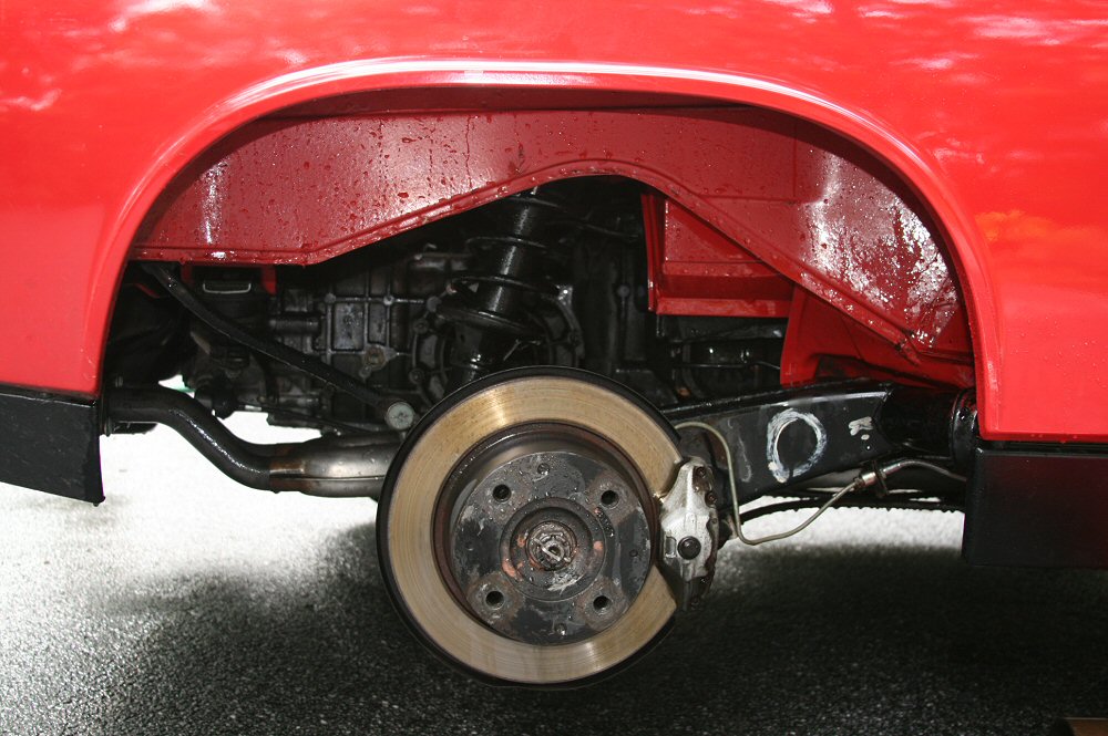

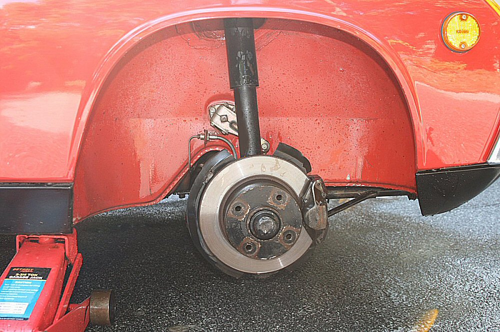

QUOTE(914Next @ Jan 16 2015, 03:43 AM) *
QUOTE(sixaddict @ Jan 15 2015, 09:48 PM) *
I have done more than one with heat gun and solvent + a plastic scraper...A real pain requiring patience but I love the look of body colored wheel wells.
So how many hours does one need to invest to do this right with a heat gun?? Hate the idea of solvents.
No one has commented on Dry ice blasting. Has no one tried that?
Most of it will come off with a heat gun and scraper but you're going to have to use solvent to finish up to get it looking really nice. I use thinners for the worst of what won't scrape off…degreaser which is less potent will work to a lesser extent.
I agree you'll need to use a plastic scraper to preserve the paintwork below.
I reckon you could do all four wells in a day…but it'll make a right mess!
YOU MUST WEAR A VAPOR MASK IF YOU USE SOLVENTS…I'm in the UK but one like this I found on Home Depot's website would work for small DIY jobs.
Vapor Mask
Good luck!

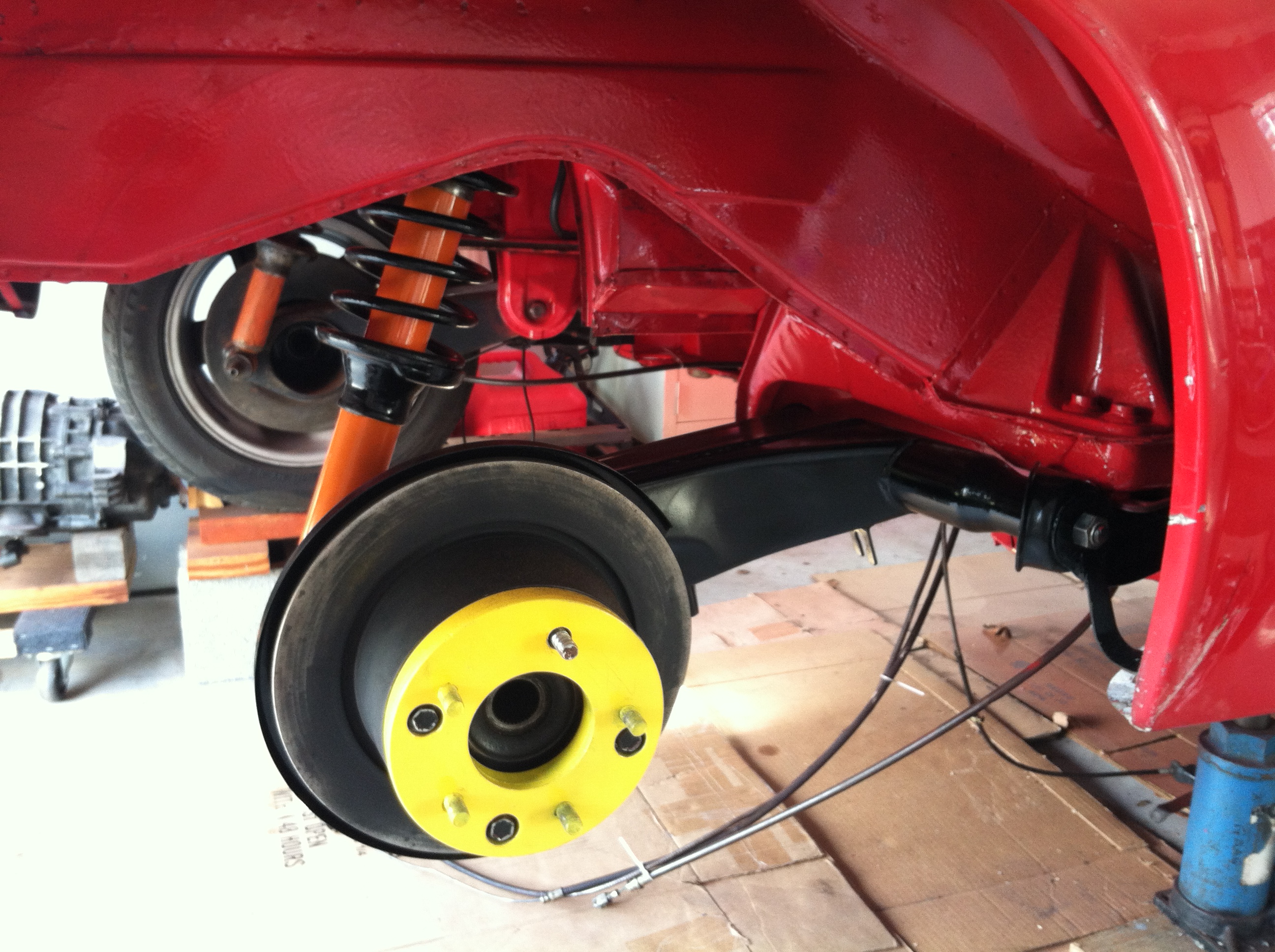

When i got my 76 it had rustproofing in the wheel wells kinda falling off, so some fairly easy work with a plastic putty knife exposed rather nice red paint. the car had been converted to wide body kit apparently some years ago. so the longs and jack posts were in very good condition. Everything else was red also except the underbody (belly pan) was in a darker brownish color and in good condition.
I like the clean look and the car will never see salt while i have it.
