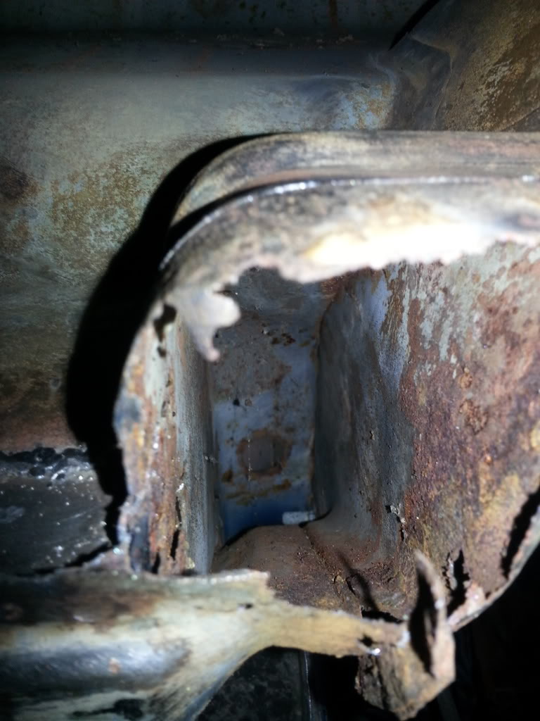

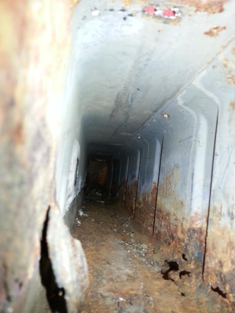

Here's the passenger side with the heater conduit removed...
IPB Image
And it goes beyond just inside the longs. I found it rust in the cavity formed behind the front wheel houses, under the dash. I also found rust inside the cross member in the rear trunk, although that was probably induced by mice urine. They were gaining access though the two quarter size holes.
