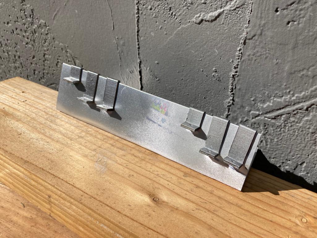

New white brake boards with comparison between black and white clips.

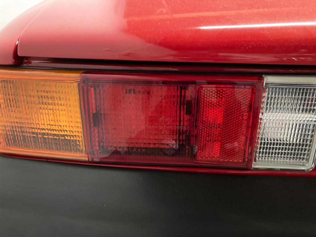

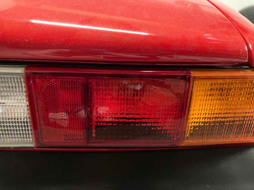

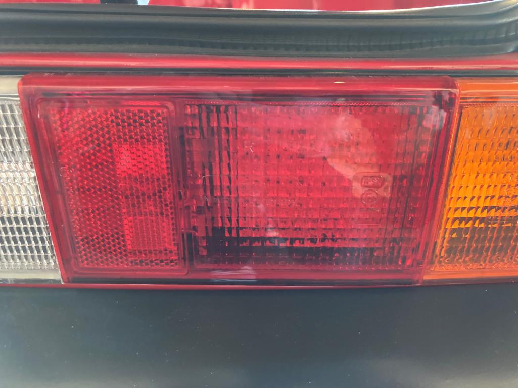

Comparison of stock setup (more black is visible at bottom of brake light bucket) and new white brake board with "silver" clips.
I tried a "chrome" paint on the LH clip set and a "flat aluminum" paint on the RH clip set. Both were better than white, but the flat aluminum makes the clips nearly disappear. You'd really have to know they were there—and look for them, too.
Into the weeds? Sure, but it might be interesting for those who want an appearance that's as close to factory as possible with a significant safety upgrade.

Nice job Pete. That takes an already outstanding product and improves on it. All of Spoke's lights are on my list. (IMG:style_emoticons/default/beerchug.gif)

Pete, thanks for evaluating this. I think the white filament will work for the front turnsignals with white PCB. I can get silver or gray filament for the rear lights.

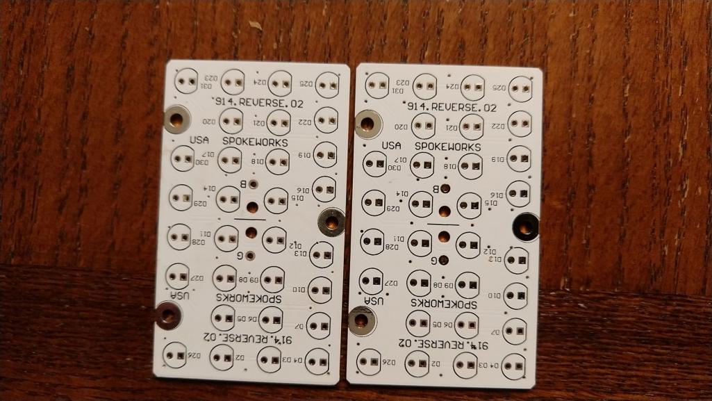

Now that I have brake and rear turnsignal boards in white, I'm adding reverse LED boards in white as well.

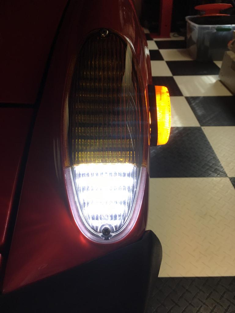

Eric,

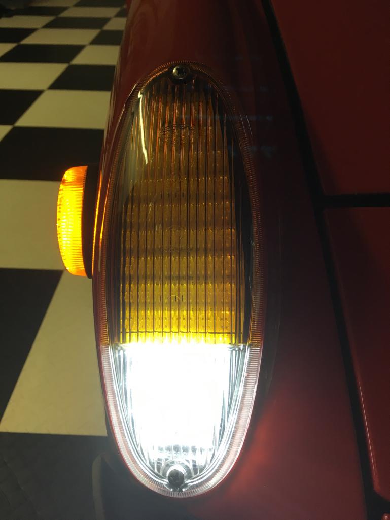

I'll take some better pictures this weekend. Here's what the difference will look like. The old boards had white lines and the new boards have a solid white appearance. The light output is about 50% more intensity.

@spoke - those look good.....may need to upgrade from the early version I have.

Are those on a white or black board?

The new white/amber front turnsignals come in both white or black. Instead of making one PCB that can be white/amber or all amber I've made 2 separate boards that are white/amber and all amber. This makes both boards simpler to assemble and the white/amber have twice as many (42 vs 21) white LEDs. The new boards are the same price as the old boards.

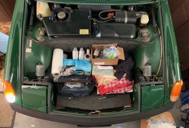

A small box arrived in the mail today (THANKS Jerry!) (IMG:style_emoticons/default/piratenanner.gif)
Version 8 of the front boards from Spokeworks.com.
Installation is easy-peasy--to the point I thought pictures unnecessary. The most difficult part was getting my big mitt into the front housing to install the base.
That said, here's a picture showing the new LED parking light (passenger side) compared to the old incandescent parking light (driver side):
And yes, they're both "on."
Best mod since I've done since installing Jerry's brake light boards! (IMG:style_emoticons/default/biggrin.gif)
