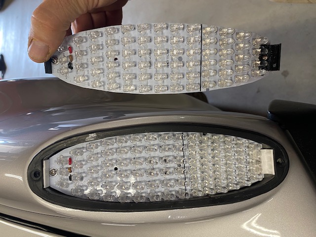

I live off a country highway so visibility of my 914 to other drivers is a big thing, got my little box too and updated my older version to the newer boards, check out the density of the white LEDs compared to the previous iteration, the pics do not do them justice:
Bravo @Spoke another winning setup! The white 3D printed parts are also a good move, makes the board even more seamless under the lens (IMG:style_emoticons/default/beerchug.gif)
