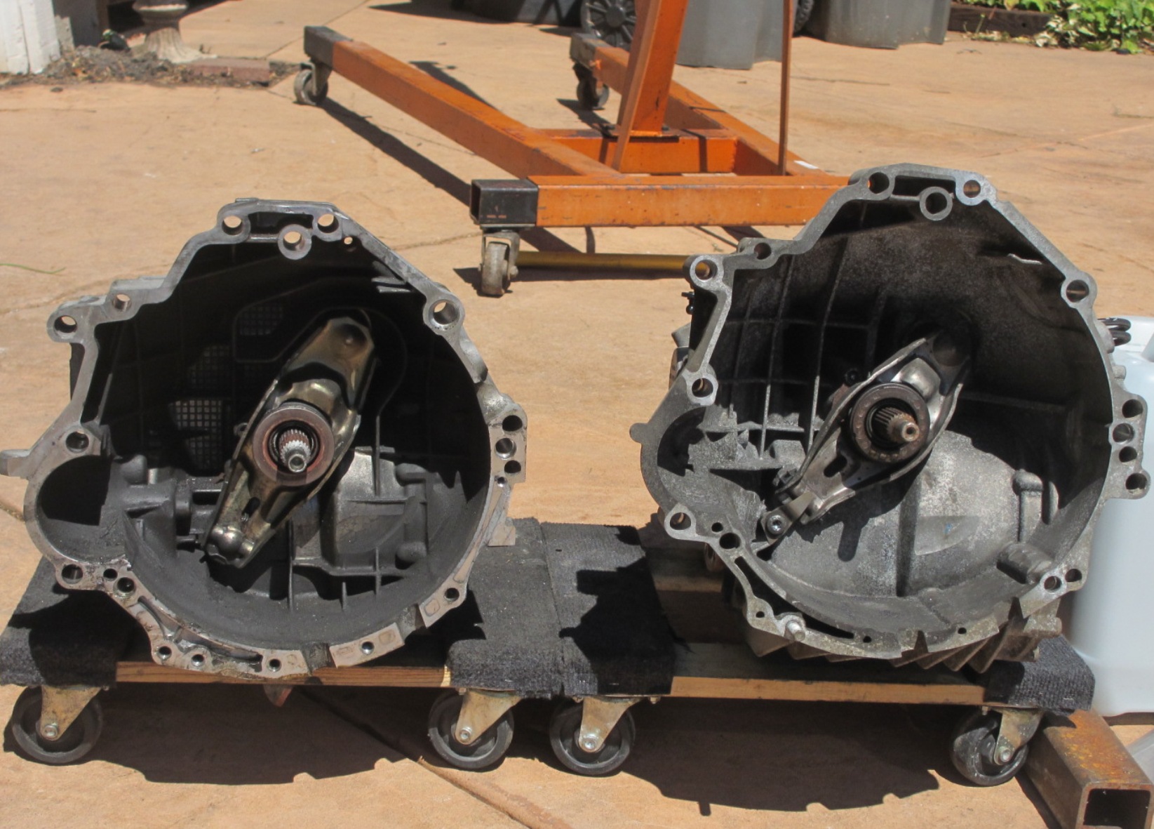

I found the 5 speed and was told its only got one bolt difference.
But I cant find the 6 speed or what bolt..
Anyone help ?
Anyone help ?
5 speed on the left, 6 speed on the right. This is a 2001-2008 Boxster S/Cayman S 6 speed. Other years have a different shape and bolt pattern.

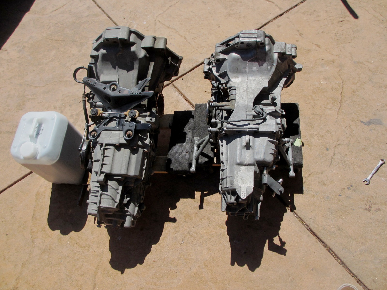

6 speed on the left.
6 speed is a 466 P/N
5 speed is an 012 P/N
