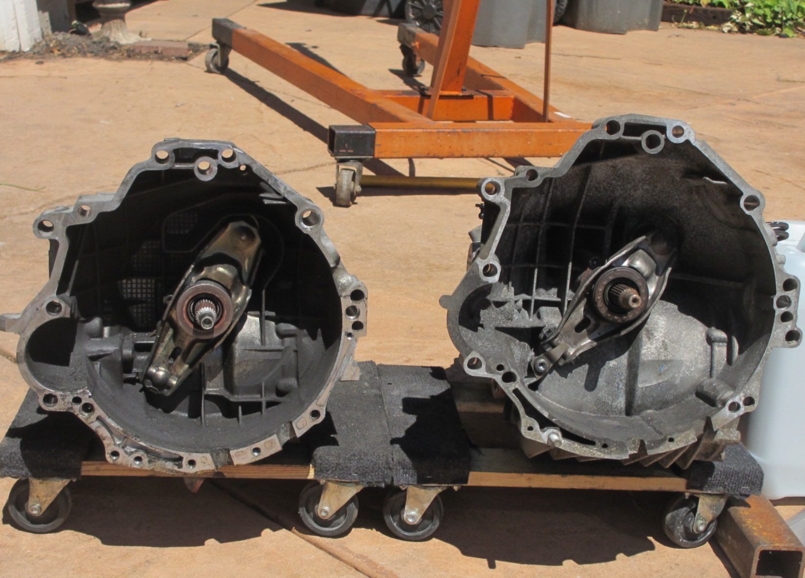

5 speed on the left, 6 speed on the right. This is a 2001-2008 Boxster S/Cayman S 6 speed. Other years have a different shape and bolt pattern.
How else can you tell the differences between the 2 transmissions ?

6 speed on the left.
6 speed is a 466 P/N
5 speed is an 012 P/N
