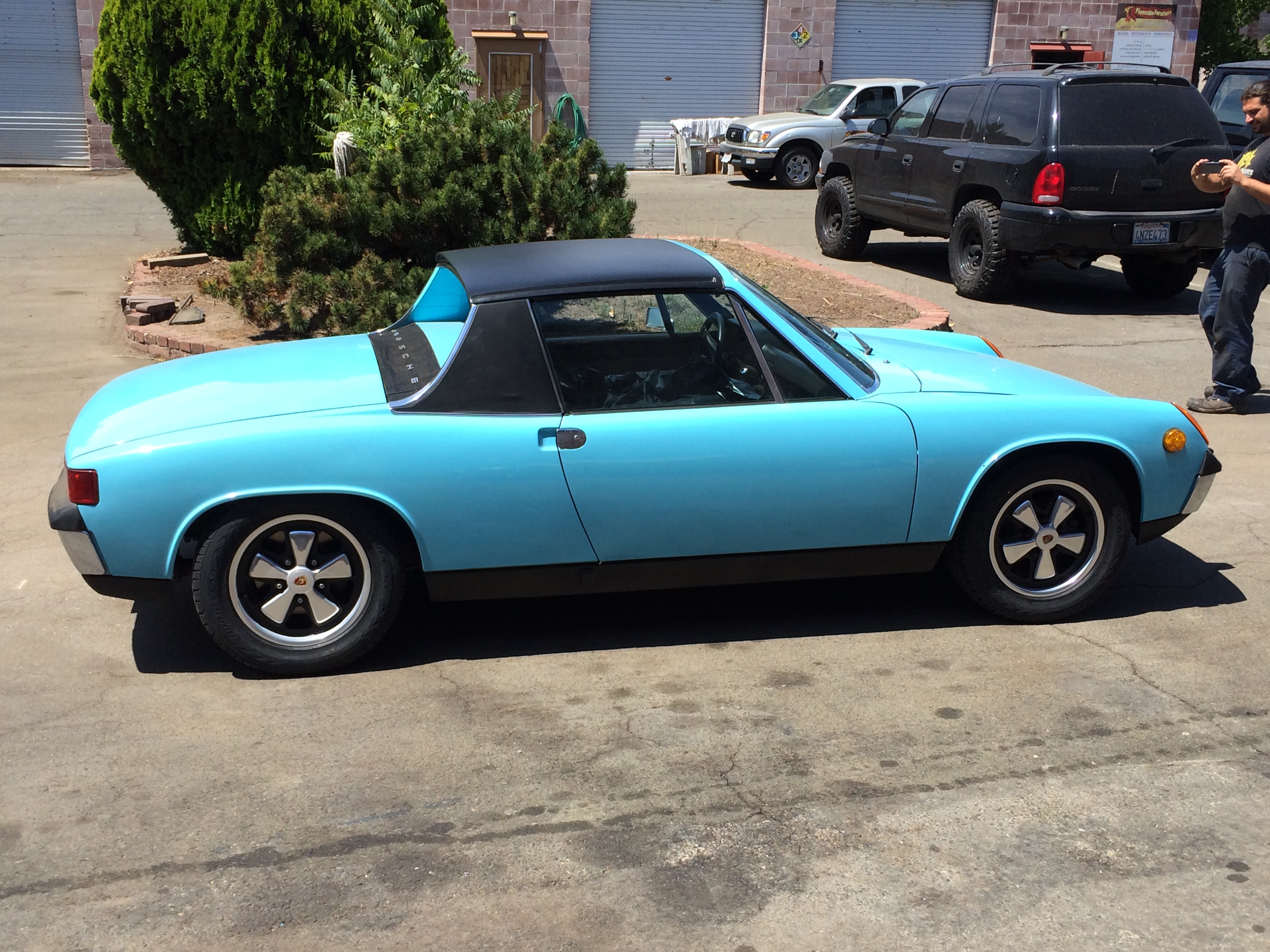

Mine fit just fine with 205/60R15 Goodyear Eagle GT tires. My Fuchs are part number 911.361.020.10 manufactured in 1975. Refinished by Harvey. Conversion to 5-lug done by McMark. No fender rolling and no rubbing.
