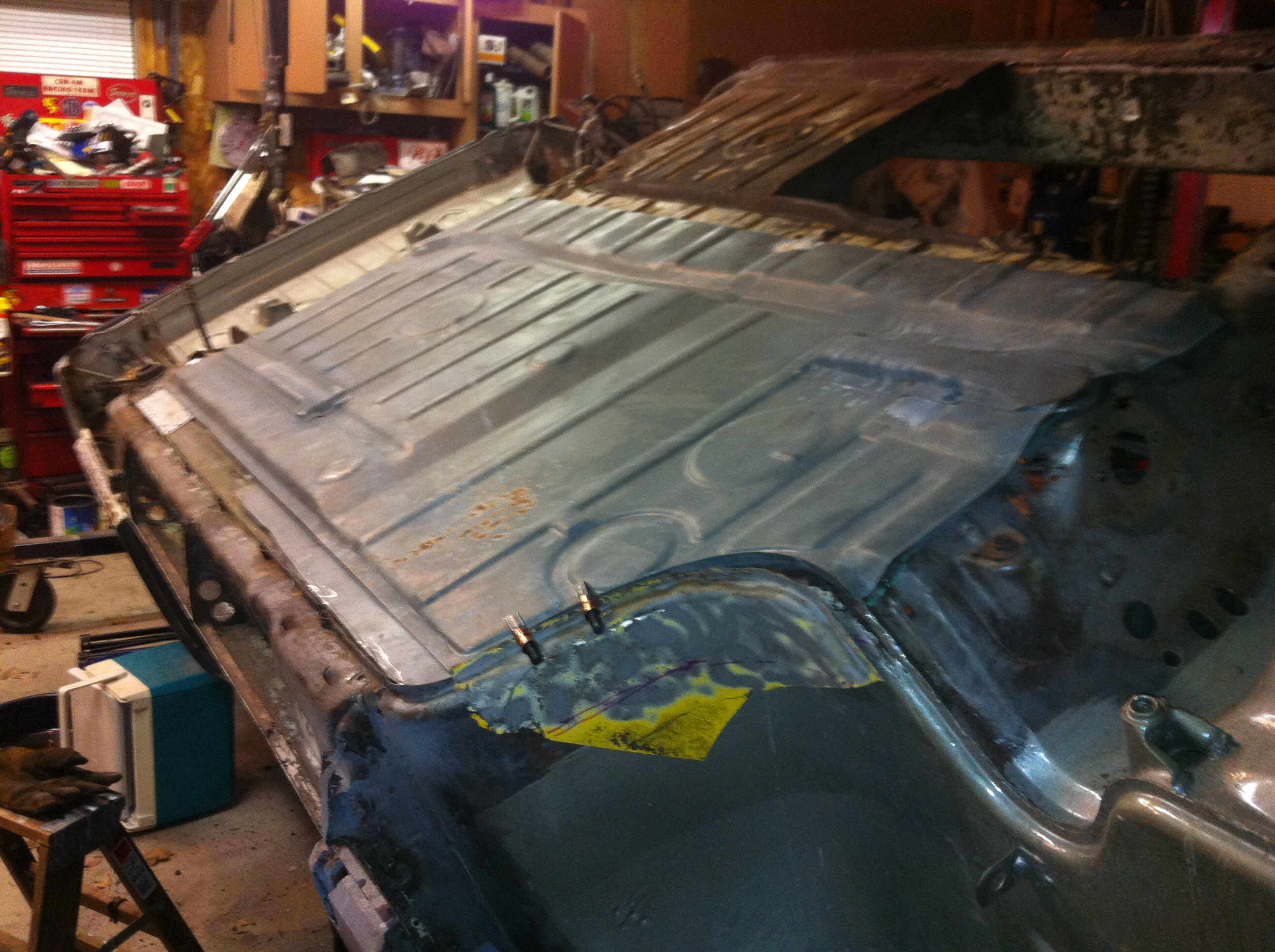

George (paintedman) I did find your link interesting on how you created your floor pans. What I was looking for is something like this
(IMG:http://www.914world.com/bbs2/uploads_offsite/i1.wp.com-18201-1421776816.1.jpg)
found it here
http://www.themetalsurgeon.com/2014/12/flo...olet-part-four/
Still think i'm on crack? let me know (IMG:style_emoticons/default/wink.gif)

I don't think you're smoking crack to consider it. But again, you will almost surely come out on top and end up with a much nicer/easier install with the pre-formed pieces. RD makes great stuff.
You could buy the rear section from them and see if you can sources the hinges and mounts from someone cutting up a parts car. That's what I did.
