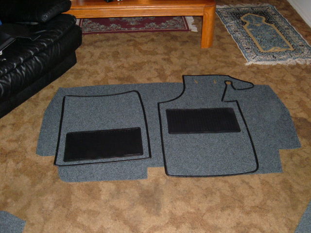

This is my back pad replacement carpet--doing away with the pad--I can tell you from looking at this that there is so pretty good sound proofing built in!!! (IMG:http://www.914world.com/bbs2/html/emoticons/beer.gif)

(IMG:http://www.914world.com/bbs2/html/emoticons/smilie_pokal.gif) Awesome deluxe carpet !!!! (IMG:http://www.914world.com/bbs2/html/emoticons/smilie_pokal.gif)
