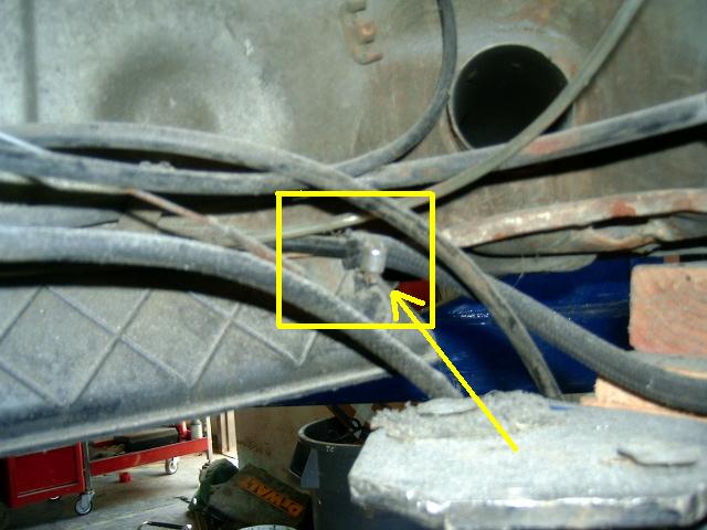

> Found something interesting, But probably really bad
Allan
post Feb 5 2005, 05:19 PM
Teenerless Weenie
Posts: 8,373
Joined: 5-July 04
From: Western Mesopotamia
Member No.: 2,304
As I was cleaning up the engine bay I starting looking at the fuel lines and found this. Any ideas on a fix without having to replace the center tunnel lines?
It's the line that comes out of the firewall on the left.

(IMG:http://www.914world.com/bbs2/html/emoticons/wink.gif) Replacing those lines in the tunnel is actually very easy--Just remove your shifter-and the other access plates so you can get your hand in there-and your splash pan on the front crossmember---and feed in a new section of metal line---
This is a good thing to do anyways--that plastic line that has been in there for the last 30+ years is ripe for replacement anyways--

I couldn't find the pelican article on fuel line replacement. Anyone have a link?
Thanks

Rage--it is very straight fwd--you should not encounter any problems with it at all--use a thin walled metal tube so it will bend somewhat easily--when you disconnect the rubber lines from the tunnel lines--on the front ones --pull of the big rubber grommet holding the metal parts of the plastic lines--then from the back just pull--they come right out--to reinstall-pull your interior access plates and the shifter so you can bend the hold tabs--it would be best to have two people doing this--one pushing in the new line from the rear and one in the car guiding it along--it really is easy--good luck! (IMG:http://www.914world.com/bbs2/html/emoticons/beerchug.gif)
but not copper piping....i heard it sheads/flakes off bc of the gasoline? Not to mention the work hardeneing of the copper....

You are correct--copper is not a good way to go--with all the vibration in the car it will work harden and crack--only specially made alloys of copper are good for this---gas really has no effect on it--it is also very soft and the hold down tabs will work thier way thru it from minut vibration--

Mc Master Carr industrial supply shipped me some Nylon 11 tubing, which is great for the fuel system. Nylon 11 is flexible, and gasoline resistant. I think the original is a Nylon, it will last a long time, however it is readily attacked by sulfuric acid (battery acid)
They offer both metric, and inch tubing at about 40 or 50 cents a foot Althought the 8 mm is the exact fit, I choose the 5/16 inch (extremely close size, not really noticable, and besides, thats what my rubber fuel hoses are, 5/16 inch) I choose this, cause the metric size only came in colors, including white, the inch size came in a natural non-pigmented nylon color (transluscent white) It is listed as drinking water grade, as it has no pigments to leach out, the colored ones would hide any dirt that you otherwise might detect in the translucent line, and I think the natural nylon likely is more like what the factory line might have looked like when new.
I am not doing the tunnel lines, as they seem fine, but the ones from the firewall out are getting re-done in new Nylon 11
Hey, in the photo, is that a standard cloth braided Low pressure fuel hose I see? If that is low pressure, it cannot be used on the return line, only the supply line up to the pump, If you have a front mounted pump all lines back from the pump MUST be high pressure Fuel Injection grade hose.
Only the supply to the pump is at low pressure, however, it is pretty well accepted those cloth braided lines tend to be cheap, and rot fast, so use all the good stuff high pressure FI hose thru out you car. I even do so on my low pressure carbed Spitfire and Bug, The FI hose lasts much longer. The regular hose is unsafe on a FI equiped car, do not use it in that application.
