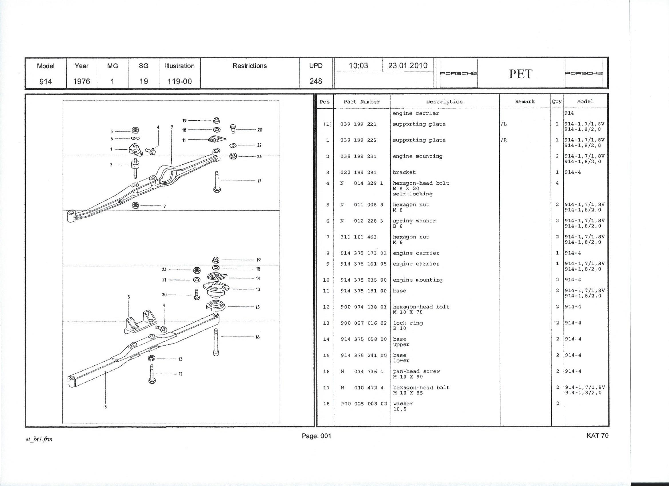

Here are the two type 4 engine bars, late model side shift above, early model tail shift below.
