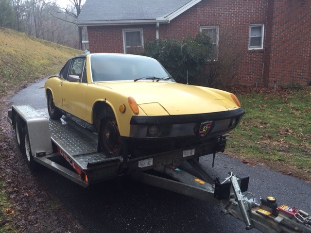

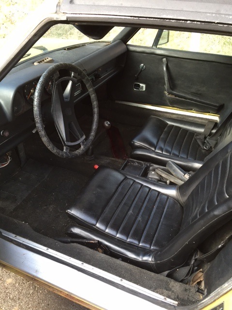

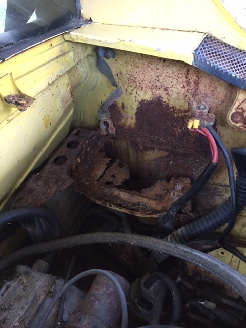

I thought I would share my most recent project. I picked this car up a couple weeks ago on craigslist. It's a '71 w/ 78K on the clock. It's definitely in project form but one thing that I liked about it is that it is pretty original and unmolested... no goofy PO repairs, all stock parts, relatively low miles plus I love the early style 914 w/ steelies (IMG:style_emoticons/default/wub.gif) . Its been stored in a barn for many years. It does have some rust but its fairly manageable which is pretty good for East coast standards.
The plan right now is to keep it all stock and just create a nice original driver.
Bringing it home...

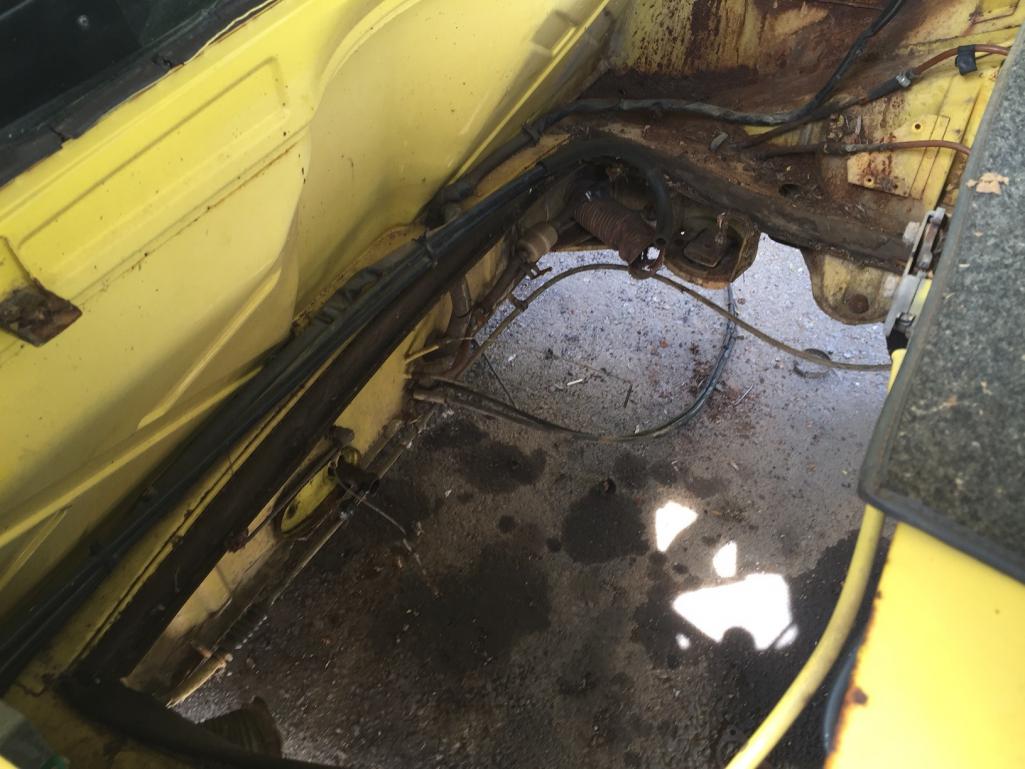

The battery tray has some light surface rust

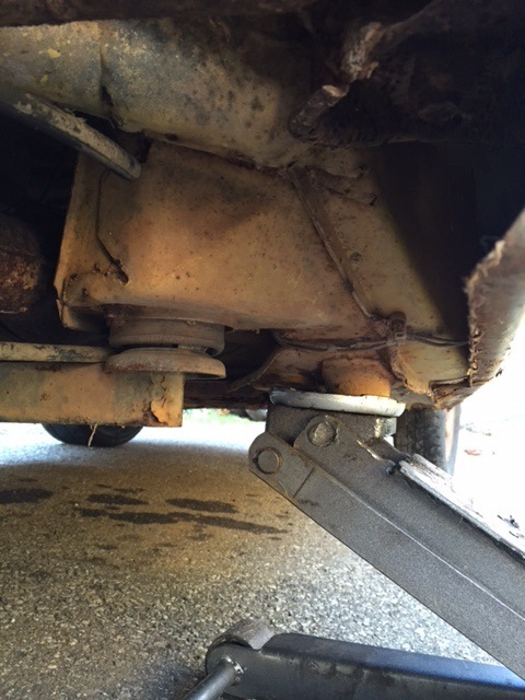

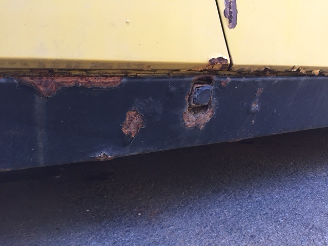

Here's the underside of the passenger long. I was able to jack the car up and door gaps didn't change (IMG:style_emoticons/default/piratenanner.gif) .... Heck, most 914s I bring home don't even have a place to jack it up anymore.

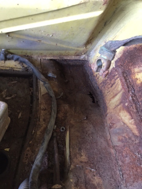

dlee6204   Tonight I removed the battery tray and cleaned out...   Jan 29 2015, 07:22 PM

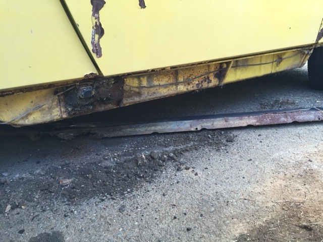

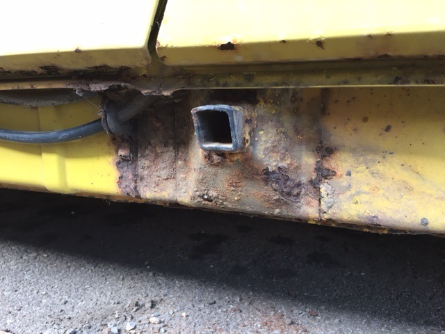

dlee6204   Today I pulled off the rockers to see what was hid...   Jan 31 2015, 08:00 PM
dlee6204   The driver side will needs a little more work. Wh...   Jan 31 2015, 08:03 PM

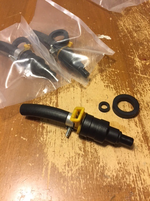

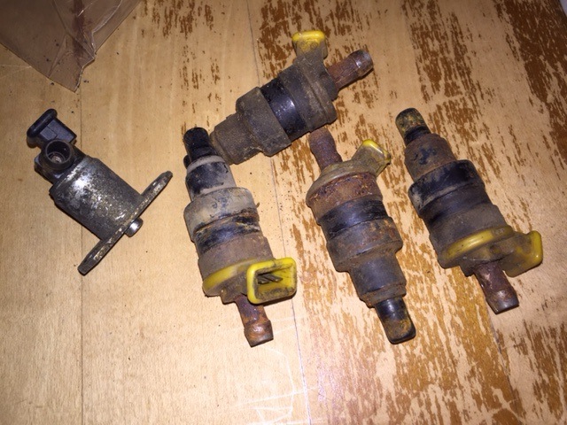

dlee6204   This week I also got the injectors sent off to the...   Jan 31 2015, 08:07 PM

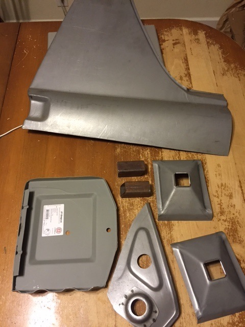

dlee6204   I got a package from Restoration Design today. :...   Feb 5 2015, 06:18 PM
dlee6204   I also got the injectors back from being cleaned. ...   Feb 5 2015, 06:21 PM

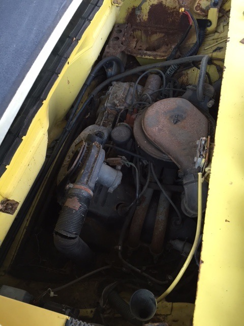

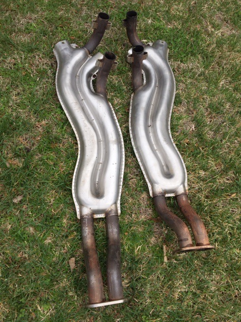

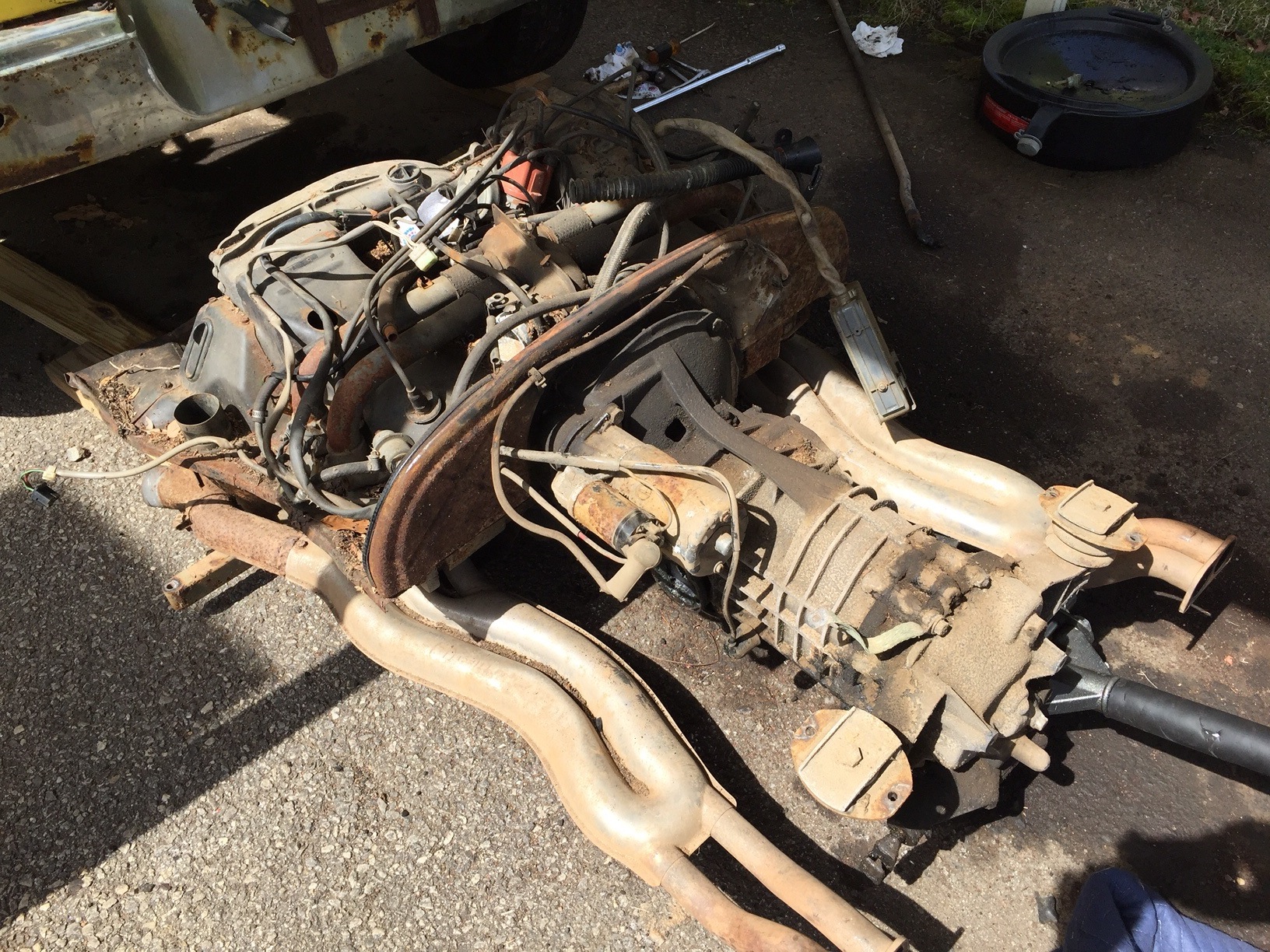

dlee6204   I finally found time to pull the motor and started...   Mar 22 2015, 07:10 AM
914Sixer   Looking good! I like the OE muffler look.   Mar 22 2015, 08:15 AM

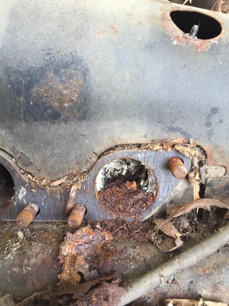

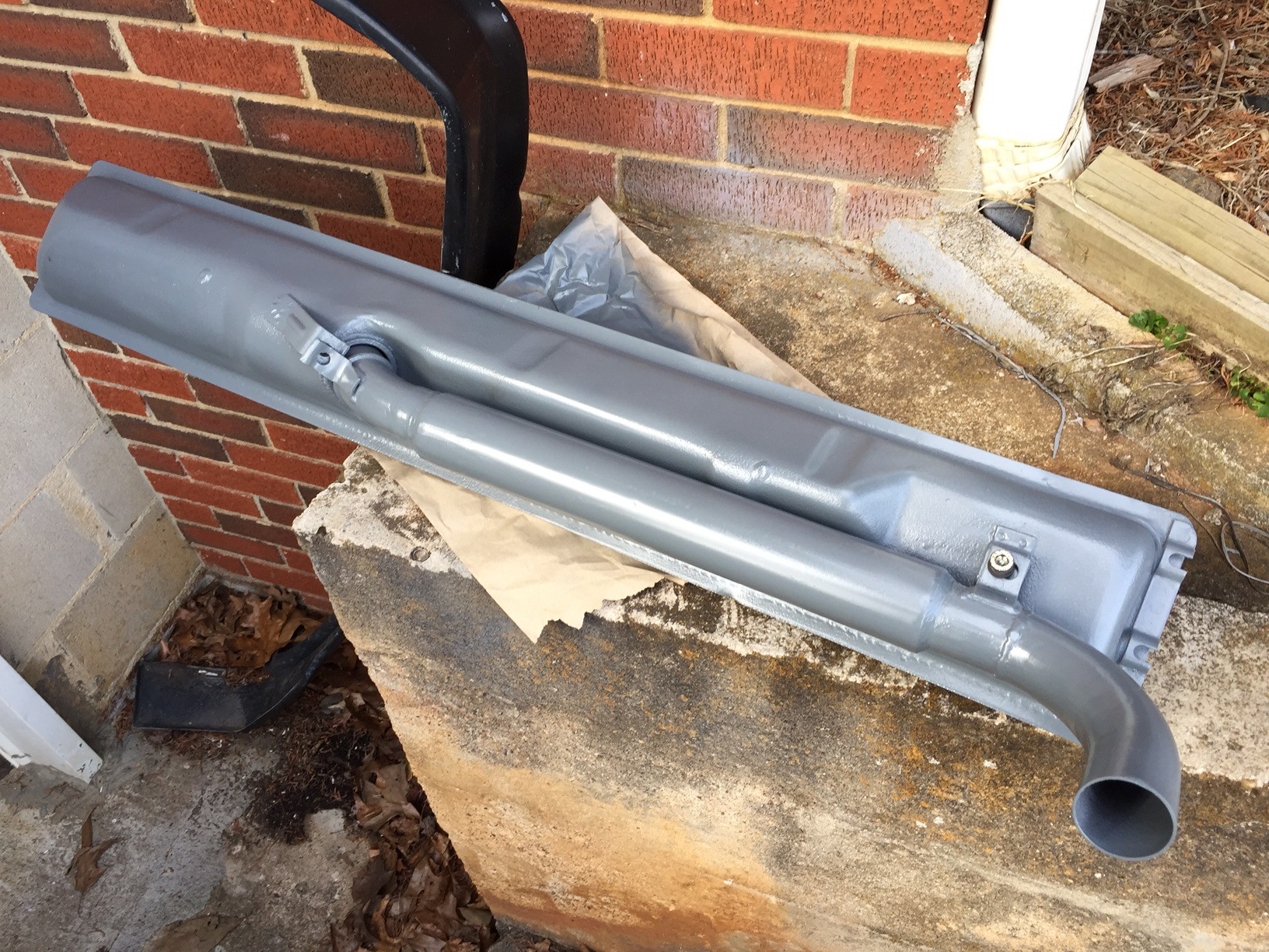

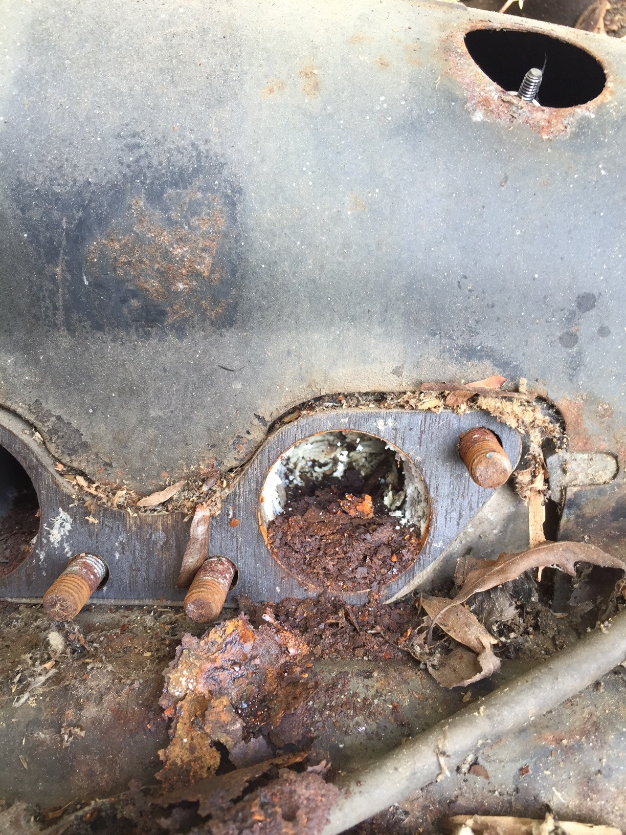

dlee6204   I cleaned up the heat exchangers yesterday. They ...   Mar 23 2015, 06:51 PM

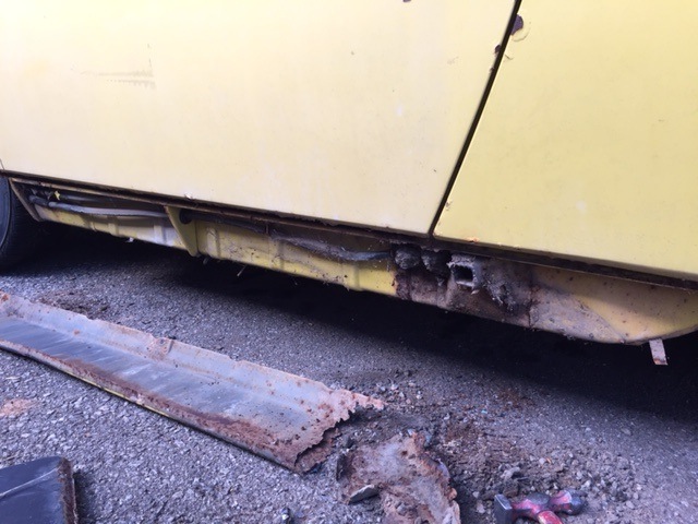

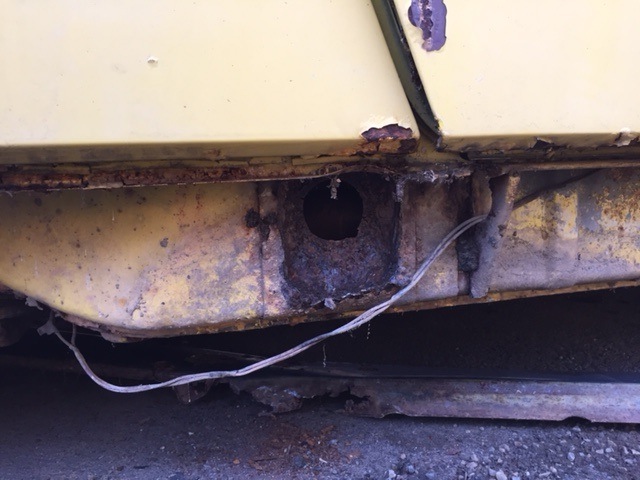

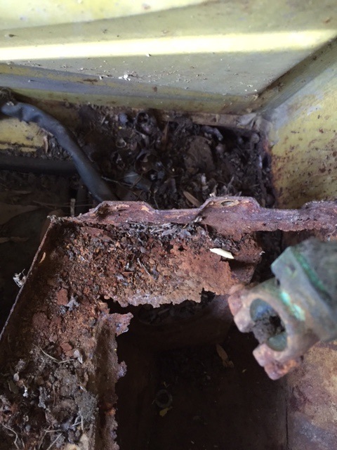

dlee6204   Well I started digging into some of the rust over ...   Mar 30 2015, 06:22 PM

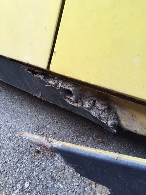

dlee6204   I also found some previous bodywork damage on the ...   Mar 30 2015, 06:23 PM
