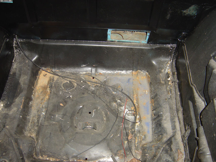

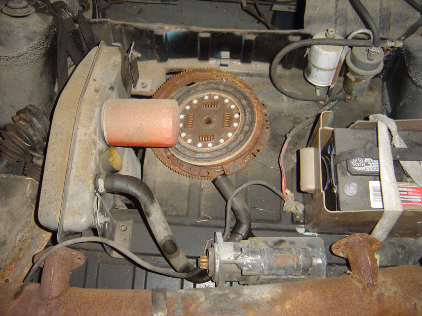

Ok, I went and looked at the car. It does have some bubbles in the paint and some extensive body mods like I have not seen before. It looks like someone did a sorta 6 conversion on it but never finished. Crappy job to top it all off. Lots of rust in both sides of the engine compartment and a big hole through the long under the battery. Here are the pictures I took, you be the judge.

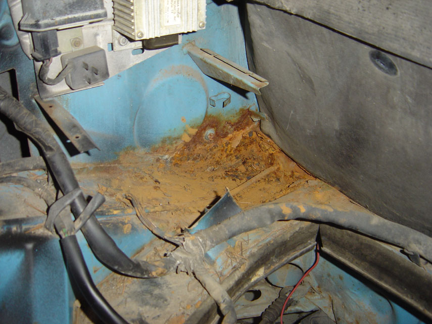

As you can see it was blue. Olympic blue to be exact. Here is some rust pictures you all should be familiar with.

I have seen worse. Both sides are very rusty.

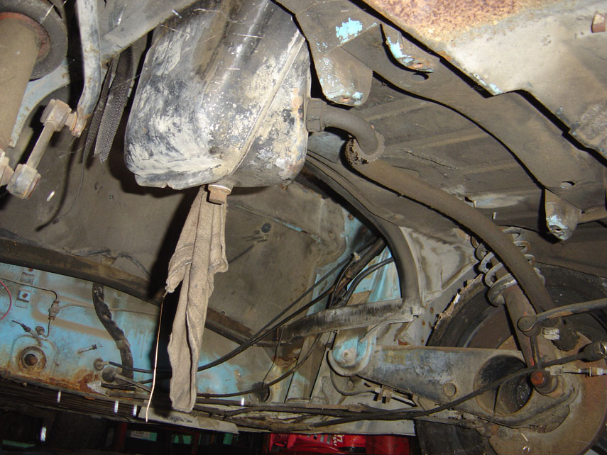

Rear trunk filled with ? Is that a 6 tank? Or is that a 911 tank? Either way, its in the wrong place. Goes right through the floor of the trunk and hangs down below the car.

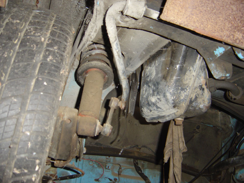

You can see the tank underneath. I also noticed rear factory sway bar.

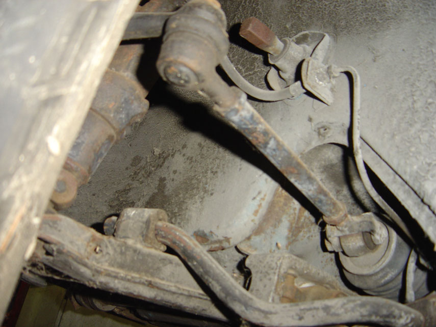

The front, Through the spiderwebs you can see a 911 underbody sway bar. I also noticed a factory front sway bar with no drop links.

The pic showing the front sway bar
