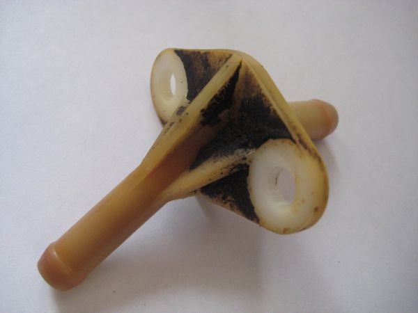

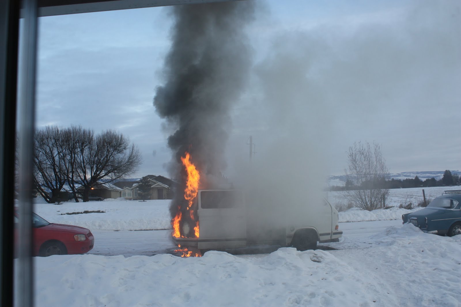

Mike, if you haven't already done so, think about getting the metal fuel line pass-through for the rear firewall bulkhead
... the OEM plastic ones are a potential fire hazard (IMG:style_emoticons/default/sad.gif)

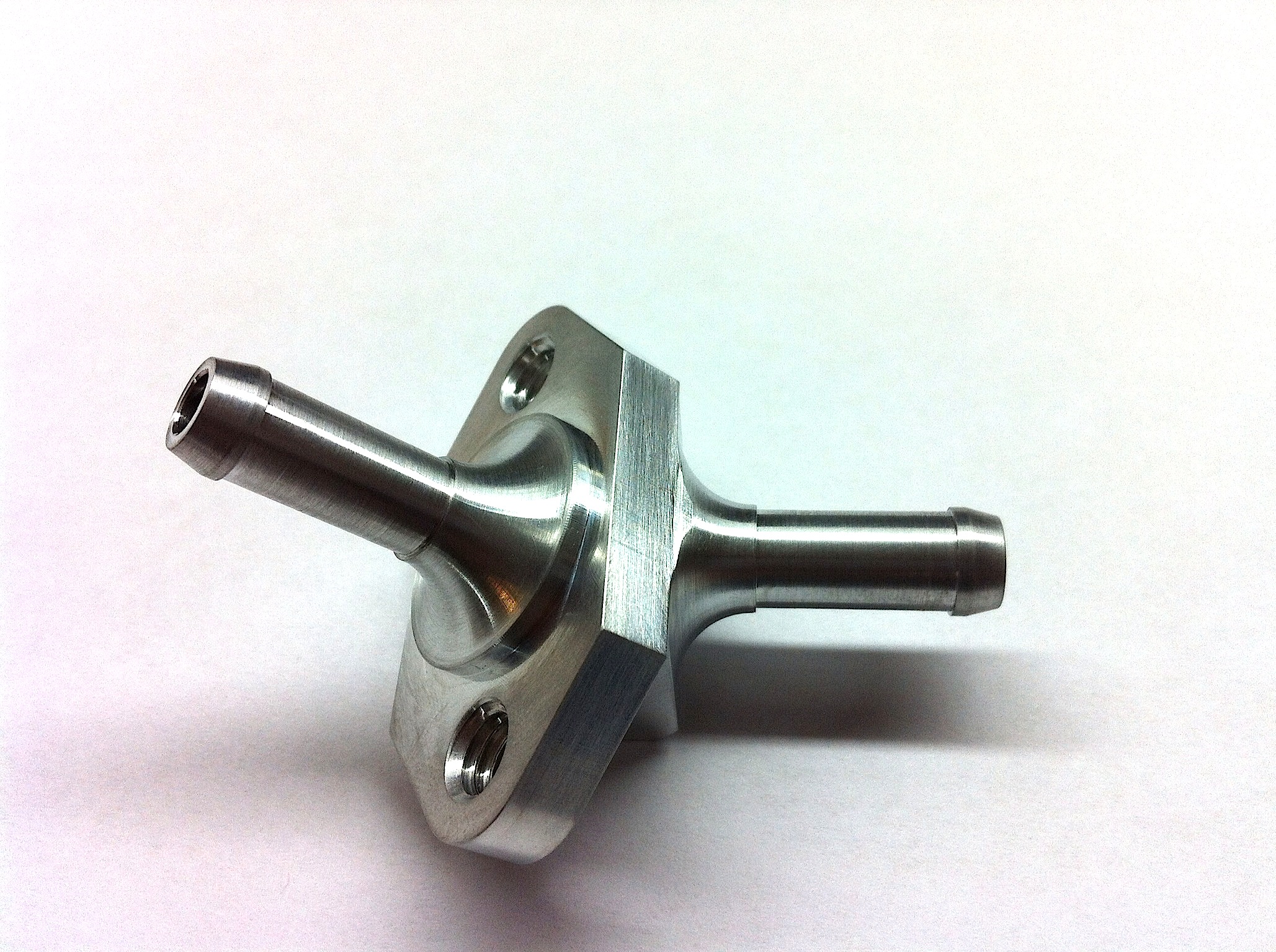

Wow the metal fuel thing is a work of art. Nice looking part! Where do you get that?

Chris, the part is called a fuel spigot, available from Foreign Auto Supply for $60. - CLICK HERE

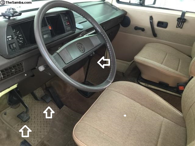

PS - less chance of pedal confusion too with the wider set clutch & brake, vs. the typical Euro car layout (& domestic compacts), but close to the old school 1950-80's Detroit full & mid-size car pedal spacing.
PSS - In re-reading your post, there are shift point adjustments for the auto without tearing the auto apart, as you'd been told/read - that's just BS or over-kill or lack of knowledge. We did go thru a couple of rounds of those adjustments with my long time mechanic (40 yrs.) after the trans rebuild, just to get it shifting when & how we liked it. So that also is not a valid reason to shy away from the autos. They're pretty bulletproof & generally longer lasting than manuals to needing a rebuild (the manuals' synchros often need replaced at 120-150k), & the mph & mpg losses are only a couple of miles for each. It's really NOT an issue for a qualified & knowledgeable mechanic! Get an auto if you prefer, or a manual, or whichever example is best condition - auto or stick.
PSSS - Also somebody did a very nice job on the Wheelskins on that steering wheel in your pic!

Lots of plastic in the Vanagon. Check out the fuel rails. I am going to replace mine with 914 metal ones. Although I have never heard of a failure.
Also the cooling system thermostat housing is plastic and fails. Billet versions are available.
The main coolant lines are all plastic and fail. SS ones are available.
I like this billet fuel line part. Has anyone heard of the plastic part failing?
Percentage-wise (IMG:style_emoticons/default/confused24.gif) ... but why take a chance?

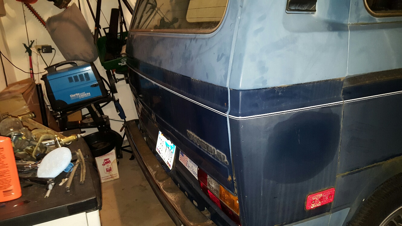

Well, I had to look a long time to find a really homely example but here it is!
BTW that stuff above the wheel arch is MOSS! SERIOUSLY!
So I almost bought one recently that was repainted and needed to be put back together but just couldn't spend the dough. For some reason this one kept poking at me. It had been sitting and needed attention but was allegedly "rust free". So...I pinged Garold and traded some stuff out of my parts stash for a few hours ride out and home with this little piggy. It really has almost NO significant rust. In addition to the usual exterior areas, even the battery area is like new. The odometer says it has 400 THOUSAND miles on it. Have to think it was towed or something. I'll post more pics later. The inside is not bad at all. Outside is a little crusty. It's from south Texas apparently. It needs a water jacket but I plugged a battery in to it and it turned over. As much as I would like to convert it, I might just try to get it running and drive it for a year.
BTW these things are heavy as &(*&! I'm used to cars that weigh 2000+ lbs. We had to get pretty creative to get it off the trailer. And we swore a lot which helped.
Have to say I really enjoyed the journey more than usual. Garold is a great guy to hang out with. As usual he had many cars to gawk at and tons of parts.
Thanks again Garold for a fun couple of days. I admire your commitment to Mom Shaffer, of Moms Service Covers fame.
BTW it's an '84. So I'm learning it will likely need new coolant tubes. Has the lowly 1.9L with 4 speed manual. Interestingly it has a hydraulic clutch. Didn't expect that for some reason. Also interestingly the pedal doesn't move at all (IMG:style_emoticons/default/biggrin.gif) . The brake pedal moves plenty though. Like...effortlessly. Doesn't DO anything but it's easy to push. That's OK. I would have gone through everything anyway.

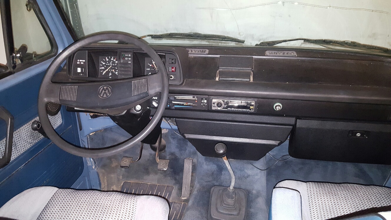

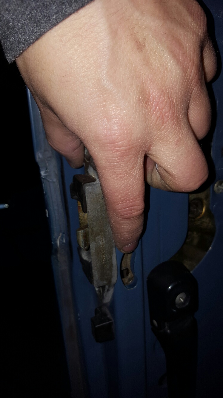

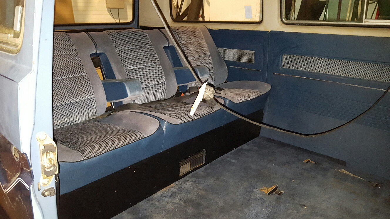

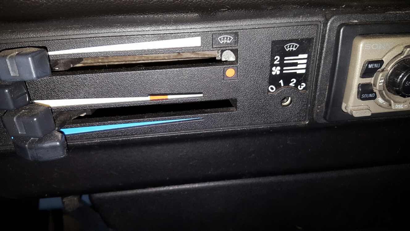

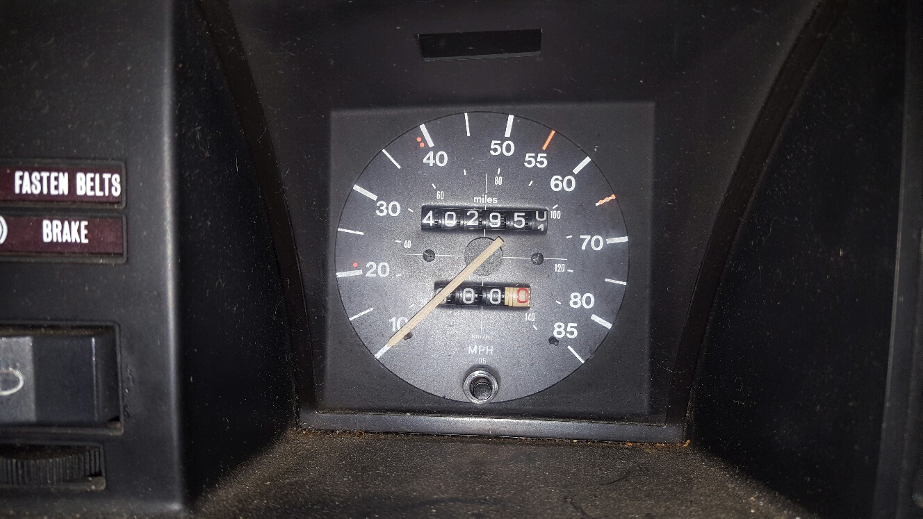

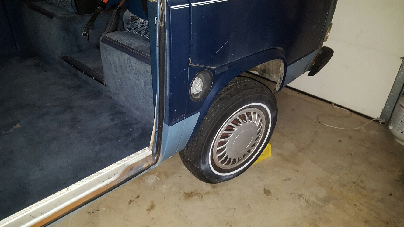

Hey thanks Marc! Here are some more pics and then I'll tell you my thoughts, plans, etc. Would love some input.
Battery area (which is under the passenger seat)
Front
Steering wheel is larger in real life
yes, that is 402XXX
This knob has been pilfered:
Rear seat nice, middle seat is missing.
The lock pin for the sliding door is missing on the inside
And the outer door handle is snapped off. Pot metal.
The wheel covers have to go pretty quick. Would like to go 16X7 rims
If I was in to the patina look...this would be an easy one to just shine up
