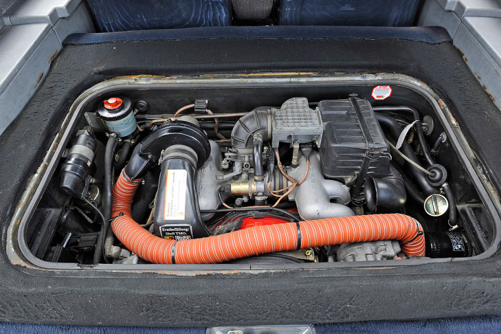

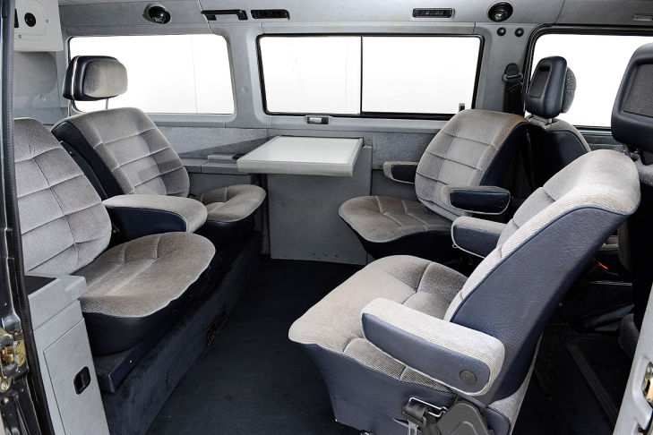

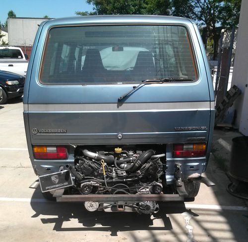

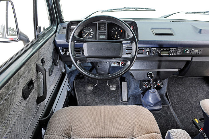

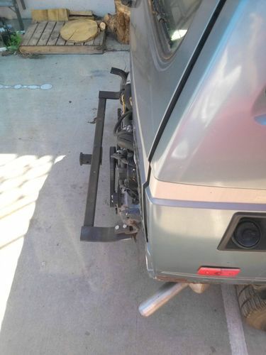

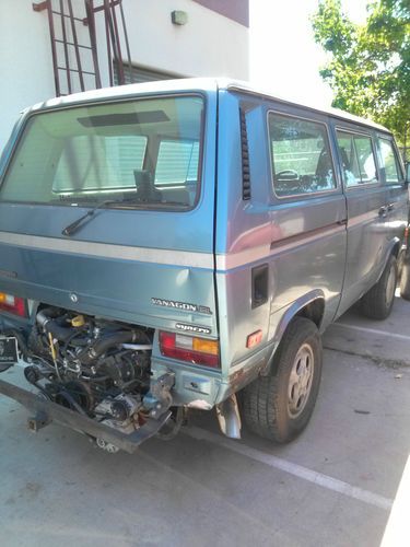

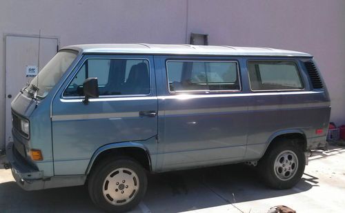

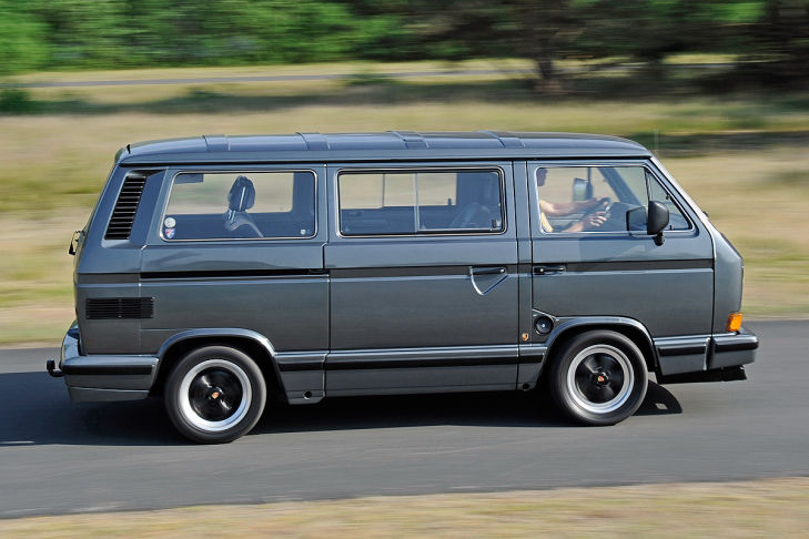

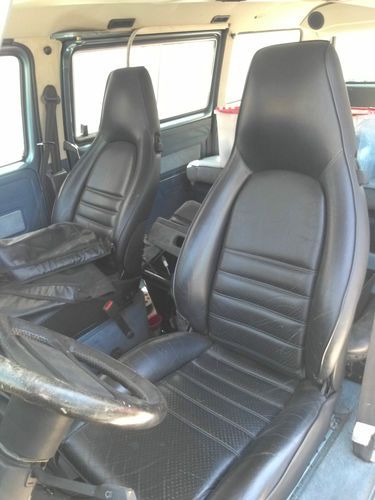

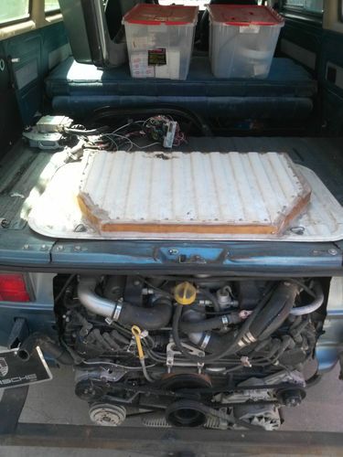

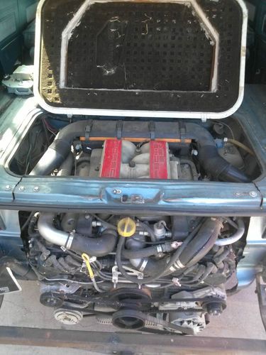

Not a finished project, I don't think, so it's not pretty from the backside, as compared to Porsche's own "B32 Carrera" Vanagons.
http://www.2040-cars.com/Volkswagen/Bus-Va...sche-v8-292757/

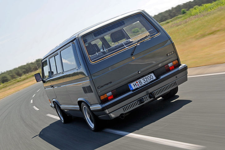

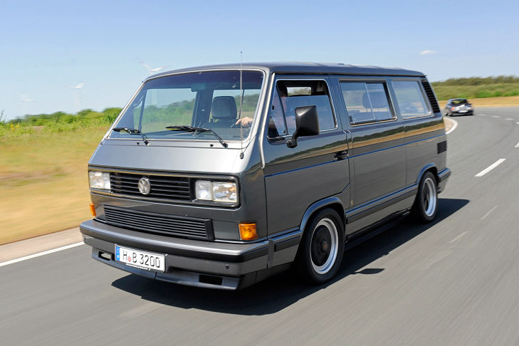

vs. the `85 Porsche B32 Carrera's clean resolution of the design mods -
http://www.carbuildindex.com/24024/porsche...t3-bus-the-b32/

Just because you can...doesn't mean you should. (IMG:style_emoticons/default/shades.gif)
Even worse, they hacked up a Syncro to do it.

There is no way to do that conversion well. The dimensions of that engine means you have to cut the firewall and impinge on the rear seats. Which also means you have no room for the fuel tank. Even at that you still have an engine sitting about 4" off the ground. Senseless.
The proliferation of Subie conversions is a result of horizontally opposed engines designed with a clean sheet instead of obsolete technology hodge-podged together for water cooling. VW had everything right on the Vanagon, except the engine. It's a great box.

Hey Tom, thanks for the link and the pictures, but thats, what I have feared ...
It looks ugly and is a quite bad technical solution (IMG:style_emoticons/default/barf.gif)

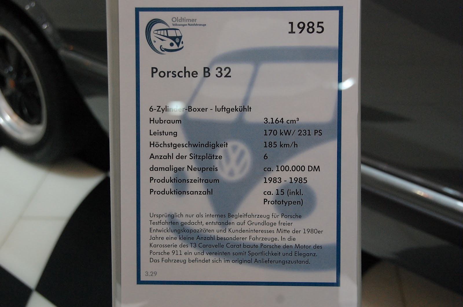

Besides that, I know that particular B32 in the pictures. It has been owned by a private owner for a long time and is now in a museum in Hannover Germany.

Benno,
I saw that one in the Hanover Museum on their website first too, when I was googling for the Oettenger WBX6. I'd love to research & write a rare Porsche article for our PCA Panorama or Excellence magazines sometime when I have time after retirement.

BTW that 928 conversion van looks like a gutted fish. Innards are just spilling out of the open wound (IMG:style_emoticons/default/lol-2.gif) .

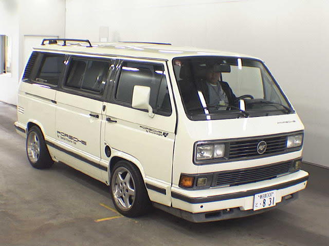

If you do a B32 clone, then I'd suggest that you do an updated clone with a watercooled 2000-10's Boxster/Cayman (896/897/891) or 911 (996/997/991) with a good driveline from an otherwise totaled one - do the IMS Bearing fix if the earlier *86/*87 engines, & you can also do it AWD if you got it from a 4S/4 AWD 911 donor.
That way you'll have a newer WBX which can run cooler, & you'll not have to do all the water to air cooled mods on a later Vano, which involved some complex air ducting for those rear mid-high side ducts & other stuff - most of which would be NLA & hard to reproduce repros.

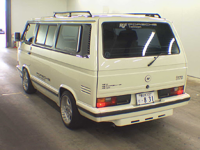

RUF has also done one or some Porsche 6 Vanagons (not sure how many), which also would be "legal" under PCA rules BTW. IIRC this has an aircooled 3.6.
http://www.brick-yard.co.uk/forum/youll-lo...topic46463.html

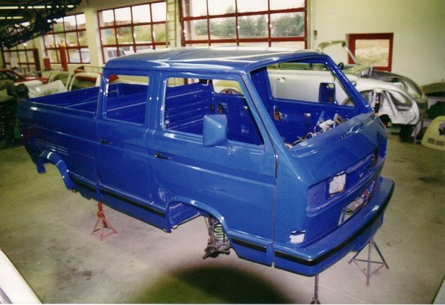

Marty of MSDS Fame? He has done a few of them including a very (IMG:style_emoticons/default/drooley.gif) Vanagon Synro with a 3.2 out back.
And this V8 Double Cab (IMG:style_emoticons/default/drooley.gif)
