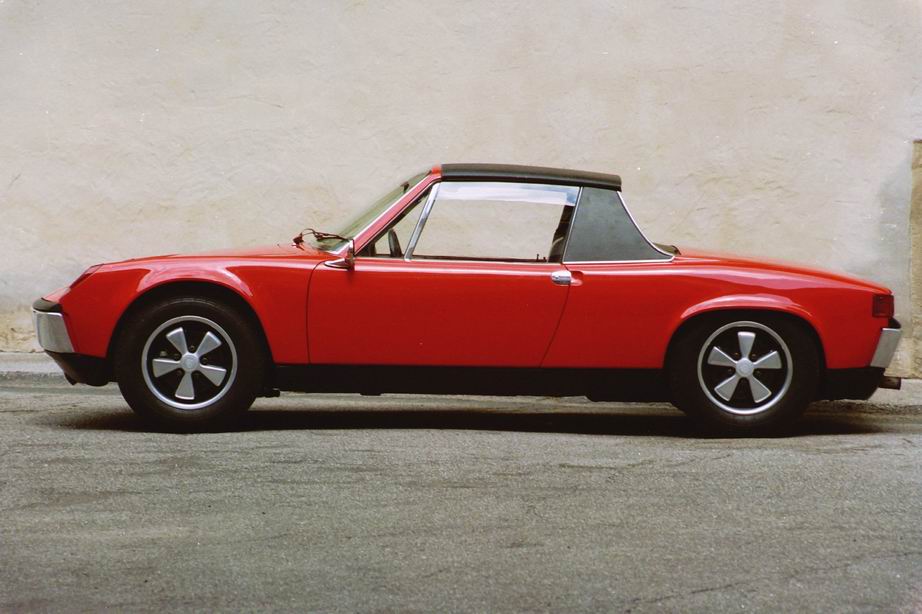

914 F8:
Here are some photos of the 914-8 with the factory908 engine installed tight fit.
Nice car: it has a lot of extra goodies that make it unique.
Headlights are two light per side.
I like the outside fuel filler cap, I did the same thing on my 914, it beats opening the trunk every time for gas.
Also the gear shifter rod runs in front of the passenger seat out towards the door and then runs back to the trans.
If any ones has any more photos that would be great to see them.
Enjoy

ClayPerrine   All of the 908 and 917 engines were double overhea...   Feb 8 2005, 12:18 PM
Carrera916   Lookin at the picture of the front car.... the si...   Feb 8 2005, 12:40 PM
Rand   Quilmes: 1500 lbs???! http://ww...   Feb 8 2005, 01:00 PM
Gustl   the magazine "Motor Klassik 01/1990" states that t...   Feb 8 2005, 01:20 PM
Rand   That sounds a little more realistic. Even 2100lbs ...   Feb 8 2005, 01:29 PM
