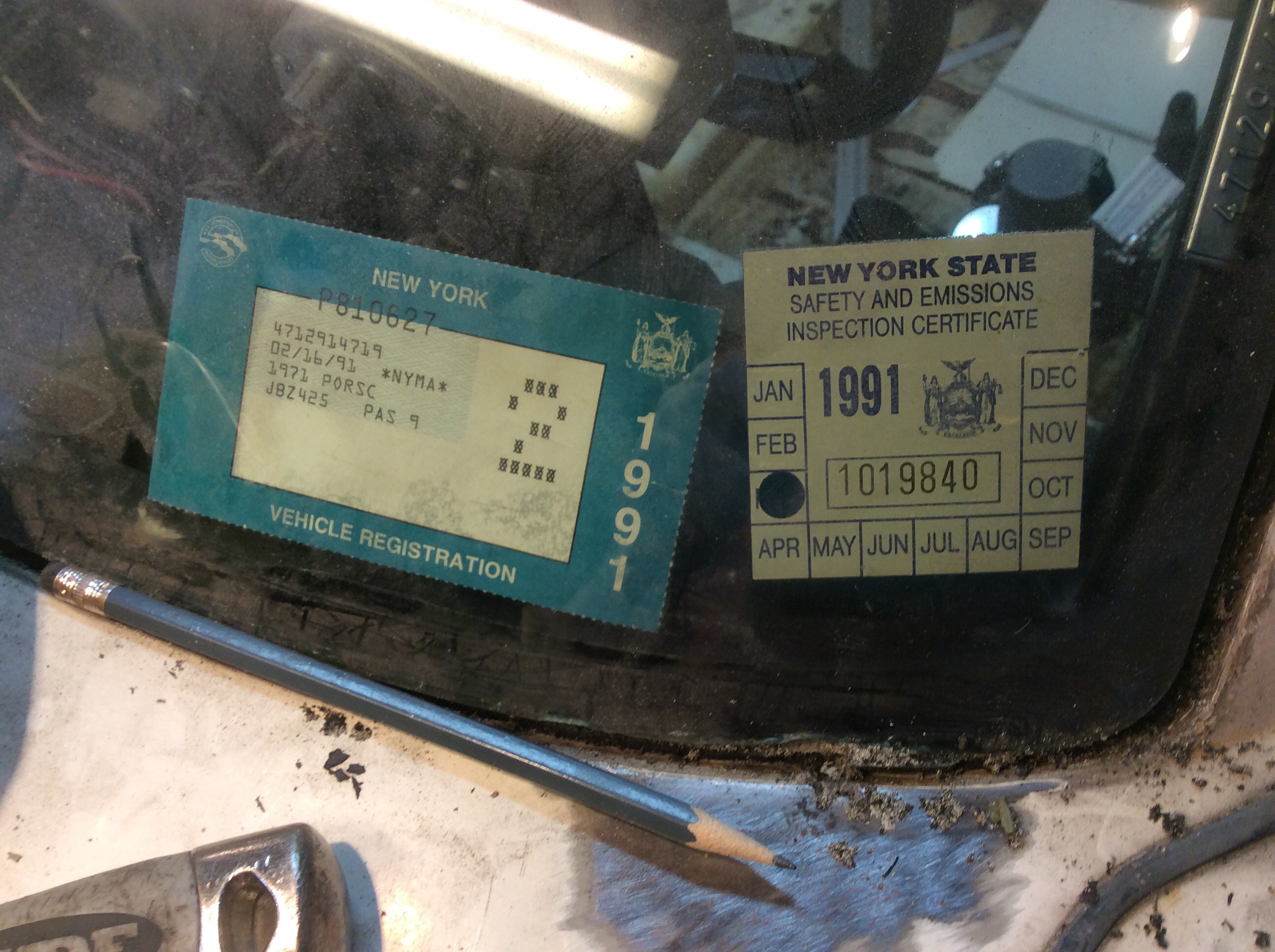

Ok so much has happened since my last post. I went back and forth on which car to upgrade. After talking with my wife and porschef I ended up choosing the white 1971. I didn't take pictures of what it looked like before I started. It will still be ivory as that's it's original color. Here she is with the 1.7 on the garage floor.

AndyB
