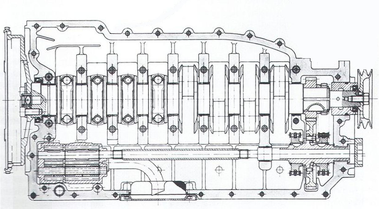

This is drawn as an an interlaced crank.10 main bearings
This is drawn as an inserted crank,1 4cyl crank in the middle,the other split and joined at each end.
This is drawn as 2 4cyl cranks joined end to end 90* apart,the successful orientation.

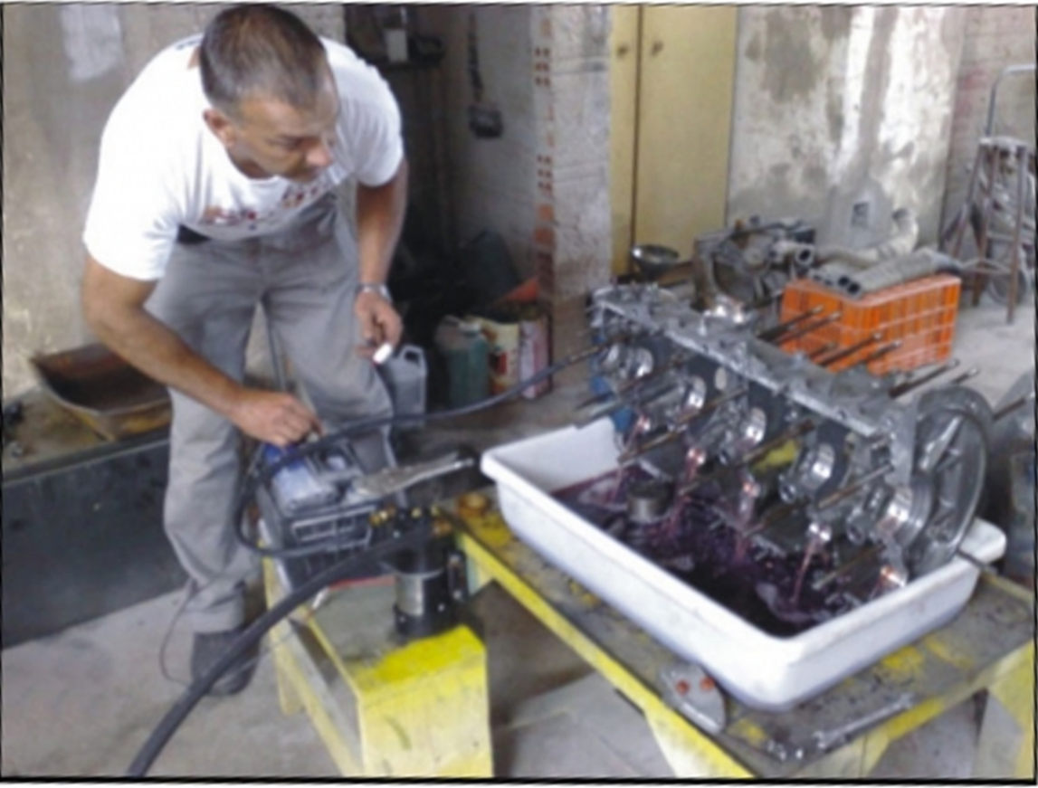

"Excellent, the pressure is great, Today is March 19th, 2009, and tomorrow, we will be recorded for the show,
'Auto Esporte'. Good work Marco, Good work Arlindo"
Marcelo Henrique:

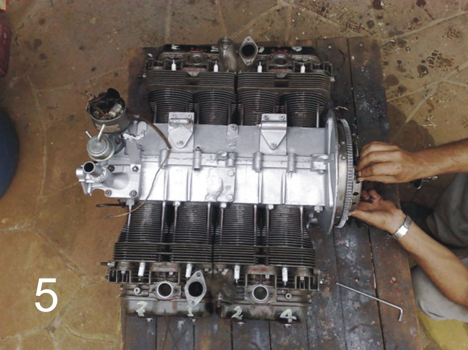

This is a custom flat 8 built in Brazil. The prototype was two VW engines (each 1500cc) built together to form one fire breathing monster known as the the 'Jamaro'.
Have a close look at those parts.Floating wrist pins.Gas or TIG welded heads.
Yes,this is it,the 'Jamaro of Brazil'.
Marco has a battery and pump,checking oil flow(trans fluid).
low-res photo,note cut and shut welds on case.How they dunnit,a few years ago.
Resize the welded crank and rod journals to fit the remachined cases post welding.
Main journals and bearings larger than stock.Means facing and line-boring the cases.
Any tig-man could do this in 2015.Weld a set of cases to 0.005"?Sure.Build a set of jigs and oven weld in steps,checking all the way.

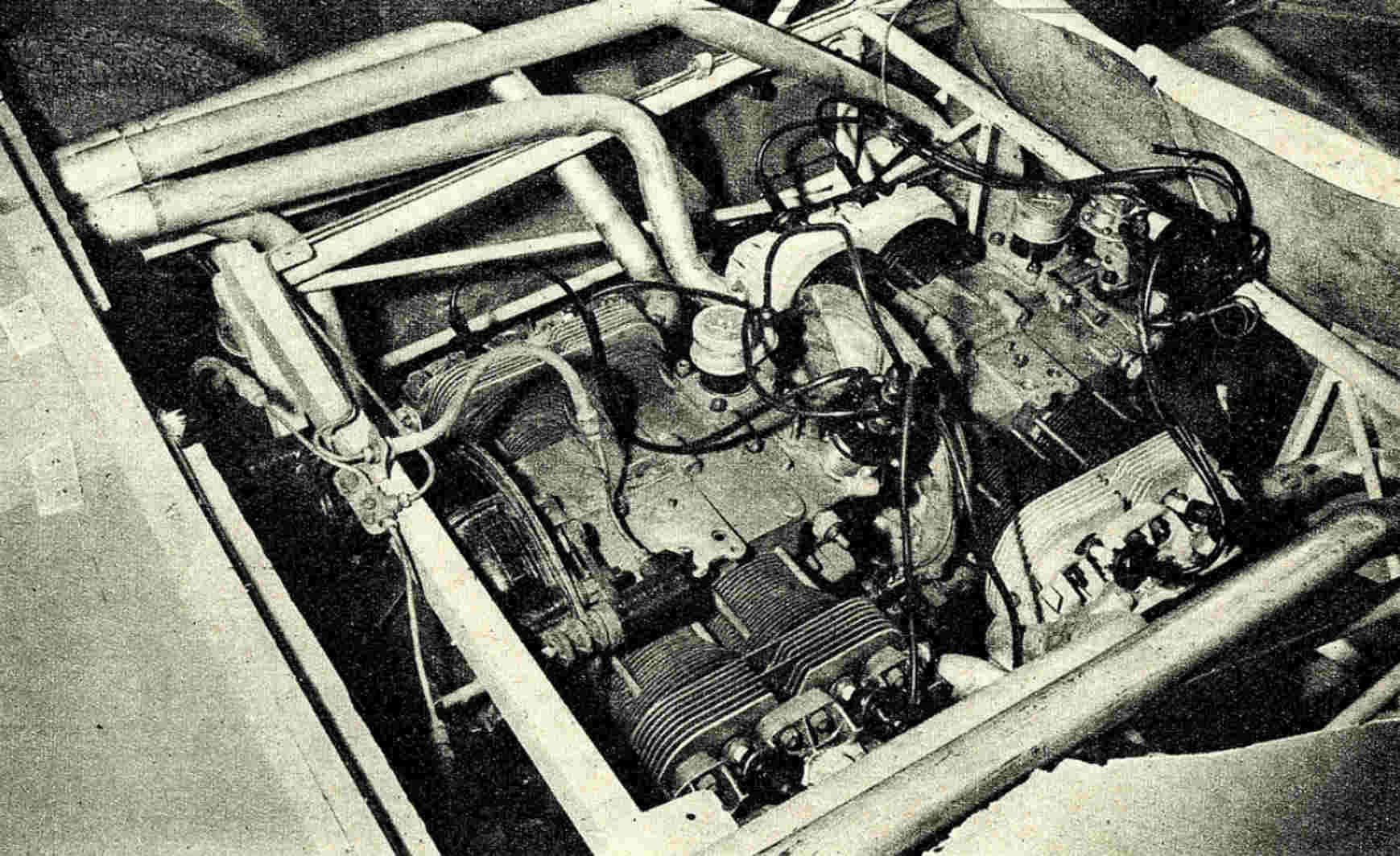

Emerson Fittipaldi's 1970 3.2L mid-engine Beetle.Ganged engine.

X-ray quality welds,like for pressure vessels,it's a 2"bar of steel that's highly stressed by the torsional loads.
The Brazilian said the builder had cast a crank for the engine in malleable iron,a nodular pour was possible then,in Brazil,in '68.
I've done some aluminum castings at home, I built a propane fueled furnace years ago. The added heat of cast iron scares me a little!

The fella's got a neat setup,and is able to stay well away from the heat.
Pouring ferrous calls for different techniques in moulding and attention to the charge's metallurgy.
Iron cranks are just fine for a trial and experimental engine,pretty cheap too.

(1) a crank,2 flat 4s 90* apart
(2) crankcases,T1,T4,Corvair,or custom.(Custom Corvair lost foam casting)
(3) cylinder heads,pushrod or ohc,air or water cooled.(kiss,vvt twincam,pushrod)
(4) Nickies to 8 x 96mm x 76mm =4.4L(Big bore,short stroke and deck height)
yeah,4v pushrod.
a 4 cylinder.
Actually ran.
There is no easier way to build the F8 than the Brazilian's method.kiss.

I found more pictures of the Lind Type IV flat 8 motor and it appears he stuck one into a 914!
Notice "8" on the rear of the car and the rear trunk modified for clearance for the air cleaners.
