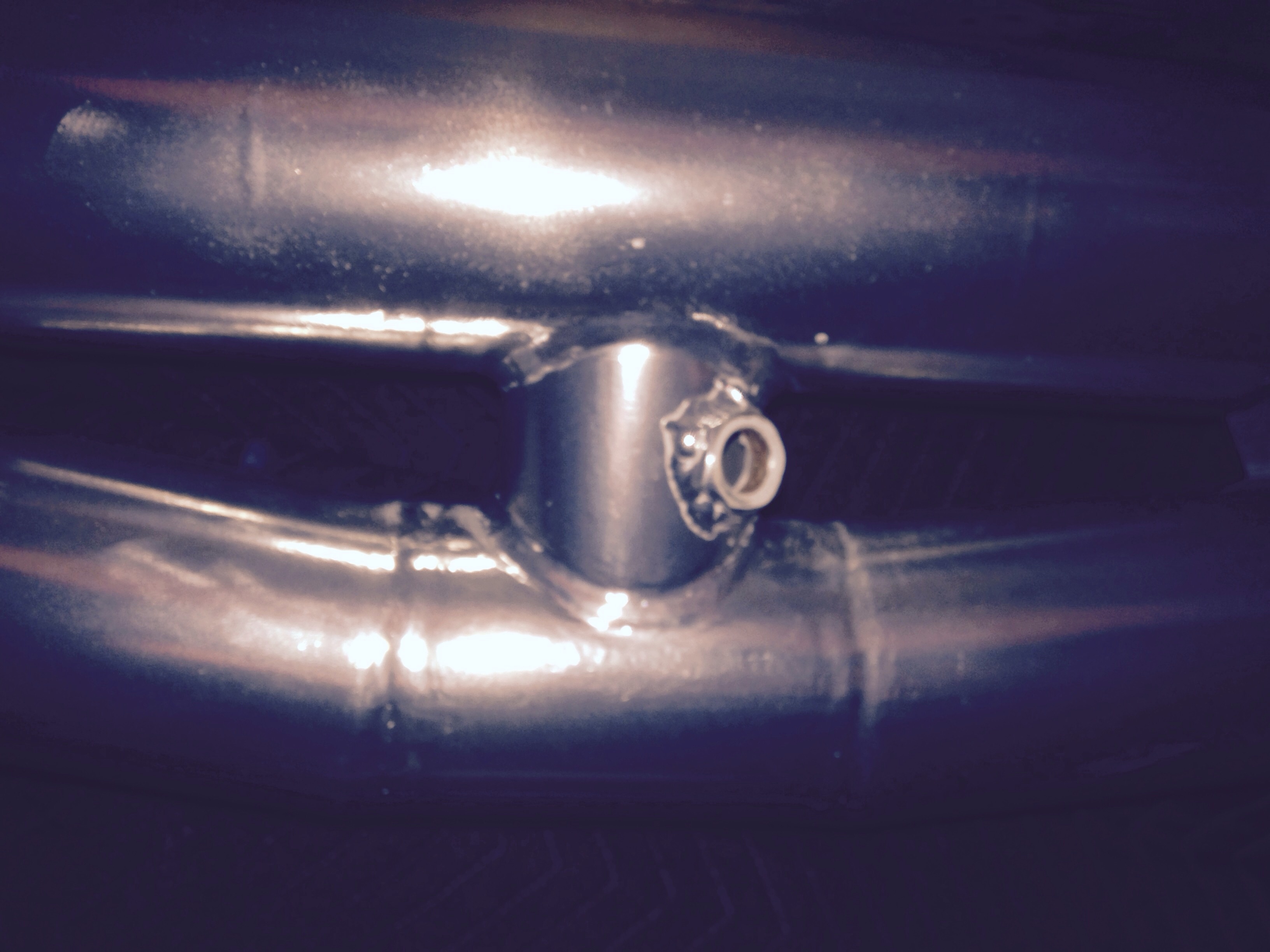

Anyone with a Triad exhaust have a picture of their O2 Sensor installed? I won't be putting the exhaust in for a couple of weeks but have some time to weld in the bung between now and then. Want to make sure I get the location right. TIA.

I do but won't be able to send a picture for a few hours

That is exactly where I had mine welded in.

So slightly off center right in that collector section? I assume it's angled off center as there's otherwise something in the way, right?

that is the only place it can really go due to the baffles in the collectors on each side.
Yes it will hit the transmission if its not off to the side about 45 degrees. Installed mine last year. also ran the cable up thru the center tunnel, i think thru the same opening as my speedo cable, not sure i will ahve to look.

Mine is in the same location. Be warned - its a total bitch to install it if you do so once the muffler is on the car. Doable, but a PITA. Put the O2 in first if you can.

Very good. Thank you, sir, I believe I am all set.

Also good info. Thanks, Zach. Yes, I definitely want to weld in the bung and put the O2 ahead of time.

Rod welded mine same tube but coming straight out the back. I don't have a rear valance so don't know if having a valance would interfere. I'm in FL now but if you'd like to see with O2 sensor installed, drop by and have a look.
