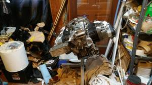

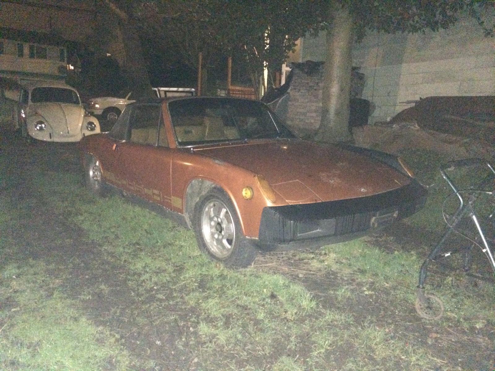

Hello 914 world...I live in seattle , wa and I need help!!!!!!I picked up a 1975 914 and It came with an extra motor..I rebuilt that motor at a shop and I descovered it was already bored to 2400 cc..I threw the stock f I system on it and I have a flame thrower kit on it aswell..it's been cold and Rainey lately and I went outside to start it and all I got was a click from the starter...I need help with any help someone can offer...I'll be willing to pay..thanks for looking
