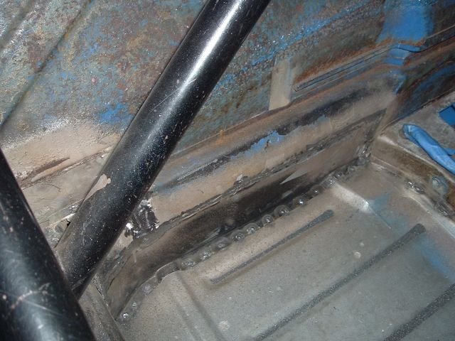

OK, more progress...Top coated the POR-15 with some rattle can blue.
cdmcse
post Mar 4 2005, 01:23 AM
Post #52
Posts: 340
Joined: 17-December 04
From: Georgetown, Ky
Member No.: 3,305
(IMG:http://www.914world.com/bbs2/html/emoticons/smilie_pokal.gif) Yay, the floorpan is in!

Driver's Side.

Passenger Side. Next I have to finish the passenger side Firewall and I'll be ready to paint all the repairs up. (If I ever get the engine shelf from R-D) (IMG:http://www.914world.com/bbs2/html/emoticons/wacko.gif)

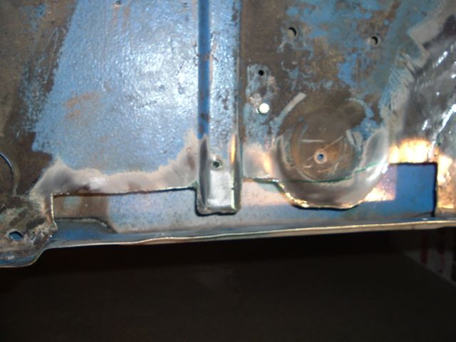

More work done...Inner firewall done.

Cancer removed from the outer firewall...

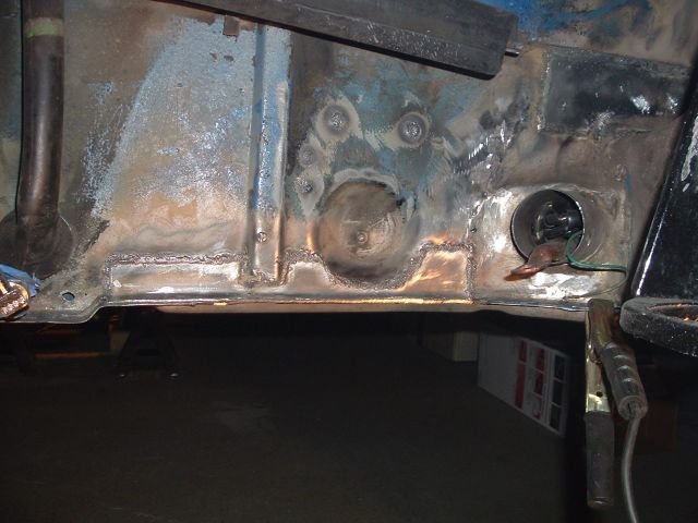

Outer firewall patched...
