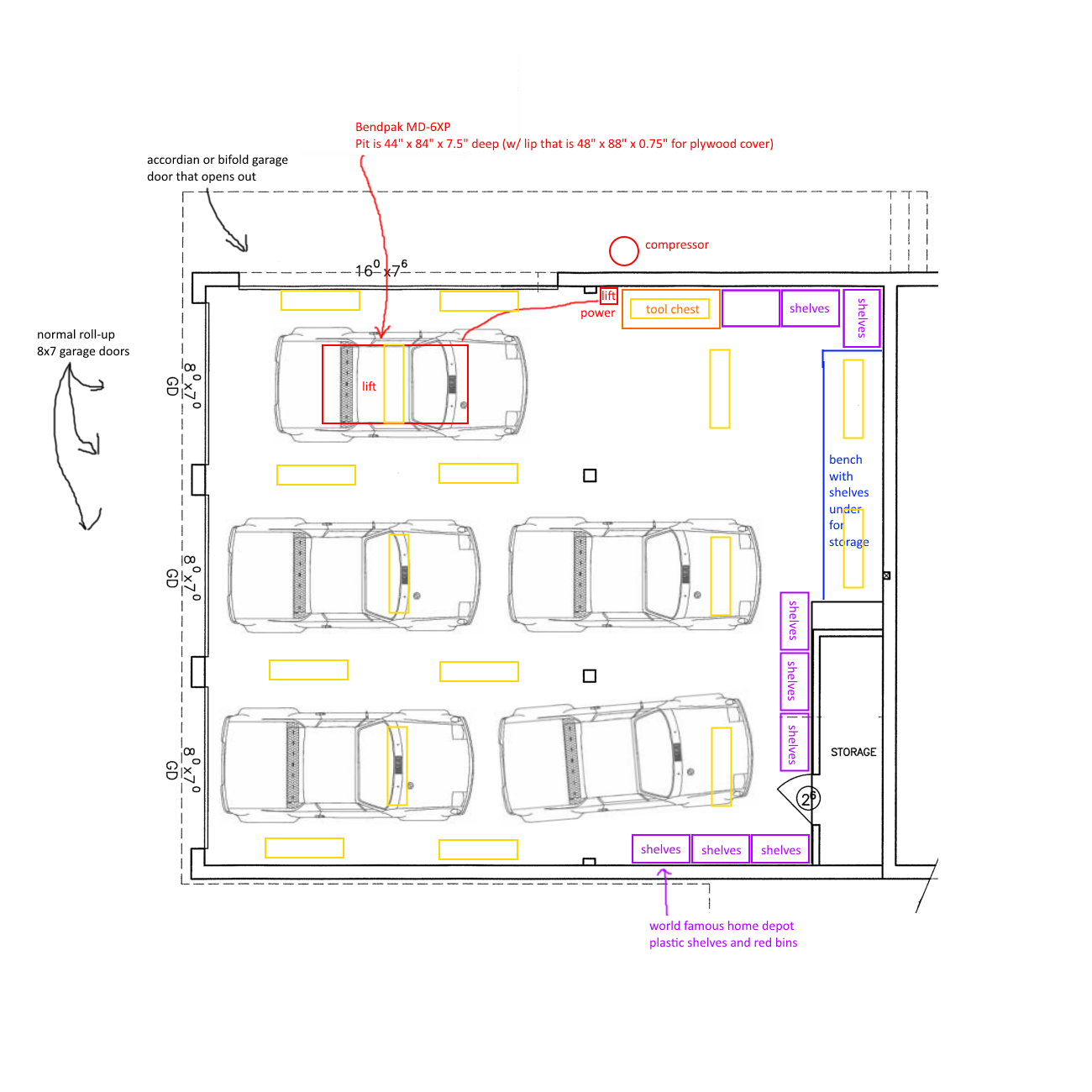

We bought a new house many months ago, and the house needed a ton of work. The "house" part of our remodel is almost over, and now I'm making plans for the garage. I actually can't believe I haven't but more thought into this yet as one of the primary reasons we (or I (IMG:style_emoticons/default/smile.gif) ) liked the house is it has a big 2-car garage AND a big 3-car garage. And a big yard. Yay me.
Without benches or storage, I think 10 914s would actually fit in the 2 garages (tandem).
So... What do you think of my layout plan? Any other ideas below. The most space I've had to work with before this was a 22x20 2-car garage.
1. LIFT - We have to do some concrete work in the garage now anyways, so I think I may put some type of scissor lift in the floor. The ceiling is flat and only about 8.5' or 9.0'.
- Any lift recommendations?
- What needs to be plumbed into the lift? Just power or ? (I'm just starting my research now)
- Do you think the center position is the best for the lift?
2. BENCHES. What do you think? Benches as I drew along the top, or benches in the bottom stall? That closet has to stay there.
Any ideas or inspiration? Thanks!
-Steve

All flared cars? No narrow body 914s? :-) Looks like a great plan. I am jealous. :-)

Install a motion sensor light aimed at the entry way(s). That way if you're going in for just a quick errand you don't have to worry about turning the light on and off and if you leave with your hands full you don't have to futz with the switch.
Plan your lighting so it's around the perimeter of each bay instead of centered. You can't have too much lighting.
Enjoy the space, but remember a basic law of physics......nature abhors a vacuum. (IMG:style_emoticons/default/shades.gif)

I love my snap on mid rise lift
Bought it used for $500
It fits under my car without driving up on any ramps
It's built like a tank
Led lights

Just a thought, but the lift might be better served on the wall with the window. That way, the lift would be easier to connect to power without having wires running across to the center. Plus, if your planning an a/compressor, again hoses wouldn't be all over the place and can be routed along that wall. If you ever needed to paint, the outside wall would be near for a fan and you could drape off that area easier. Plus the extra light helps.
I think I might shorten the bench on the "B" end somewhat to store rolling table there.
What a great setup. Best of luck with it.

Looking great. Our garage is 24' x 36' with a an 8' x 12' bump out for the workshop area.
A few thoughts/questions/suggestions:
- Are you running 220 outlets?
- Are you plumbing a sink?
- 28 ft width is interior or exterior width? Looks like exterior. Fitting three across will work but be a bit tight for a lift on the side, therefore I would go center.
- Shelving, any thoughts for shelves or cabinets?
- Lifts - my neighbor has this one:
http://www.gregsmithequipment.com/Atlas-TD...le-Scissor-Lift
- This one will be going in my garage this spring (friend is an independent mechanic running this one up and down several times a day times 3 years now w/o issues):
http://www.gregsmithequipment.com/Atlas-BP8000
- Lighting? I have 13 twin-bulb 48" fluorescent shop lights on three switch banks so they are zoned. Plenty of light from above, but I'm going to run a few down low along the walls and down the corners - Concur there is never too much light in my opinion.
- Bench area - definitely in my opinion as working with parts on the floor gets old.
- Agree with motion sensor lights outside - love ours, plus from a security standpoint motion sensors make more sense than leaving lights on all the time - light is on, someone is coming or going and grabs attention.
- Storage area - what are the dimensions? Looks narrow.
Good luck, keep us posted - off to a great start.

Do not put the lift in the middle. At one point, you'll want to grind something. With the lift in the middle, you're always too close to the car!
A 2 post car lift is the best solution: e.g. when you want to drop an engine, it's really a one man's job! Again, don't put in the middle.
Position a sink close to the door; that way, you can be 'clean' without crossing the workshop towards the door.
Consider the best layout for your bench & tools: are you left or right handed? Do you have space to position a vice? Do you need a blasting cabinet or a lathe?
Tools: personally, I prefer a trolley with the most common tools next to the car. Other, larger or specialised tools need a prominent place on the wall.
When you restore a car, you need 4x its space: one for the car, two for all the items and one for yourself to work. You can store the parts off course, then you need less room.
In my garage, I've wired the electrics through one main switch: all power, including the lights on the ceiling + radio are centrally controlled. One single flick of the switch and I'm certain that all is safe.
I've mounted curtain rails + runners on the ceiling of the garage. I mounted an extension cord on the runners, that way I can reacht through the complete garage for power.
Invest in proper LED lighting: it has several advantages.
Finally: most of my tools are electrically powered. In hindsight, I would have opted for air powered tools. Lighter, often stronger.

QUOTE(KELTY360 @ Mar 28 2015, 10:58 PM) *
To clarify, the motion sensor light goes inside the shop.
If it's feasible, build a shed off the outside wall for the compressor so you can isolate the noise.

Also, are those posts between the row of cars? If so, ask your builder to run an i-beam and get rid of them if possible.
Too bad your ceiling is too low for a two post, but for a 914 or 911 you can still drop the engine from a scissors lift, and certainly makes suspension work easy.
With a lift on the side, just make sure you will truly have enough room to work between the car and wall. I prefer no less than 4 ft to make room to work with others, but that is me.
Motion light in the interior - not a bad idea, never thought of that.
Also, is that a large garage door on the side? If so, could be handy...
Besides garage doors, any regular doors to get in/out of the garage?
Off to a great start - when's the garage warming party?

No entry door other than the bay doors? The 16x7 notated in the wall on the left is what? Also, what is the compass direction that wall faces? Bear in mind any conflict with overhead door tracks. You might post some photos of the interior.
Greg smith equipment sells a 10' 2 post that might work for you with a couple of smallish holes in the ceiling for the extra post height to slip into.
Looking at the side elevation, the exterior wall of the room above the garage is supported by the posts. Clear spanning the space will involve major engineering and surgery

Hi - thanks for the input!
Yup - I'm my current 2-car (22x20) garage I have a total of 32 4 foot t-8 bulbs. It's like daylight and I love it and plan on duplicating that.
Yup, they were already there. The previous owner was a truck guy.
Unfortunately, no, and adding a drain is cost prohibitive at this point. It is the lowest part of the house and far from other drains or the sewer line.
Where to put the lift is the big question. It is 28 ft interior, and there is probably room to put the lift on the side,
Yes, I think you may be right. I spent a bunch of time their this afternoon and I think I'll move it to the wall. There is still enough room, and the old 2-car garage door will still be there to provide lots of room to open things up.
Yeah it is narrow and not ideal, but would have been difficult to change.

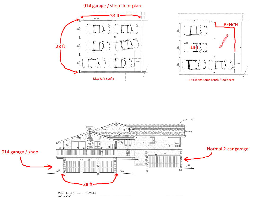

Yup, existing house, and I'm done with major structural work at this point.
I'll post some more pictures of how it looks today later tonight...

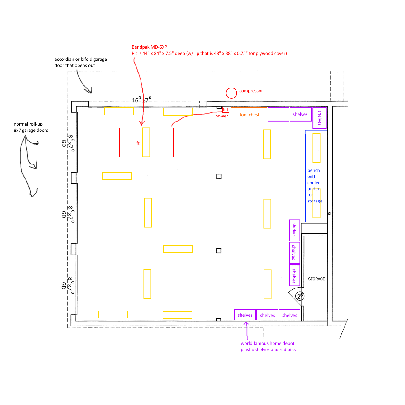

In the interim, here is my last idea based on more input and research.
-Steve

with 914s for scale
-Steve

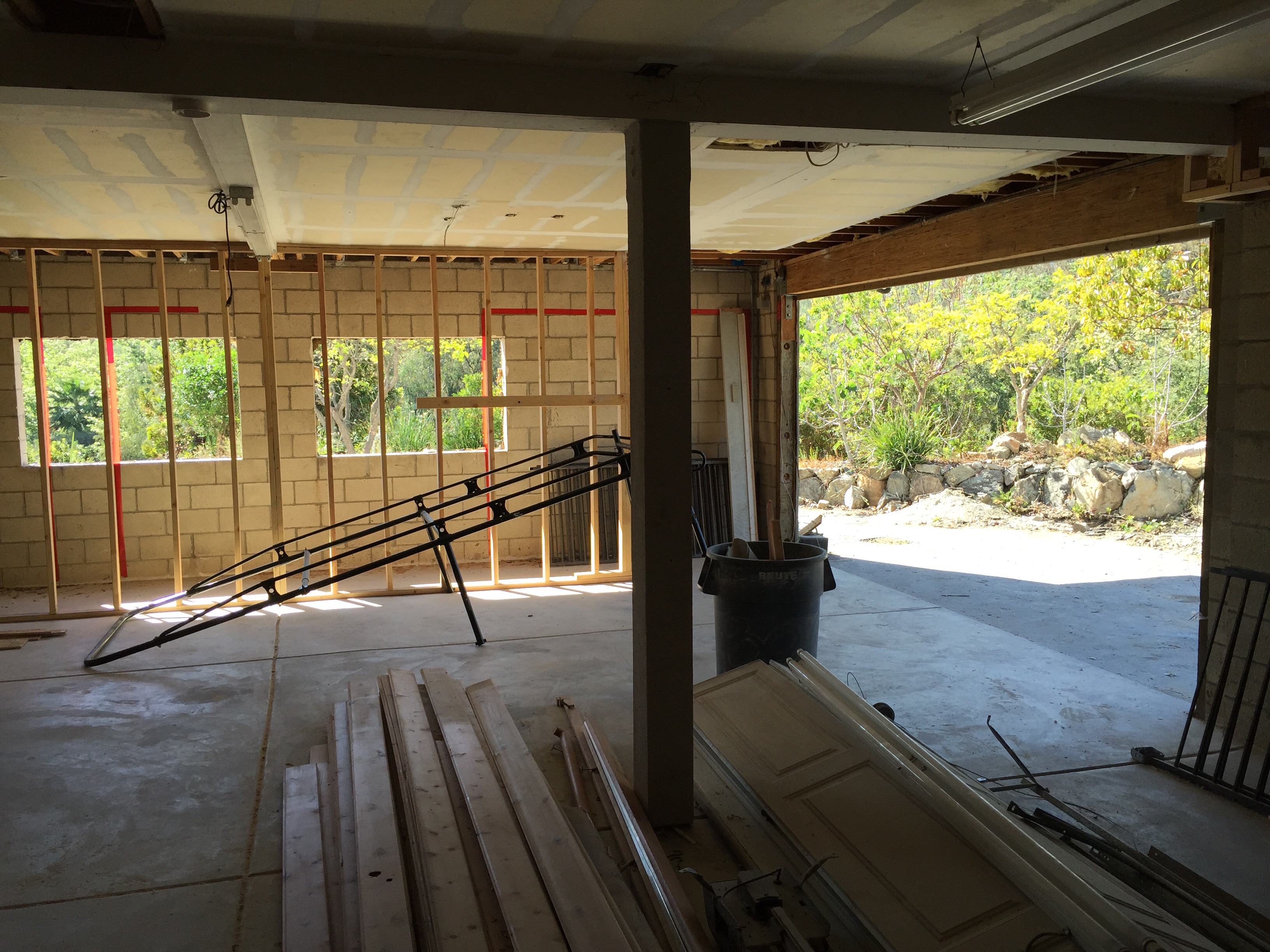

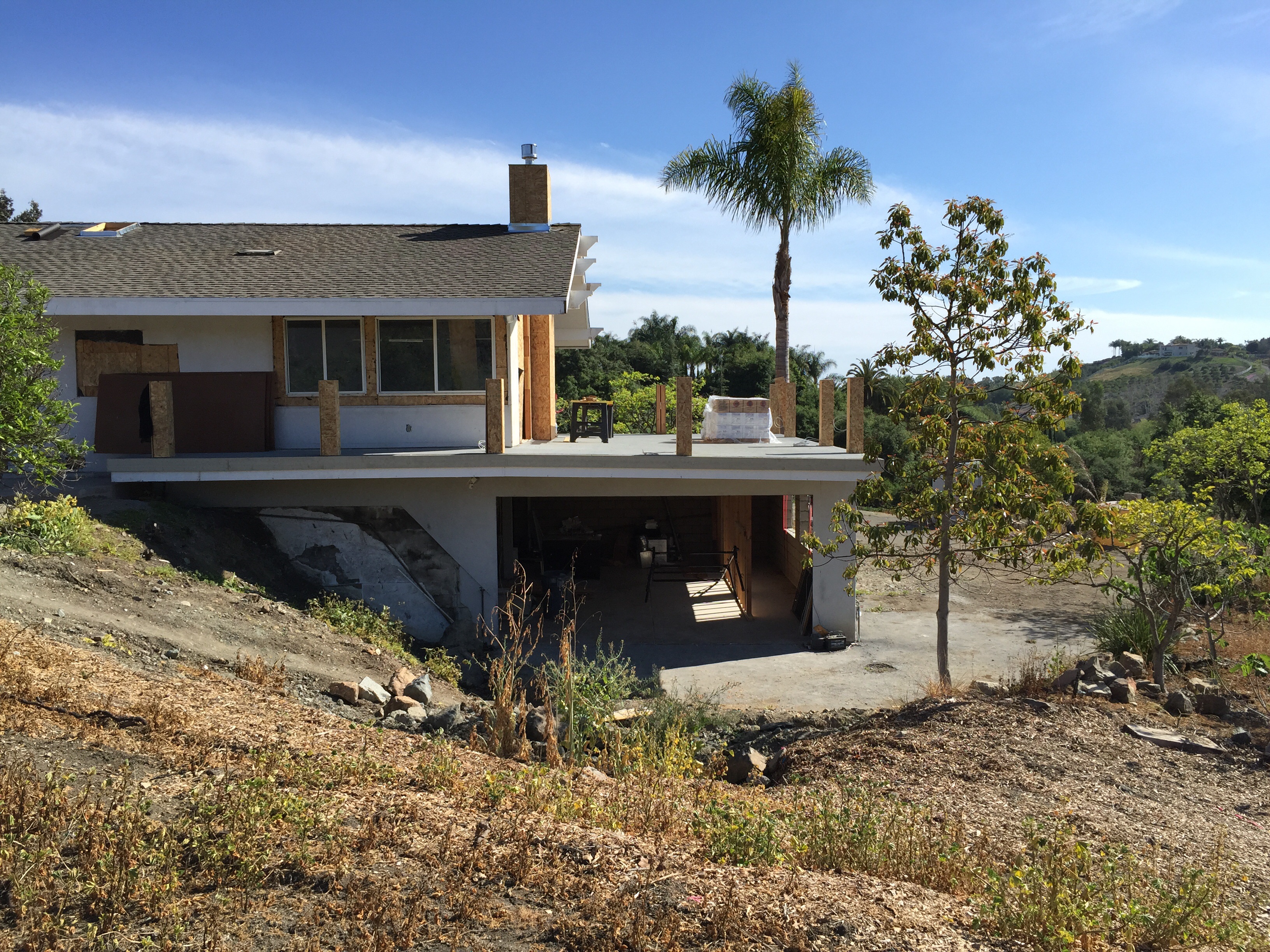

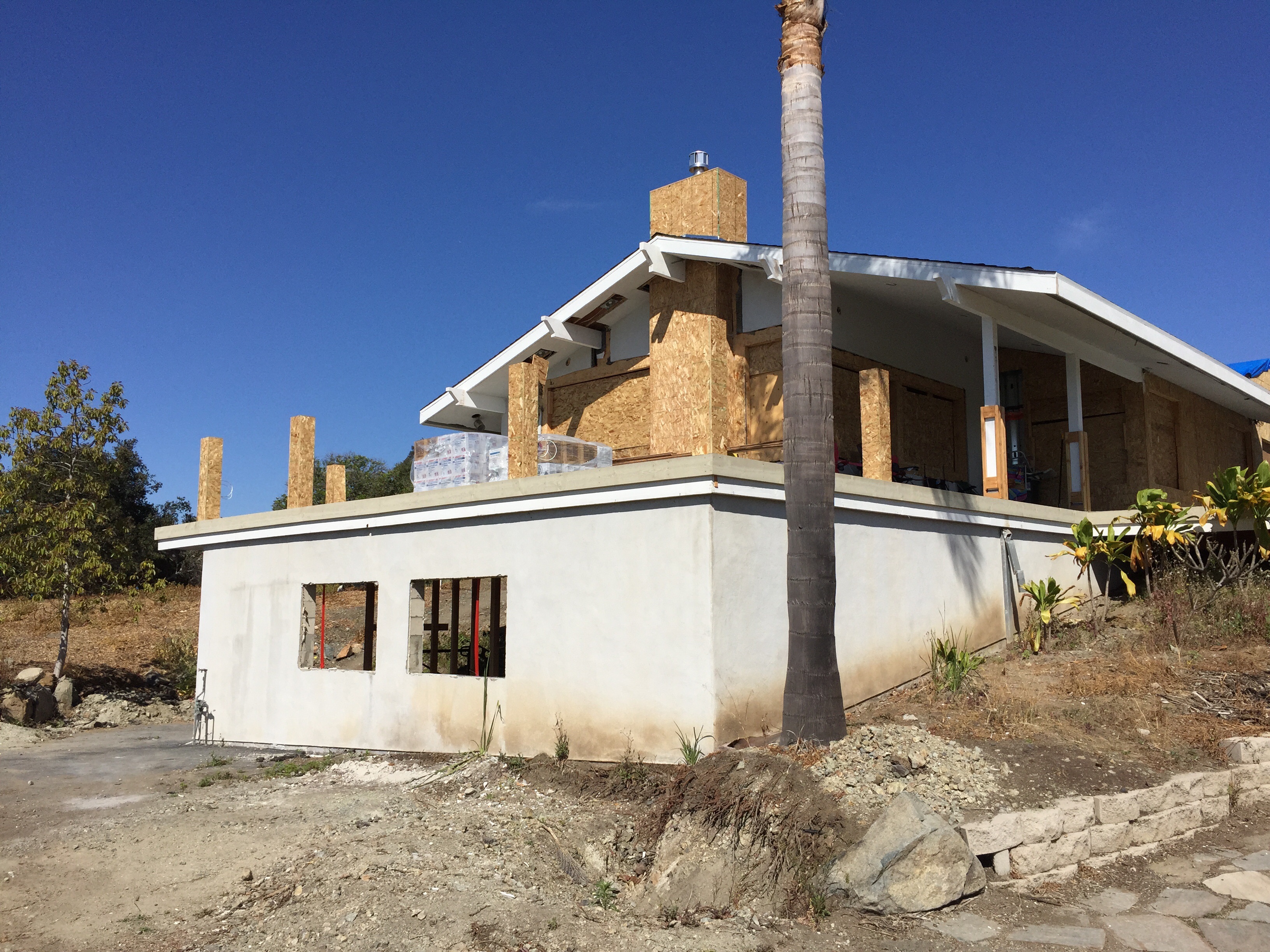

some photos from today. we are adding the 3 single car garage doors. the prev owner used the garage for farm equipment or something, but even then it makes no sense where the original 16 x 7 door is. the 16x7 door driveway turn is too sharp for even a 914.
thise window holes will be the 3 single garage doors.
