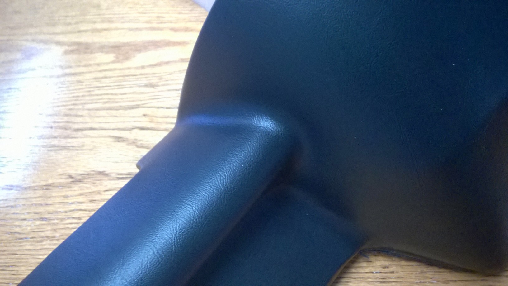

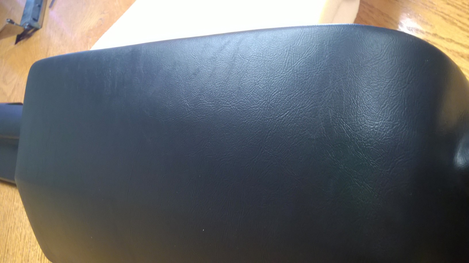

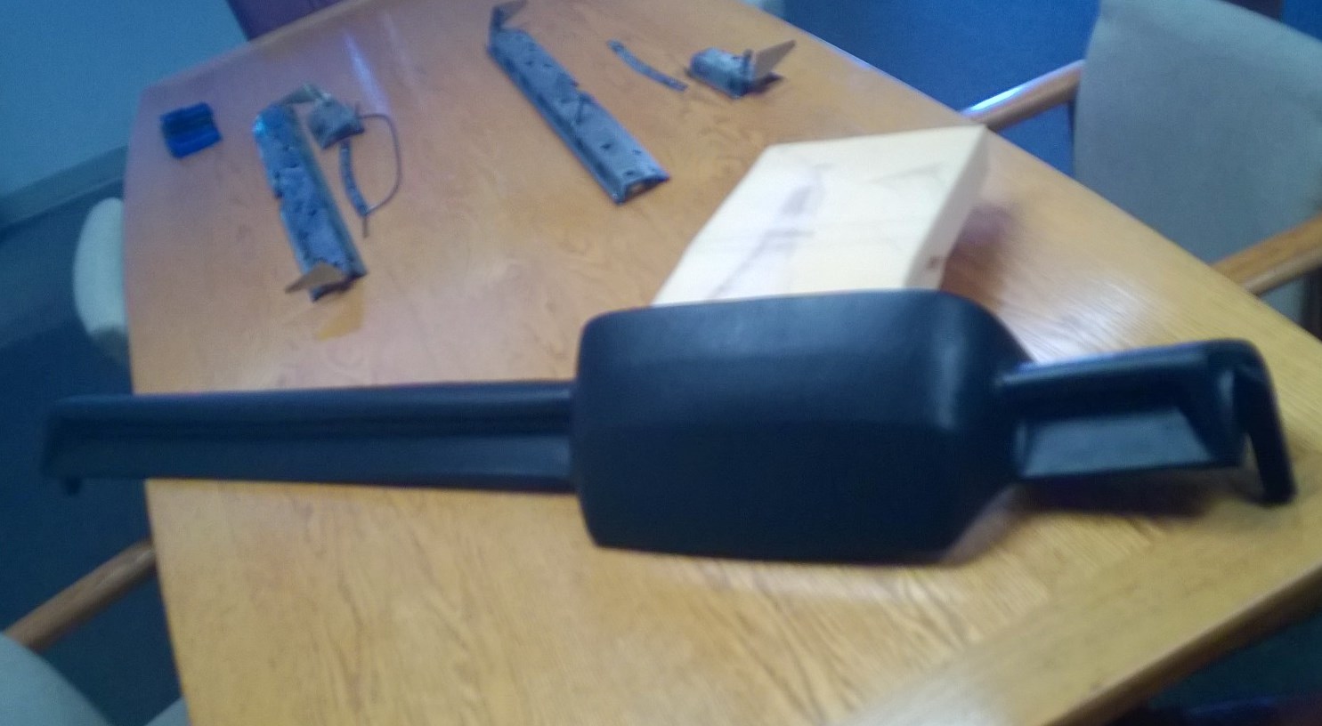

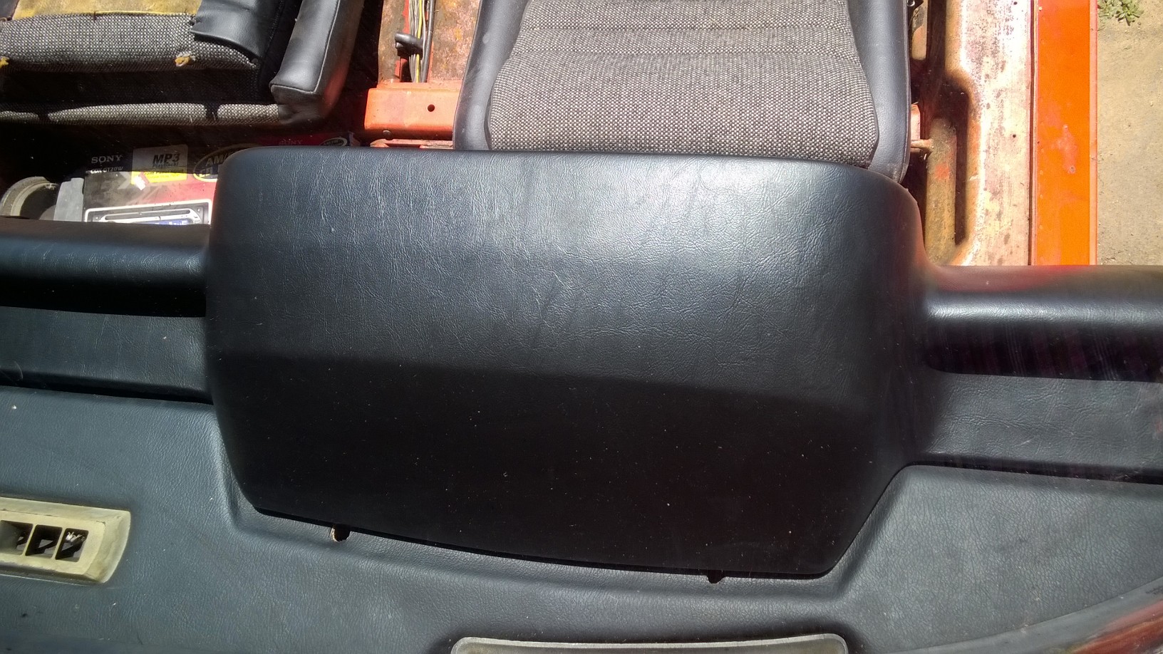

Thanks all, I'm updating the thread to show you what it looks like. I'm VERY happy with the results. We have only got our 1st plug out of the mold, but it's great! This is what we got done today about noon. the dash has no metal in it yet we are just trying to see how it heats and where we need more venting. This is not even fully cured, but I couldn't resist playing with it.

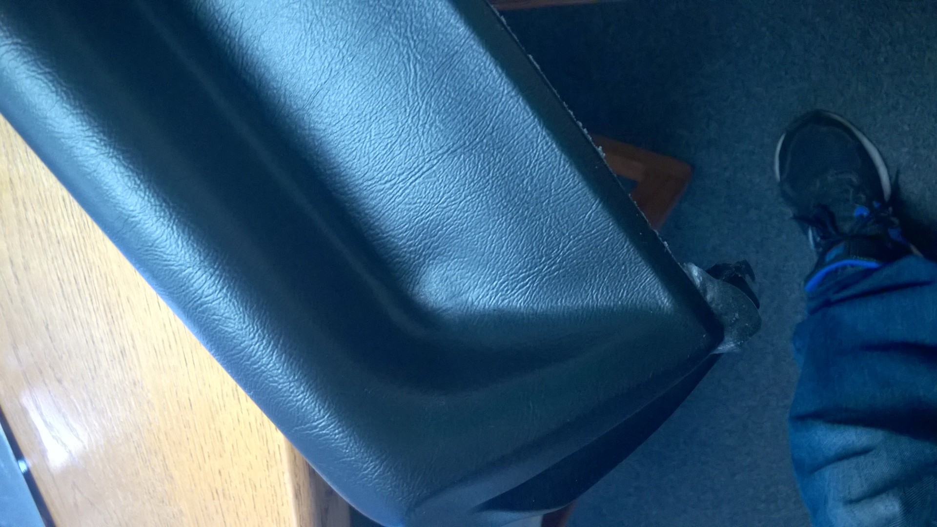

Texture is spot on

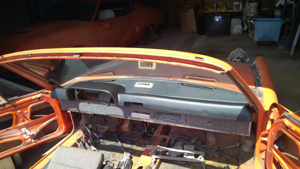

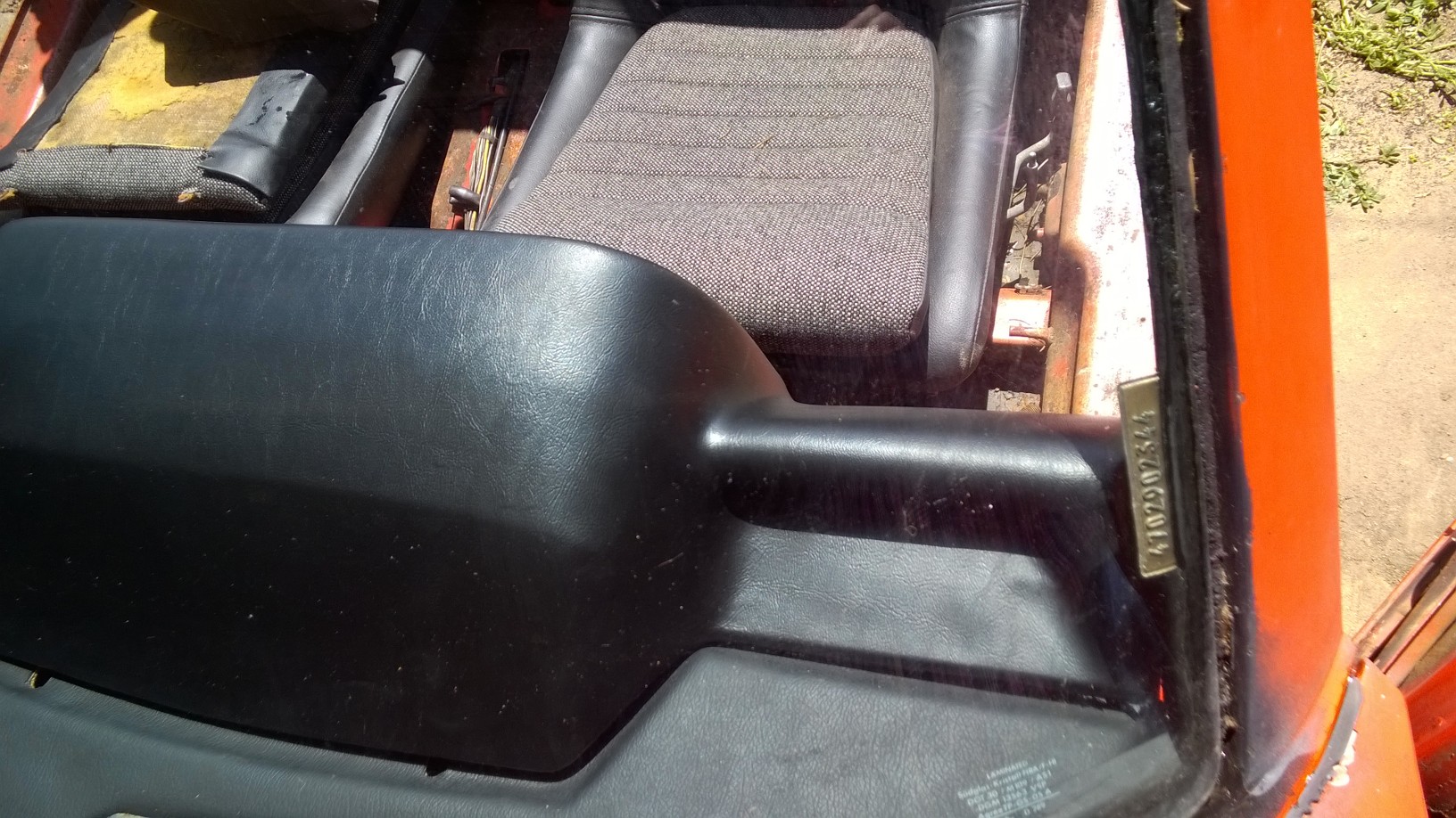

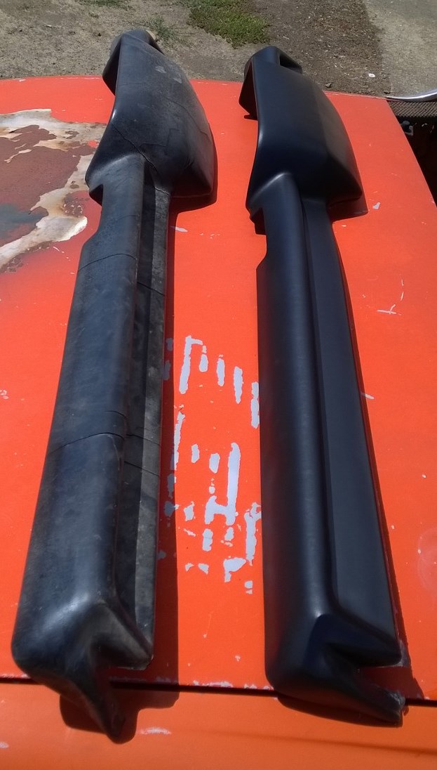

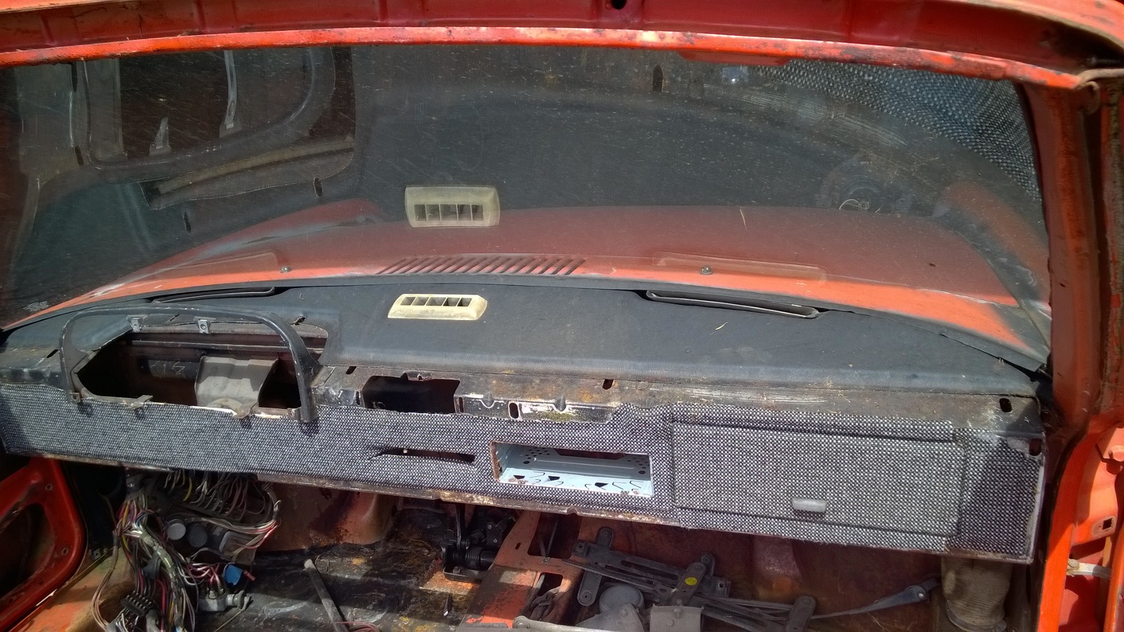

So I ran out to a 70 car to lay it on and see how well it fits.
Anyone want to guess the OEM dash? These look even better in sunlight

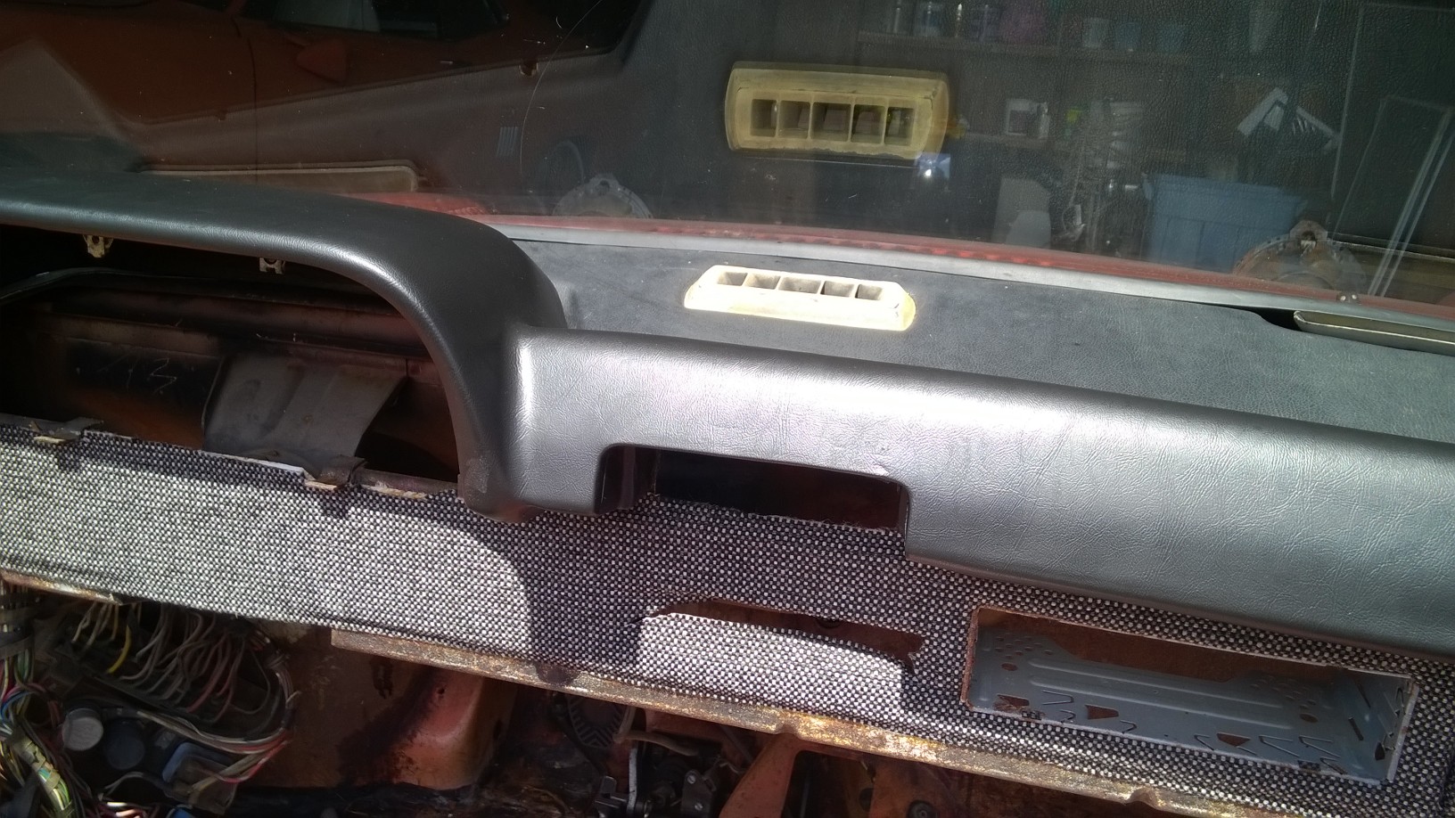

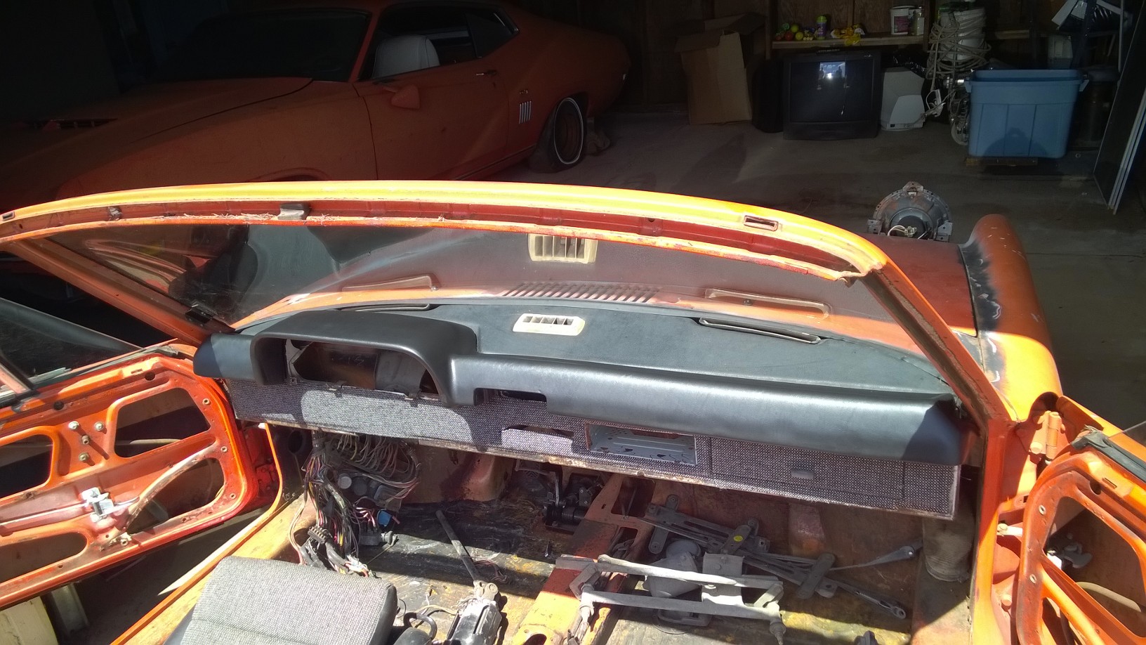

Setting on the dash

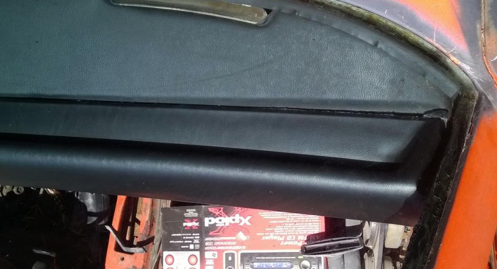

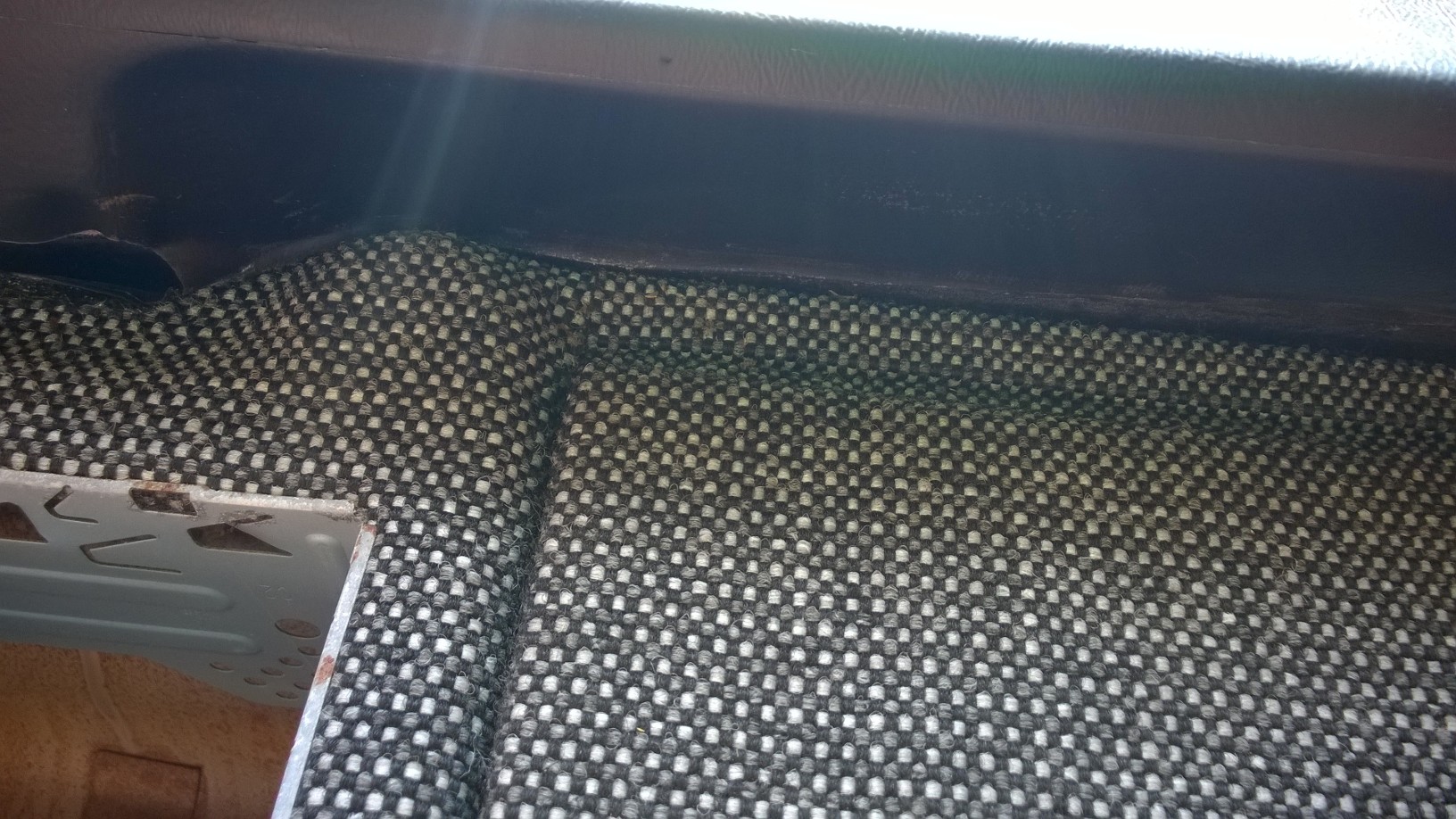

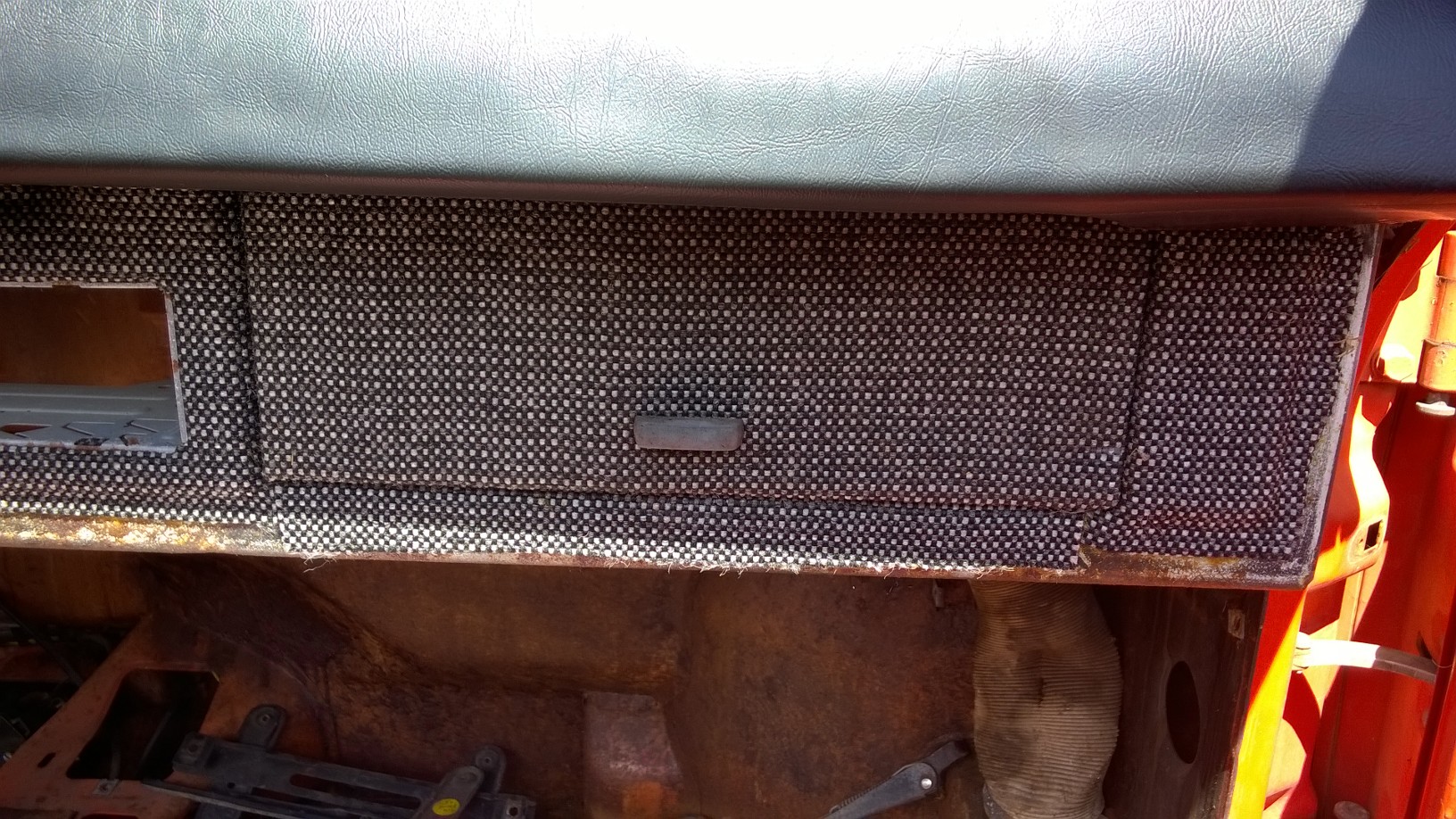

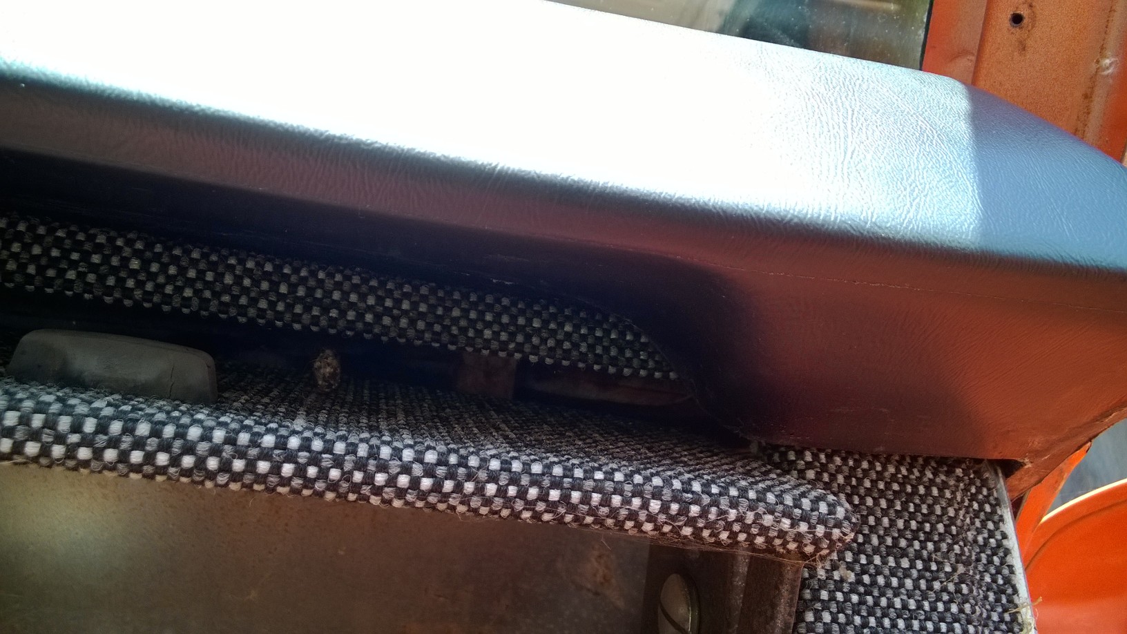

For those interested in the Early vs Late "issue". It's not really noticeable. You can see the pivot point of the glove box makes it so the door opens up almost unrestricted. It may limit travel slightly once it's bolted down, but it may not. I'll have to recheck once the metal is cast in.

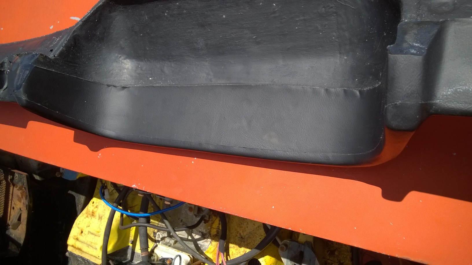

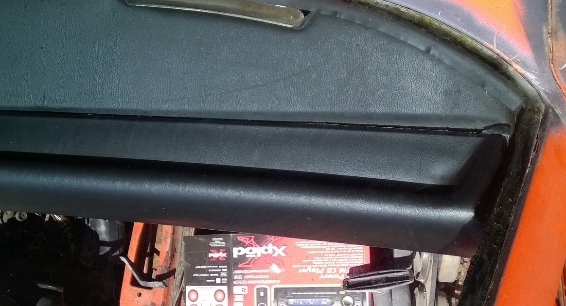

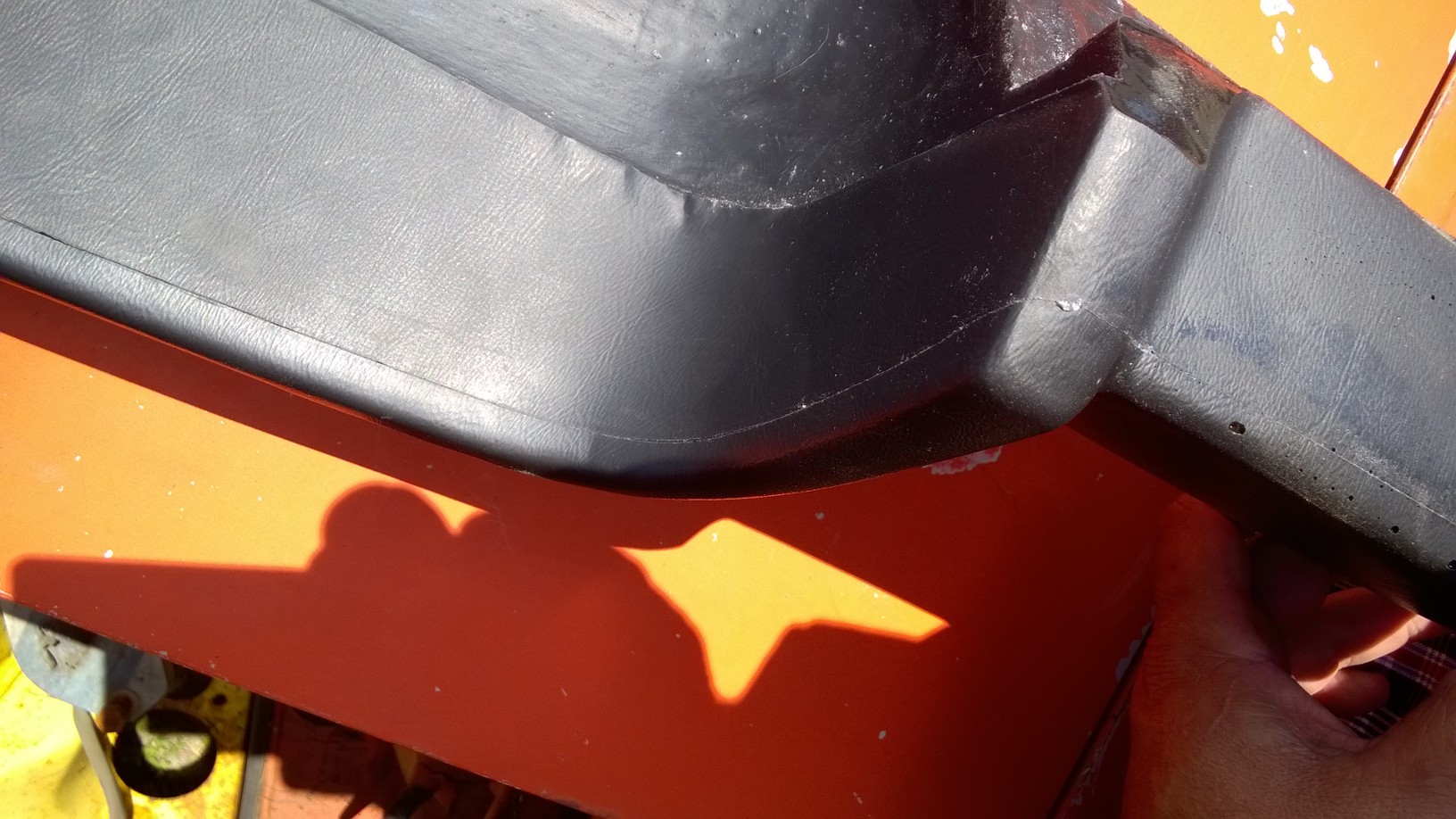

The only area we need to point out that is different than the OEM is the bottom part line. It is hidden under the hood and is not seen while seated. It is there so I need to point it out for all so there are no surprises.
We haven't trimmed this line as there was very little flash on this seam.
The "bubbles" us see on the lower right corner (even though it's on the under side), will not be in the final product. This is part of the process we are working out still. We need to add vent holes and many need to do a few more once we get the 1st one with the metal in it. So we are still tweeking it, but this is the final stages.
