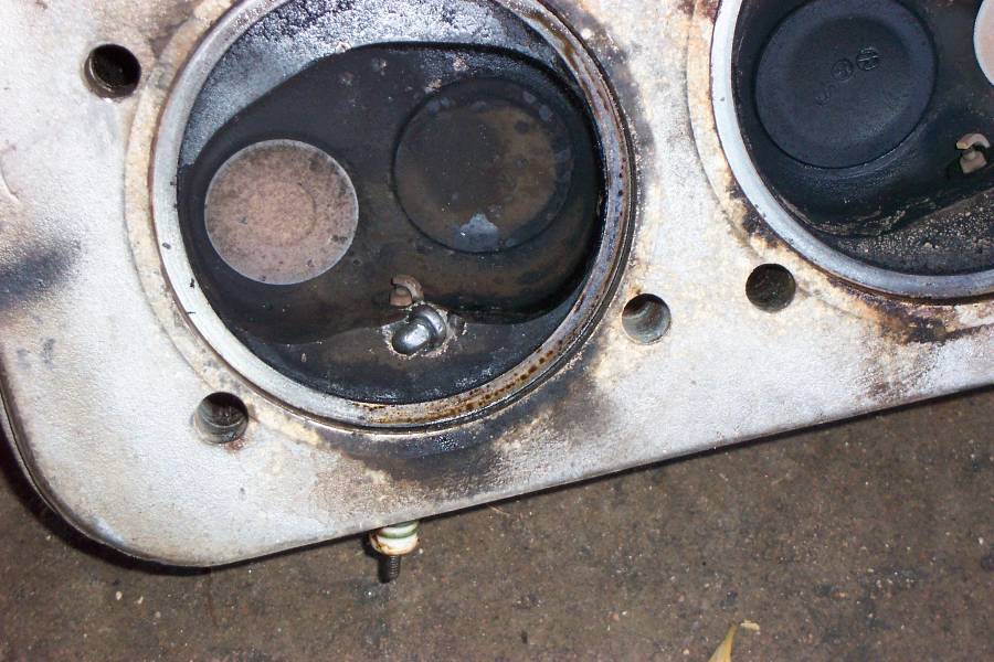

A friend bought a 75 1.8L last summer and has been driving it daily since then. A month ago his motor developed a very loud knock. I said valve seat, but i was wrong. Here's what we found at teardown.

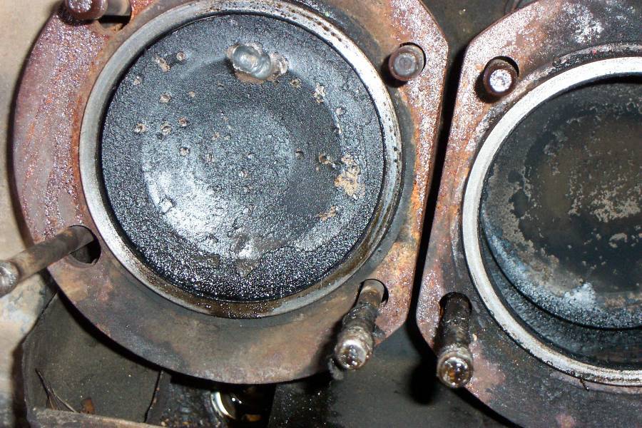

top of piston

the culprit. looks to be an engine tin screw.

It was obviously there for a time, as the plugs had not been out in a quite a while. How in the world did this thing roll around inside the cylinder for six months, and how the hell did it get stuck at the top of the head and not the bottom?

Quick somebody call Robert Stack ! (IMG:http://www.914world.com/bbs2/html/emoticons/laugh.gif) I would guess that the head actually deteriorated at the exact spot that the screw was in and over time fell through the head and into the combustion chamber. (IMG:http://www.914world.com/bbs2/html/emoticons/screwy.gif) After all it is a 914!

I had a 74 Super Beetle that I inherited from my Mother in Law. stock 1.6L Complaint was it ran really poor and was really loud!
So I looked at it and thought it was a bent valve or something. WhenI pulled it aprt found a cheese head screw holding the intake valve open. it was beat up pretty close to that. Probably bounced around on top of the valve for awhile till it finally lined up right to get inbetween the seat. Obviously Type IV's have enough cam lift to let the whole damn thing through.

I figured it was dropped down the spark plug hole the last time the plug was out. You think its possible for a cheesehead to fit through an open valve? Hmm, there was also a 13mm nut laying under a pushrod. Looked like an adjuster nut, but none were missing.

Scott, putting it back together was my first thought also, but the damaged area is only a few mm from the plug hole.

It will be fine if you get all the steel bits out. If you are really concerned you can get a local shop TIG fill the hole in the head grind it smooth. It will last a long time.
