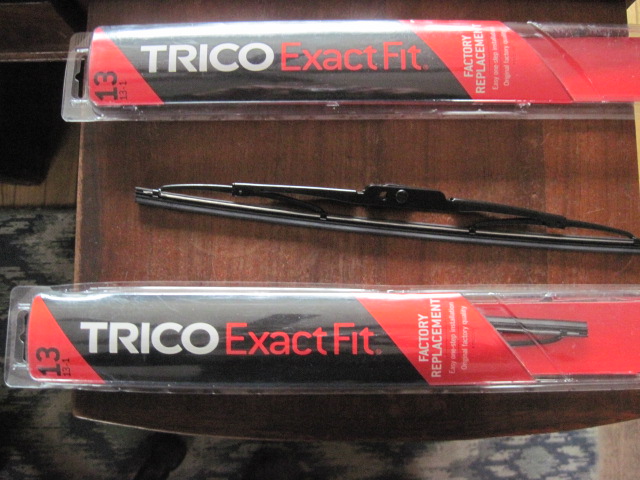

I found these Trico blades. 13" black 7mm arm. The fit perfect and are cheap. I'm not sure how long they last but they are 1/2 the price of the Bosch blades that have 9mm arm fit.
